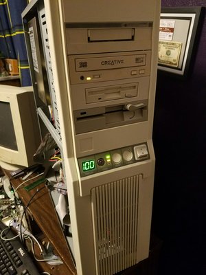

Reply 25 of 41, by BeginnerGuy
Awesome builds! Glad I came across this thread because I've been following that case and a few others through their ebay store, prices + shipping estimates are far lower through that website.
Question: Can you guys tell if this case has a power on/off switch? I can't tell through the cover, or if there is one I guess it's black? If I get one and it doesn't would a switch be expensive / hard to track down / difficult to install?
This one looks more like the case I had my 486 in years ago, with the sliding cover and 4 bays. Plus it'll make me a bit unique since we're all buying the 10 bay one, which is the only other one I like 😎
Reply 26 of 41, by jade_angel
I'll bet that black square on the right is a switch, yeah. If it's not, you should be able to find one easily. You'll need a DPST toggle switch for an AT power supply, an SPST momentary switch for ATX, and an SPST toggle for one of those ATX-AT adapter widgets. You should be able to get those from Radio Shack or the local equivalent (to the extent that they still exist) or from folks like Digikey or probably Amazon, they're a buck or two usually. You'd want a panel-mount switch there. I'm not sure how big that hole is - 20mm would be my first guess but it might be as big as 30.

Reply 27 of 41, by BeginnerGuy
Thanks, this would be for an AT board and supply (advertised as included). If I grab the case and it happens to not be included, can an AT power supply be started easily? I can't remember if the motherboards have to be shorted or if the switch goes straight to the power supply on these. Could you link me to an example of what I would buy?
Sorry to totally derail the thread with this. I just can't tell if that thing has a button! According to the listing:

Reply 28 of 41, by jade_angel
An AT power supply's switch is wired inline, switching mains voltage, so there's no real trick to turning it on. It'd be weird to have an AT power supply but no switch - I'd expect both, or neither, and AFAIK, there were no AT cases with ATX power supplies (though if this is one of those, you can still make it work).
I can't really link the exact switch you need, because I don't know the dimensions of the panel-mount hole. But the key specs are these: DPST (double pole single throw) or DPDT in a pinch; rocker, pushbutton or toggle latching (not momentary); rated for at least 120VAC (in the US/Canada) or 240VAC (Europe), if in doubt go for one rated higher; panel mount for a square hole. You'll have to measure the dimensions.

Reply 30 of 41, by cj_reha
BeginnerGuy wrote:
Awesome builds! Glad I came across this thread because I've been following that case and a few others through their ebay store, […]
I don't think that case comes with a switch, looks like just a hole.
AT power supply switches are pretty cheap, although you might have to do a bit of digging to find some.
Beware also, the full tower cases (at least mine) has a gigantic 10+ pound monster PSU I had to source as standard AT PSU's don't fit and the cables don't reach (Believe me, I tried 🤣 )

Another thing, the displays came from the factory with the turbo off as 20 and turbo on as 158. Through trial and error you can get it to display correct but it takes a lot of patience.
