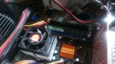

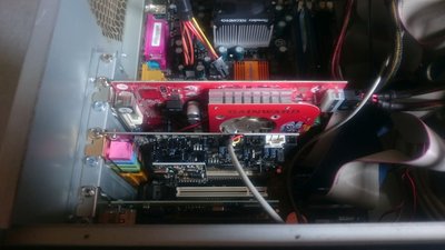

Hello,
i want to introduce my Intel Pentium III-S Build that's for old games that can't run on Windows 10.
Fully offline.
The hardware specifications:
Intel Pentium III-S 1266 Mhz
FSB 133
16 KB L1 Cache
512 KB L2 Cache
Elitegroup P6S5AT with SiS635T Chipset, DDR RAM slots and universal AGP slot. No ISA slot.
512 MB DDR400 RAM by Corsair (Speed at SD-RAM PC133)
Gainward Geforce 6600 GT 128 MB VRAM
Terratec XFire 1024 PCI soundcard with the Dreamblaster X2 board attached.
3com 10/100 PCI Ethernet Card
40 GB Hitachi IDE HDD
DVD-RW IDE Burner
1.44MB Floppy Disk Drive
2x USB 1.1 Ports
Antec Sonata Computer case
Logitech MX518 mouse with USB to PS2 adapter
Logitech PS2 keyboard
17" Scott 7A730T9 CRT Monitor

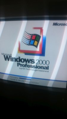

with Windows 2000 SP4.
3DMark99Max benchmark result:
file.php?id=32800
