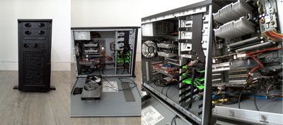

I have added some old pictures to the post. You can see a few details there:
-I could only run 1GB of RAM at the moment because the retention bracket from the Arctic Cooling VGA Silencer would hit the lower stick. I had to trim the plastic from the bracket to be able to install RAM again, and even then its a tight fit;
-I printed a few parts! The funky green ssd caddies, a couple of 92 to 120 fan adapters, and for the top fan a "turbine" that cools down those sweet CuMines. All parts I found online for free;
-The mess of cables at the bottom are the front panel usb2 coming into the usb card, front panel audio and firewire coming into the audigy2. For the front panel audio I ordered an ebay adaper, works ok so far but I had to move some cables around according to this post

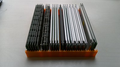

I am actually sitting on a lot of rdram at the moment: ~3.5 GB of it.
The attachment rdram.jpg is no longer available
The bulk of it has timing of 40ns and it makes the machine unstable, switching to 800-45ns made everything rock solid. That lone black stick you see there is actually a 512MB stick with the proper frequency timings I need, but I need its partner to hook it up in the machine. Still looking for it or for another suitable pair.

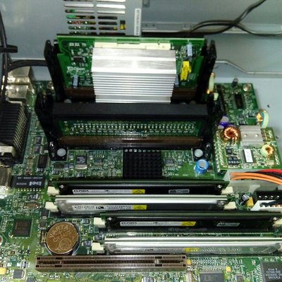

Now the interesting part: I ordered a couple of AOpen slotkets from a local retailer. I found a "Tualatin Success Story" at The Lunchbox which used this slotket, so I basically copied it to start: insulate 3 pins, bridge 2 pairs of pins, done. Mind you, I had read a lot first and knew what was going on. I am documenting the process in an old blog I had, if anyone is interested in reading, you can find it here. I also bought 2 new in box Tualerons 1000—I don't have hopes for SMP Tualerons, I just didn't have heatsinks since I recently moved, and the Tualerons were €5 each, including heatsink—which will allow me to test any mod I do to the slotket;
The attachment aopenSlotket.jpg is no longer available

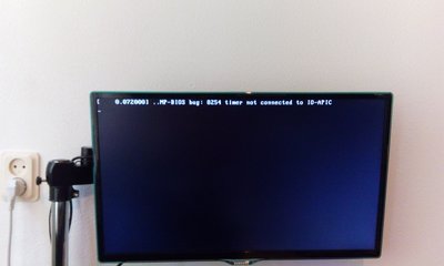

That is a single Tualeron, with a terminator card on the other slot. I fired up the machine and it posted, which was awesome. The BIOS does not recognize the CPU or its correct speed, though. I tried booting Windows 2000, unfortunately its a no go. The system hangs in the loading screen. I was puzzled, so I grabbed a Xubuntu LiveCD and popped it in. Trying to load Xubuntu produced the message "MP-BIOS bug: 8254 timer not connected to IO-APIC"
The attachment ioapicLinux.jpg is no longer available
I rebooted and in the options menu when loading Xubuntu I selected the option "noapic", the machine booted up fine and went into the desktop. Here you can see the cpu info;

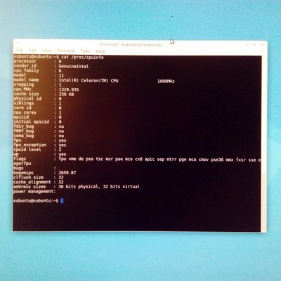

The attachment aopenLinux.jpg is no longer available
Note that the CPU is already overclocked 😉 It turns out this AOpen slotket has an undocumented jumper, JP6, which is usually connected to BSEL1 on both the socket and the slot. Removing this jumper forces 133 MHz fsb and voilá, Tualeron 1333 😉
I also tried an asymmetric configuration: the Tualeron with a Cumine 1000EB. Still same error, but when booting into linux with the noapic option I realized only the Tualeron was recognized, not the CuMine. I'll have to look around the datasheet a bit more to figure out what's going on, but if any of you have ideas, I'm would like to hear them.

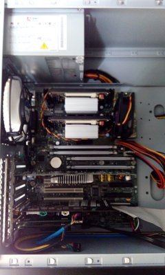

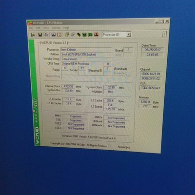

A quickie before sleeping: after studying the slotket in some detail I changed a few things to try añd make it boot into Windows. Long story short, I installed an extra voltage clamp and rerouted signals used for APIC (PICD0, PICD1, LINT0, LINT1, and a few others while I was at it). It took a while because I read a lot, and well, installation was a little involved. The effort paid off, though;
The attachment tualeron1333.jpg is no longer available
Good old WCPUID—this one's for you, H.Oda!! I'll post a lengthier explanation later if someone wants to read up a bit, but probably until the weekend. I still need to work a few(lot of) kinks.

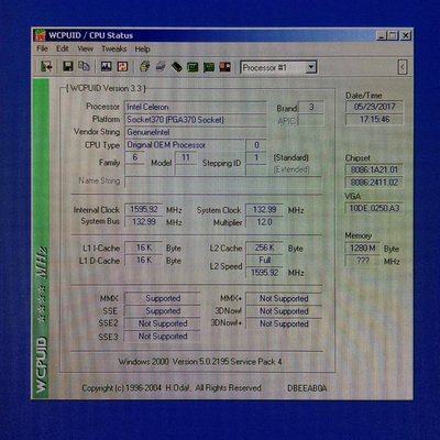

You think that Celeron is having a rough day? Check this absolute champion;
The attachment tualeron1600.jpg is no longer available
If someone wants to read a bit, I finally got around to updating the blog. I blame the abnormally good weather this weekend for my tardiness. In a nutshell, I modded one of the AOpen slotkets to be able to boot Windows 2000. Its not a conceptually difficult mod, but it took some time to install properly and the result is not very physically sturdy. I will pull the plug on using these slotkets for the dual Tualatin attempt and order a couple of MSI slotkets from ebay to play with.

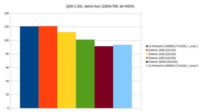

In the meantime, I fulfilled one of my wishes for this build: find a couple of good overclockers to play with. I have the original Tualeron 1000A and a Tualeron 1200 to play with, and ran some benchmarks
The attachment bms.jpg is no longer available
Fun times overall!

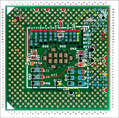

  3. if someone is interested in the korean sold Tualatins and how the adapter works, I sort of mapped out the image available in the ebay listing;
    The attachment upeb_20170522_koreanAdapter.jpg is no longer available
    Since I don't have one I can't confirm the vias go to the pins I listed, but it seems kind of obvious. If anyone has one of these CPUs and a multimeter, and feels like wasting some time, (s)he may check them and hopefully report back here. It is very interesting that the adapter doesnt do a whole lot: a couple of pins are removed from the CPU, a lot of pins are bridged, and 3 resistors are added to pull up to VTT. Anyways, maybe it'll be helpful or interesting to someone.

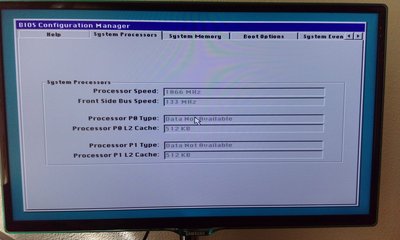

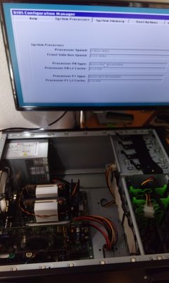

  4. I ordered a set of dual 1133 P3-S that was for sale on ebay. They were cheap and allow me to conduct dual Tualatin experiments, which is the whole purpose of this post…
I have had some moderate success with the mods I did on the slotkets, and have gotten the machine to boot recognizing 2 unknown CPUs. Unfortunately booting up Windows is a no go, even booting up linux is impossible—I got a nice kernel panic when I tried. Given the amount of work I have to do for real life, this will probably have to wait, but I wanted to make this small update before too long goes on without one.

I am not sure its a BIOS issue. The computer is already booting up and detecting both CPUs at POST. I think it doesn't matter that they are set up as Unknown, once the machine posts I can have the OS load the uCodes when its starting up—Linux does this and I am getting a kernel panic when booting, so I think it's still a hardware problem.
From next weekend (July 1st) on I'll have more free time to play with this again, I'll be sure to keep you updated!
