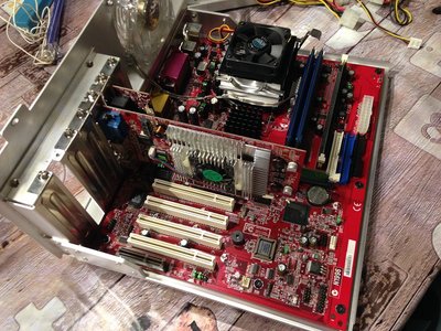

So you may have seen my other system thread; "P4 Rambus system", about a first gen P4 S423 at 1.4Ghz on a P4T with a Rage6 Radeon. That machine is all about nostalgia as it carries some parts I always wanted when I was still a kid and some parts I actually owned back then.
But I could do with some more *bling* 😎
Soooo I scored a neat Gen2 setup and added some flavors 😁
The case is again an oldskool all aluminium Cooler Master, this time the magnificent Wave Master in the limited NVidia edition spec. You might remember this one from: an older spec thread "Mean Green", but I cancelled that one (mainly because of the death of my beloved Canopus GF3)

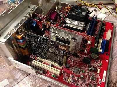

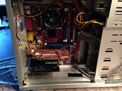

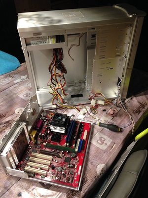

Inside the GEN2:
* MSI 850 Pro5 board, S478
* 2x 256MB Blue rimms
* A P4 1.9Ghz

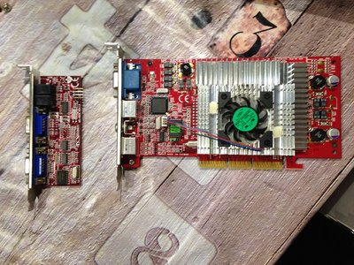

* SB Live 5.1

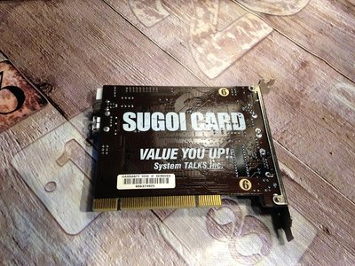

But the real jewels are the MSI GF3 Ti500 Pro-VTG card and the Japanese Sugoi card. I found the GF3 locally, boxed in excellent condition. Missing where the driver/game cd's and the VGA pass-through cable but for the rest everything was present and in top shape. So to try out the 3D glasses I'll grab one of my V2 pass-through cables to feed the daughter board.
The Sugoi card was part of a package deal I did on Taobao, actually the same package that carried that Canopus X21.
I poppped in an 80GB HD and a silver bezel LG optical. It is currently running WinXP SP3 and a fresh install of Q3 shows a promising 150+ fps timedemo in 1024*768*32 😈

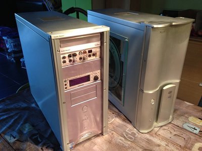

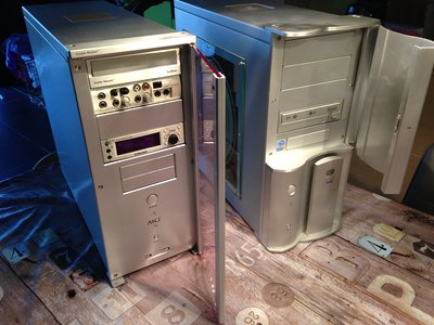

The GEN1 and GEN2 side by side 😎

Heresy grows from idleness ...
Reply 3 of 20, by Fusion
I'm jealous of your GF3 ti500. 🤣
Pentium III @ 1.28Ghz - Intel SE440xBX-2 - 384MB PC100 - ATi Radeon DDR 64MB @ 200/186 - SB Live! 5.1 - Windows ME
Reply 4 of 20, by ATi_Loyalist
Oh wow! Very cool 😀 love that CM wavemaster

I am reeeeaally digging the all red look. I usually think only 1 red component looks tacky (I'm running a red 9800Pro with all other components green), but this all red setup looks beautiful!
Also, that mobo has some weird RAM slot positioning!
I always care for looks when the hw is exposed and agree this looks nice. Some cool visual upgrades still and it will look even better.
The rimm position is unusual indeed; the one below the cpu is actually rimm 1. I had to add terminators to rimms 3&4 because I'm only running one pair.

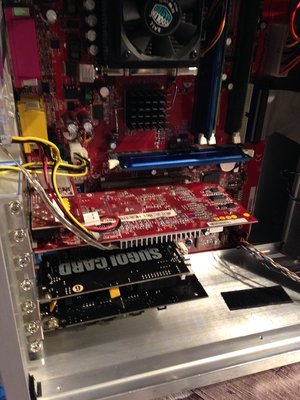

I was hoping that Sugoi card would install itself under XP but that appears to be in vain ...
So the hunt begins for drivers for a Japanese addin card ...
Oh boy
Reply 10 of 20, by NJRoadfan
https://translate.google.com/translate?hl=en& … %2Fdownload.htm
The "Great Card" (Sugoi = Great in Japanese) PCI drivers are likely what you are looking for. Windows XP should have automatically installed the firewire and USB OHCI and EHCI drivers.
Reply 11 of 20, by AzzKickr
How awesome is that. Thanks a million for helping me out ! I'll check it out as soon as I get home.

Reply 14 of 20, by AzzKickr
AzzKickr wrote:
I postponed this until now because of the ridiculously good weather currently in Belgium. We don't get that many days of excellent sunny weather so gotta make the most of it when they do arrive. Too good to spend inside tinkering on old nerd stuff 🤣
So the card works and was able to use those drivers !!
Actually reporting this from my gen2 system now 😀
