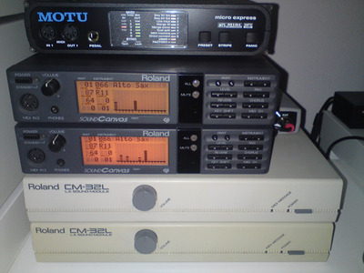

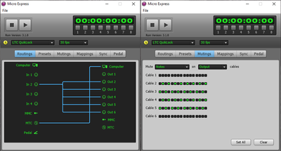

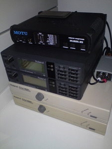

Reply 123 of 134, by voodoo5_6k
Yesterday saw the grand reconfiguration of my MIDI setup!
First, a little background. Roughly five years ago, I read about Cloudschatze's interesting setup, which includes a split channel configuration of 2x CM-64 (2x32 voice=64 voice polyphony) and 2x SC-55 (2x24 voice=48 voice polyphony), here and here.
I found this to be very interesting, but I was already happy to have a single CM-32L and a single SC-55... And who wouldn't?
Over the years I searched for backup units, and whenever I saw something for a reasonable price, I tried to get it. However, I more or less completely forgot Cloudschatze's setup. Just by accident, I rediscovered the thread and the picture of his setup. My interest was sparked again, why not put the backup units to good use? 😉 I read it over and over again, until I understood how he had accomplished it. Key is a MIDI interface that is capable of MIDI routing, or at least channel splitting/muting. In my setup, all PCs and MIDI devices are connected to a UM-550. A nice device for what it is, but it cannot do what I'd need to go through with the reconfiguration. After investigating my possibilities and space constraints, I decided to get the MOTU micro express (https://motu.com/products/midi/micro_usb). It is a 4-in/6-out MIDI router, and can hold eight user-programmable presets. Using their ClockWorks software, the device can be configured as needed, and then can be used as a stand-alone device, with no further need for a USB connection (except for power). Cloudschatze went all the way with applying SysEx messages to configure his MIDI device daisy-chains. I wanted to keep it as transparent and simple as possible. Hence, my decision for the micro express. Each of my modules is then directly connected, no need for SysEx messages etc.
Yesterday, I finally had all the pieces available. First, I had to disassemble the entire MIDI setup (a good opportunity to clean the desk underneath the MIDI modules 😉), add two power bricks, two more MIDI cables, and several audio cables. After all cabling had been prepared, a new MIDI stack was created, 2x CM-32L, 2x SC-55, 1x X3MB, 1x micro express. As I dislike using MIDI connectors located on a device front panel, the micro express does exactly fit into my setup. As the MIDI in/out connectors on the front panel aren't redundant (like in the 19" units), the device is effectively a 3-in/5-out (for me at least). I wanted to connect three PCs to five MIDI modules... Perfect!
After the hardware was ready, it was time to get the micro express configured. Using the ClockWorks software (contained in their driver package) is pretty straightforward. I created three presets, one per PC. In each preset, one specific MIDI-in port is routed to the five MIDI-out ports on the back. On the output side*, I have set a filter to mute the even or odd channels, respectively, for each pair of modules. As a result, CM-32L #1 only gets to play the odd channels, CM-32L #2 the even channels of the complete MIDI signal. Same for the SC-55's. The X3MB receives the unmodified MIDI signal. As all outputs receive the MIDI signal all the time, it is also great for testing different MIDI modules in games. I just power on all devices and then switch the desired audio output to the sound card.
(* It is important to do that on the output side, as otherwise the respective filter would change the MIDI signal entering the micro express, with no connected device having access to the full signal.)
45.22 KiB
1854 views
Then, testing... Here you see the SC-55 pair playing the Sam & Max - Hit the Road intro. SC-55 #1 plays on the odd channels, SC-55 #2 on the even channels. Success!
412 KiB
1854 views
So, now I have a CM-32L cluster with 64 voice polyphony, and an SC-55 cluster with 48 voice polyphony, yay 😎 Thanks, @Cloudschatze for the inspiration and all the provided information!

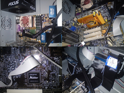

Reply 124 of 134, by voodoo5_6k

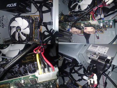

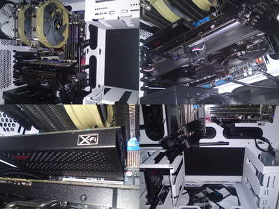

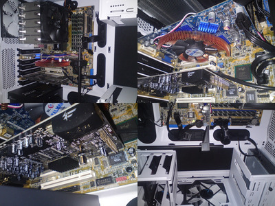

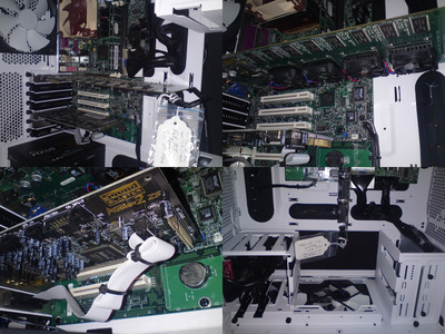

Replacing some of my older PSU has been a to-do item for quite some time. I just never did it, for various reasons, well, excuses 😉
Recently, when I finally was able to play through of Grim Fandango on my Voodoo5 6000, I decided to just replace them all. I chose Seasonic's Focus GX 550W unit for all but one system, which got a Focus GX 650W unit (because of the relatively large GPU). For all others, the GX 550W is sufficient, or overkill already. But it is the smallest model in that Focus range. With all PSU from the same manufacturer, this allowed me to get rid of several adapter cables I used in the past, because I now had a large pool of cables to choose from (all the cables that came with the PSU and some additional cables I ordered from the Seasonic support). The systems based on older hardware would use all the Molex power cables, whereas the ones based on newer hardware would use more of the SATA power cables. Also nice: the 10 year warranty for each unit.
Today, I finished the job of replacing all PSU. While I was at it, I took some new photos of the systems to make a new system overview post.
With all systems now using brand new PSU, I no longer have to worry about an old PSU failing and potentially taking out the entire system. I did the same for my old Roland MIDI modules from the very beginning. They all use then brand new Roland PSB-230 PSU.

Retro System Overview - Q1 2021
Shared devices
Monitor:        NEC MultiSync FP1375X
KVM: Aten CS-1758 (only for keyboard, mouse, audio)
Keyboard: Microsoft Natural Keyboard Pro (USB)
Mouse: Microsoft IntelliMouse Optical (USB)
Speaker: Canton Plus Media 3
MIDI Router: MOTU micro express
MIDI Module 1: 2x Roland CM-32L (split-channel, 64 voice polyphony)
MIDI Module 2: 2x Roland SC-55 (split-channel, 48 voice polyphony)
MIDI Module 3: DreamBlaster X3MB
Desktop
MIDI details
Retro 1 - Lucasfilm/LucasArts Games (+ DOSBox)
OS:             Windows 98 SE + DOSBox
Case: Evercase ECE1135
CPU: Intel Core 2 Duo E4700 2x 2.60GHz
Cooler: Thermalright AXP-200 + Thermalright TY-147A
Motherboard: Asus P5PE-VM
RAM: 512MB Corsair PC-3200 CL2.5 DDR 400
Graphicscard: 3dfx Voodoo5 5500 PCI 64MB
Cooler: 3dfx Stock Heatsinks + 2x Noctua NF-A4x20 FLX
Soundcard: Creative Labs Sound Blaster Audigy 2
MIDI Interface: Roland Edirol UM-1
Network: Intel Pro/100+ Ethernet Card
SSD: Intel SSDSC2CW060A310 60GB (SATA)
ODD: Plextor PX-740A (IDE)
FDD: Alps Floppy Drive
PSU: Seasonic Focus GX 550W
Controller 1: Microsoft SideWinder Game Pad (Gameport)
Controller 2: Microsoft SideWinder Precision Pro (USB)
523.79 KiB

Retro 2 - 3dfx Glide Games (+ Grim Fandango on Voodoo5 6000)
OS 1:           Windows 98 SE (Voodoo5 5500)
OS 2: Windows 2000 Pro SP4 (Voodoo5 5500)
OS 3: Windows ME (Voodoo5 6000)
Case: Fractal Design Define R5 White
CPU: Intel Pentium III-S 1.4GHz
Cooler: Thermaltake Volcano 12 + Noctua NF-A8 FLX
Motherboard: Intel D815EEA2 + Manhattan 158282 SATA300 Drive to IDE Host Controller Converter
RAM: 512MB Micron PC133 CL2 SDR 133
Graphicscard 1: 3dfx Voodoo5 5500 AGP 64MB
Graphicscard 2: 3dfx Voodoo5 6000 AGP 128MB (3700 A)
Cooler: Unmodified
Soundcard: Creative Labs Sound Blaster Audigy 2 ZS
MIDI Interface: -
Network: Onboard
SSD 1: SanDisk SDSSDA-120G-G27 120GB (SATA) (OS 1 + 2)
SSD 2: SanDisk SDSSDP-064G-G25 64GB (SATA) (OS 3)
ODD: Hewlett-Packard GDR-H30N (IDE)
FDD: -
Controller 2: Microsoft SideWinder Precision Pro (Gameport)
595.05 KiB
1725 views
Retro 3 - Early XP Games (+ Splinter Cell on GeForce4 Ti 4600)
OS:             Windows XP Pro SP2
CPU: Intel Pentium 4 3.4GHz Extreme Edition
Cooler: Scythe Mugen 2 Rev. B
Motherboard: Asus P4C800-E Deluxe
RAM: 4GB Kingston PC-3200 CL3 DDR 400
Graphicscard 1: Asus V9950 GeForce FX 5900 Ultra AGP 256MB
Cooler: Zalman VF700-Cu
Graphicscard 2: Asus V8460 Ultra Deluxe GeForce4 Ti 4600 AGP 128MB
Cooler: Zalman VF700-AlCu
Soundcard: Creative Labs Sound Blaster X-Fi Xtreme Gamer Fatal1ty Pro. Series
MIDI Interface: -
Network: Onboard
SSD: SanDisk SDSSDA-120G-G26 120GB (SATA)
ODD: LG GH24NSD1.AUAA10B (SATA)
FDD: -
Controller: Microsoft Xbox 360 Game Pad (USB)
680.35 KiB
1725 views
Retro 4 - Late XP Games/Early DX10 Games
OS 1:           Windows XP Pro SP3
OS 2: Windows Vista Business SP2 64-bit
CPU: Intel Xeon X5470 4x 3.33GHz
Cooler: Thermalright Silver-Arrow
Motherboard: Asus P5Q-E
RAM: 8GB Corsair PC2-8500 CL5 DDR2 1066
Graphicscard: Evga GeForce GTX 580 3GB
Cooler: Evga Stock Baseplate + Raijintek Morpheus + 2x Noiseblocker NB-BlackSilent Pro 120mm
Soundcard: Creative Labs Sound Blaster X-Fi Titanium Fatal1ty Professional
MIDI Interface: -
Network: Onboard
SSD: SanDisk SDSSDA-240G-G26 240 GB (SATA)
ODD: Samsung SH-224GB/BEBE (SATA)
FDD: -
PSU: Seasonic Focus GX 650W
597.92 KiB
1725 views
