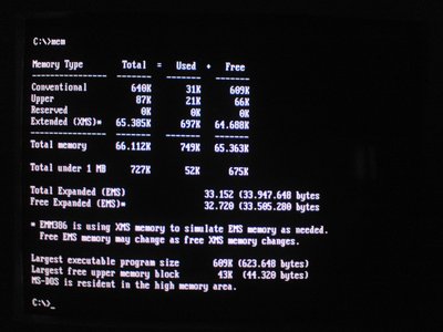

I am just reporting back in from my first testing session this weekend. And it looks good! 😀
But first, what did I do? I wanted to rule out incompatibilities etc. between the games and the stuff I've been loading for DOS to keep a very low memory footprint. So I simply reinstalled DOS 6.22 and just used what is there by default. I have added lines for EMM386 and the CD-ROM driver, as well as the mouse driver. I have installed the AWE64G drivers and configured the card. Then I have optimized the config.sys and autoexec.bat, without loading anything "modern" or special from 3rd parties. The result is this:
    2.03 MiB
    4116 views
    Memory Report
Then I disabled the L1 cache and tested Sam & Max again, and everything worked, no system freeze.
Next was Day Of The Tentacle, and now it worked too. I fired up Monkey Island 1 & 2, and they worked flawlessly. Indiana Jones And The Fate Of Atlantis too, MIDI and SFX + speech, all working. That's really great news for me 😀
Now I can move on to identify the best CPU settings for DOS (the fastest settings on which everything still works). If everything works with a single CPU setting (e.g. Pentium MMX @133MHz), and the rest can be dealt with by disabling the L1 cache in addition, that would be really cool. Then I would just have to change the CPU settings to "DOS" if I wanted to play in DOS, and back to normal (233MHz) when booting into Windows 95. Not too complicated. If I can keep the system bus frequency @66MHz (it worked for now), then I just have to toggle one or two switches to change the CPU internal multiplier.
I still have to test a few more games under DOS but those weren't exactly troublemakers in the past (Monkey Island 1 CD-ROM, Full Throttle, The Dig). Maybe I can get through the DOS testing this weekend. That would be great. I could then aim for reinstalling Windows 95 and setting that up on the next weekend.

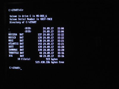

I have now tested every game I want to run on Retro 1 (in DOS), and everything seems to work 😀
Test results (MS-DOS 6.22):
  • + The Secret Of Monkey Island (EGA): Soundeffects (AWE64G) + MIDI (CM-32L) working
    + The Secret Of Monkey Island (CD-ROM): Soundeffects, music & speech (AWE64G) working
    + Monkey Island 2: Soundeffects (AWE64G) + MIDI (CM-32L) working
    + Indiana Jones And The Fate Of Atlantis: Soundeffects & speech (AWE64G) + MIDI & special soundeffects (CM32L) working
    + Day Of The Tentacle: Soundeffects & speech (AWE64G) + MIDI & special soundeffects (CM-32L) working
    + Sam & Max Hit The Road: Soundeffects & speech (AWE64G) + General MIDI (SC-55) working (with L1 cache disabled only)
    + Full Throttle: Soundeffects, music & speech (AWE64G) working
    + The Dig: Soundeffects, music & speech (AWE64G) working
There was a little struggle with The Dig. It refuses to run when attempting to start it from HDD. I had all files copied into a DIG directory (on D:), but after starting it, it directly dropped back to the command prompt, stating that it was unable to load MUSCRIPT.SCR. After some testing, all I had to do was to create a DIG folder on C: so it would think it runs from CD (D:) and would just save the IMUSE.INI to that folder. All other files still reside in D:\DIG. After doing that, everything worked.
Then I created batch files to launch each game without having to memorize which parameters to use on which game's executable.

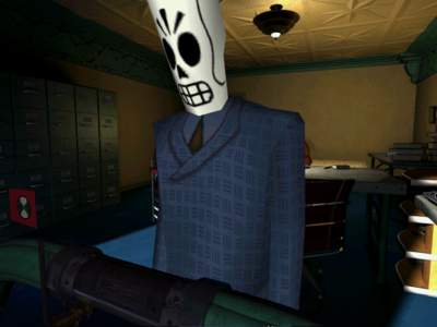

Reply 47 of 134, by voodoo5_6k
Yesterday was a public holiday and I had some free time in the afternoon. I quickly installed all the drivers and Grim Fandango as well as Escape From Monkey Island. I still can remember what difference it made back then when I saw games running on my Voodoo5 with activated FSAA (4x Rotated-Grid Super-Sampling Anti-Aliasing, as close as you can get to image quality perfection... without using a Voodoo5 6000 of course 😉). And in case of those two games which are limited to 640x480 it was even better. You don't see the low resolution anymore, no more blocky edges on characters and objects. A great visual enhancement, this almost feels like a new game 😀 I have attached a screenshot of each game, showing the lead character in close-up, with many varying edge angles in front of contrasting backgrounds. Compare this to screenshots of how the games look without that...
The reason for having a Voodoo5 5500 PCI in this system:

Note: When you download the image file and enlarge it, you can have a look at how the edges have been treated by the FSAA. The next time I'm working on Retro 1 I'll try to make screenshots of identical scenes with and without FSAA for better comparison.

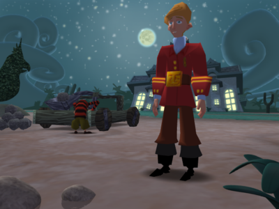

Reply 48 of 134, by voodoo5_6k

So, the Windows 95 installation is now almost pristine. The only additional software is PowerQuest's PartitionMagic & BootMagic, and the three Windows based LucasArts adventure games, plus the aforementioned drivers.
All three games are running directly from disk. Escape From Monkey Island needed a no-cd patch. Normally, I would have used the replacement launchers from bgbennyboy (Quick and Easy Software) for all three games, but they don't work under Windows 95. These launchers are, in the truest sense of the word, a quick and easy way of getting these games running from disk without the need for CD swapping. I can highly recommend them to everyone (well, except for the Windows 95 users of course 😉). Since these launchers were not an option now, I had to deal with the task manually.

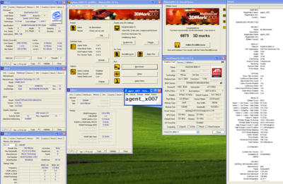

Reply 53 of 134, by agent_x007
You only need a dual adapter (Slot-1 to 370 + this : LINK) 😉
Example :
654.53 KiB
3797 views

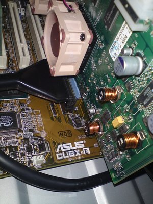

Reply 54 of 134, by voodoo5_6k
Just a quick update today. I'm now evaluating a new motherboard. If the system turns out to be fast enough for DOSBox I might decide using that instead of trying to get everything working on a single machine in real DOS...
Asus CUBX-E, with latest BIOS (+ added Tualatin microcodes), Intel 440BX, socket 370:
    1.97 MiB
    3758 views
I will try to get a Tualatin Celeron 1.4GHz (pin-modded), but until then I will use my fastest 100MHz FSB CPU, the Pentium III 1.1GHz.
END OF LINE.

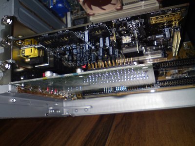

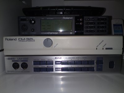

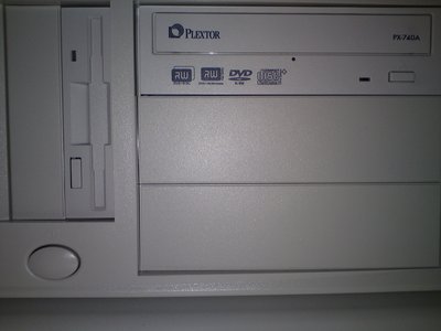

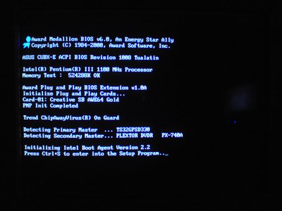

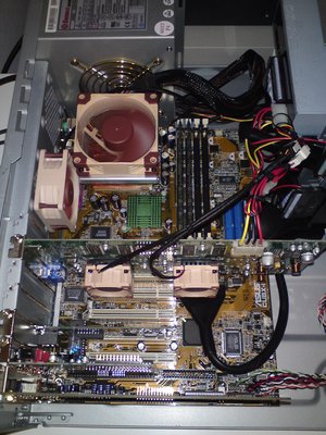

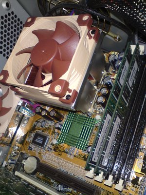

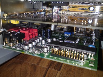

Reply 55 of 134, by voodoo5_6k
Still no real update, I'm currently busy with other things, unfortunately. At least the system is now fully assembled and a basic Win98 installation is running. Drivers and tools are still missing though. I'm planning to get back working on this on the weekend (at least let it run a few hours of Prime95 to check whether everything's still OK under full load). Until then, a few pictures of the system.
Quick specifications: Pentium III 1.1GHz, Asus CUBX-E, 2x 256MB Micron PC100 CL2, 32GB Transcend IDE SSD (the rest is the previous Retro 1)
    2.13 MiB
    3690 views
    System Overview
    1.99 MiB
    3690 views
    POST
Note: Exhaust fan and the large CPU heat sink plus 8cm fan was a really tight fit 😎 I have already flashed the Tualatin supporting BIOS for the CUBX-E in case I should get my hands on a Tualatin Celeron 1.4GHz... On the other hand I don't really want to disassemble the CPU heat sink... I'm hoping that the 1.1GHz Coppermine is fast enough for DOSBox (for The Dig specifically, 486 DX2/66 is the CPU requirement on my boxed copy).
END OF LINE.

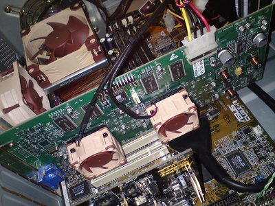

Reply 56 of 134, by voodoo5_6k
Today, I have installed the missing drivers and set up the system so it at least could execute DOSBox. I only wanted to test The Dig in DOSBox, because it is the most demanding game of the few I want to run (in DOSBox). As I mentioned before, I already have a DOSBox setup on a modern machine, and I use 30,000 cycles in the The Dig config. Well, 30k is too much for the Pentium III 1.1GHz on Win98, but the game ran fine when I slowed it down to 20k cycles. Well, that's looking good. Videos played smoothly and sound and speech were there, no audio issues. Seems to run fine! I'll do more testing in the next days. Now, the system is running Prime95 for 4h already, no issues so far. The CPU is running @43-44°C at the moment, the CUBX-E has a temperature of 36°C (PC Probe readout). Overall, I'm happy 😎 Maybe, I won't even try to get the Tualatin Celeron. Everything seems to run pretty fine and I do like the Pentium III 1.1GHz somehow 😉
I'll try to get some photos uploaded tomorrow when I find the time for that, it'll be a pretty busy week unfortunately 😒

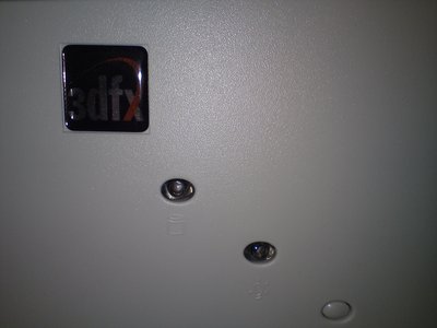

A few pictures of the system:
    932.9 KiB
    3443 views
    System Overview
    923.23 KiB
    3443 views
    Pentium III 1.1GHz & 2x 256MB Micron PC100
    989.04 KiB
    3443 views
    Voodoo5 5500 PCI
    635.85 KiB
    3443 views
    Sound Blaster Live! 1024
    884.24 KiB
    3443 views
    MPU-401AT

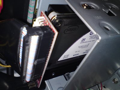

...Continued from above. More pictures:
    476.94 KiB
    3442 views
    Intel SSD
    899.35 KiB
    3442 views

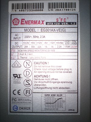

    Enermax PSU
    549.72 KiB
    3442 views
    Alps Floppy & Plextor DVD
    570.02 KiB
    3442 views
    Case badge
And the MIDI rack...
    397.64 KiB
    3442 views
    MIDI rack
