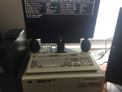

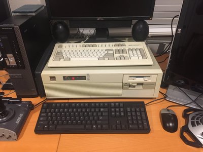

My Rebuild StandardPC 286 with 386 MoBo. It's Keyboard is the beige Emerson resting atop it. I bought this at GoodWill for $10. Note that the CD ROM was added later

I use a modern Dell Monitor for this system as it has three inputs(DisplayPort, CVI, and VGA) that I can switch between, especially important since I have another retro rig (PIII) and a modern PC (i5-2450S) as well as space constraints. I've since placed the monitor in 4:3 mode for VGA and all is well.

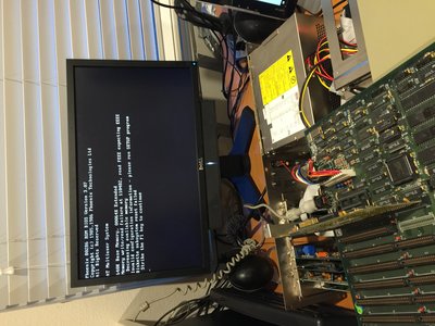

The most common state my PC was in during the whole process. Dunno why it's rotated. Shows up fine when I click on it.

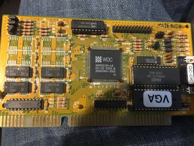

One of the updates I placed in it was a rather curious Western Digital WD90C30-LR video controller. It was only putting out black and white for awhile until I removed that top jumper. Suddenly color.

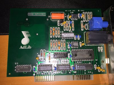

When I was cleaning out the old PC of its guts, I found that in there along with a Roland MIDI interface card and an unbranded mystery card with cut cables. I think this one as an old audio rig.
All in all I'm very happy with her. She doesn't have a sound card yet but I've recently ordered one (the one that showed up was both A. Not what was ordered and B. Dead on Arrival.

Reply 3 of 3, by matze79
The Adlib Card is pretty simple, repair is possible, don't throw it out.
here are much people who can do this.
