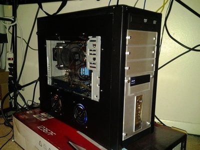

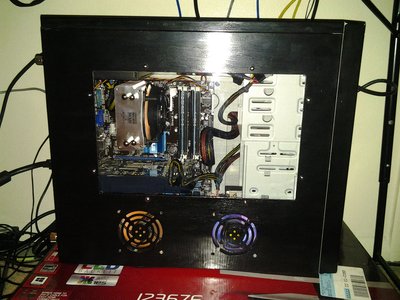

Been a long time since I last posted. Anyway, this is my current XP build build I have been fine tuning over the past few months. Specs as follows:
LGA 771 to 775 modded Xeon XEON E5450 @3ghz
Nexus Real Silent CPU Cooler AXM-8200 adapted for LGA775
Asus P5G41T-M SI
Corsair XMS3 4GB (2 x 2GB) DDR3
Galaxy Geforce GTX 460 768mb
SoundBlaster Live 24-bit
SATA Western Digital VelociRaptor 80GB 10,000RPM & Toshiba 500GB 5400RPM drive
DVD Drive
EVGA 430 watt 80+ psu
6x 80mm fans and 1x 60mm fan
3DMark 2k6 scores about 300 points shy of the 17,000 mark. basically powerful enough to run anything XP era @ 1920x1080.
