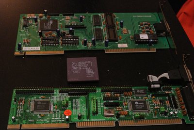

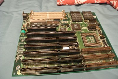

I decided to make a "classic" 486 build to use for MT-32 games. I've used a Chaintech 4SLP motherboard from my failed 5x86 build. No matter how hard I tried, this board always gave me issues with both 5x86 and AMD DX4-100 (even though it explicitly supports the latter). However, with a regular 486DX2-66 the experience was extremely smooth and worked the first time I tried to boot it.

The board has 256KB L2 cache and a SIS471 chipset. The battery was replaced by the previous owner and it seems to have some sort of an aftermarket VRM module installed. I fitted the motherboard with 4x4MB of RAM — I could never fit more than 16MB of memory in this board anyhow.
I'm actually using Overdrive DX20DPR66 v4.0 even though I have a regular 486DX2 — just wanted to use the stock heatsink. Both chips have write-through cache as far as I can tell and according to CHKCPU.
I'm using a VLB Cirrus Logic CL-GD5428 board upgraded to 1MB of VRAM and a VLB controller with a UMC chip. Connected to it is a 1.6GB Samsung hard drive — the largest one I have that still has the "old disk whirring" sound. Also, I have a 24x CD-ROM connected — the slowest one I have that still supports CD-R/CD-RW.

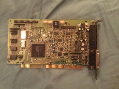

For sound I'm using a Vibra CT2940 with true OPL3. I also have a CT2230, but I'm using it in an AMD K6-3+ build that is better suited for General MIDI games.

2) I have atrocious performance in Duke Nukem 3D. Not the most important game for this build, but still — I've seen people on YouTube play DN3 on 486DX2 in 320x200 with no issues. I've tried running UniVBE 6.7 from Vogonsdrivers.com and from Phil's benchmark pack, but in both cases it says that my card is not supported — even though 5428 is explicitly listed as supported in Readme. Am I doing anything wrong or should I use some different version of UniVBE?

A DX2 66 should handle VGA Duke3D OK - but not SVGA obviously. Sounds like something's not right - have you fiddled with the BIOS for that motherboard? Caches all enabled? What's with that EPROM? The sticker appears to be missing, I can see the little window.

Reply 14 of 16, by Private_Ops
That chip to the right of the power connector with the "window". I'm not terribly knowledgeable with those types of chips but, I'd cover that window with a small piece of black tape.
