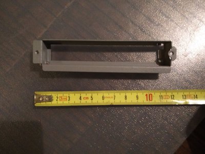

dr.zeissler wrote:
Mine is missing the right holder for the ISA-Card, so my soundcard is not fixed 🙁
Is this what you need? It's from a system I don't own anymore. Not sure if it's the correct shape though, different brand.
    180.94 KiB
    4279 views

Reply 6 of 36, by dr.zeissler
Could be the right thing...but I am not sure because I have not seen this as a fully assembled machine.
Here are some pictures of my machine. https://www.flickr.com/photos/94839221@N05/se … 57683681646872/
If you do not need it, I'll be interested in this. My location is in germany. Please let me know what I
should pay for it. Greetings Doc
Btw: The fan is relatively loud in my machine, do you have an advice for a new a slient fan for it?
Thx
Doc

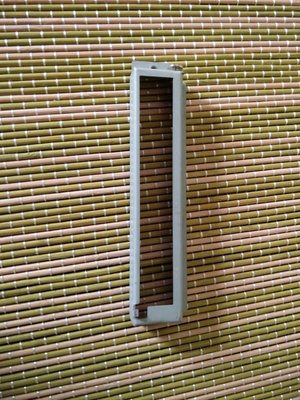

Reply 7 of 36, by Gered
That does look somewhat like the part you're missing (though I think it might be the wrong shape... possibly). I can double check with my CWD-4001 when I'm back from work and post pictures of it.

Reply 9 of 36, by Gered
Here you go, probably more photos then you need, but better safe then sorry. 😀
Looking at Rawit's photo again, I'm thinking it might work, but the one problem I see right away is on the side opposite the one which has the spot for the screw, there's no little extension to slide in on the CWD-4002 case (see my last two photos, I'm talking about how it fits onto the case on the left).
Not sure what to think. If I can take any more specific measurements you think might help, let me know.
Toshiba 430CDT
Reply 10 of 36, by Rawit
Thanks for the pictures! I think it will work 😀
@dr.zeissler, PM incoming...
    115.96 KiB
    4209 views
YouTube
Reply 11 of 36, by Gered
Ah yeah, that does look like it should work, though as I said the little clip-thingy (on the right side of your most recent photo) won't fit into the little slot on the CWD-4002 (it would need to be on the front of the part, not on the back where it is now... or maybe the lighting in your photo is playing tricks with my eyes and it actually is on the front side haha). But that's not the end of the world, the other screw should be ok to hold it in place well enough. 😀

Reply 12 of 36, by dr.zeissler
Thank you! With this little addon my soundcard will be safe in my unisys 😀
Thx!!!!! Please let me know if I can help with something.
Greetings
Doc
Reply 13 of 36, by dr.zeissler
Back from vacation...and it already has arrived 😀 So first attempt...does not fit, second attempt...does not fit 🙁
Then I found out that it is minimal different, but it fits if I use a metal feile and take away some hight on the right side. Now it fits perfect.
Thank you Sir of Sir's !
