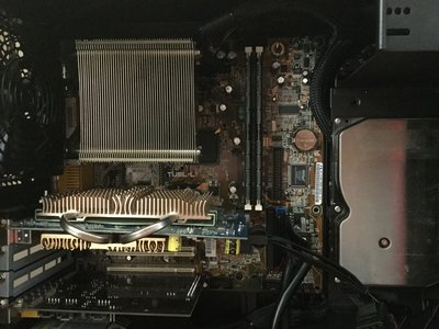

Here's a update in case anyone else is considering using this mobo, I see a few of them out there for sale.
1) This thing is significantly wider than my old TUSL2-M. It is still mATX form factor, but it is at least 2 inches wider, the TUSL2-M ends just to the right of where the DIMM slots are positioned on the TUSL-L:
2 MiB
876 views
In fact it is basically too wide, while it still fits into my case (Thermaltake Versa H15, fairly basic mATX mid-tower), it covers up some of the cable routing slots on the mobo tray and also blocks the use of the optical drive bay.

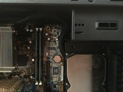

I have a fairly short LG DVD-RW and a couple of the capacitors on the top right of the mobo prevent it from fitting all the way into the only drive bay in the case:
2.28 MiB
876 views
