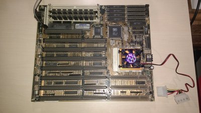

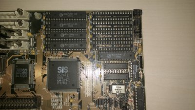

The Motherboard in all it's glory. Barrel battey desoldered, board saved. External battery.
663.67 KiB
1795 views
128kb Cache. Not much, yet enough for me.

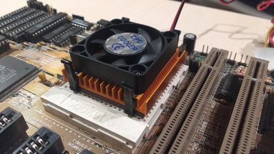

CPU and the brand new old stock Cooler.
539.34 KiB
1795 views

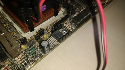

Voltage regulator. Sweet. :-P
655.75 KiB
1795 views

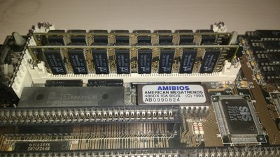

And 16mb of Ram

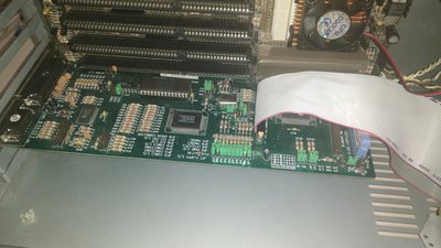

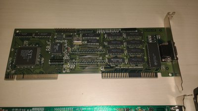

The S3-VLB card. Has no spaghetti lines at all on LCD/TFT.

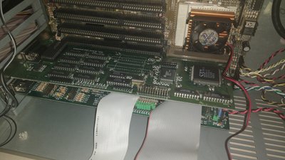

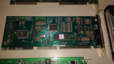

Pine PT-627 Controller. Awesomme card.... Love it. :-P
630.33 KiB

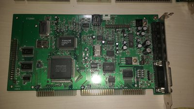

Creative SB16/Vibra16 soundcard.
551.85 KiB
1793 views

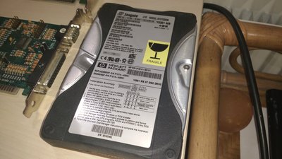

The Seagate harddrive.

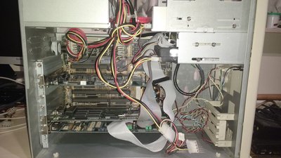

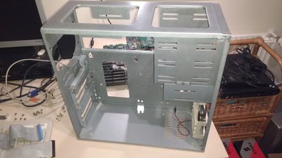

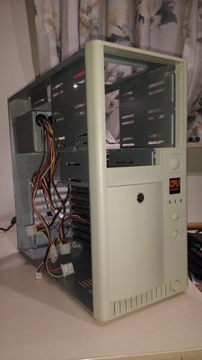

The case, stripped down and straightened out.
I simply love all these components. They are great, perform excellent and play everything 1990 to 1993.
Reply 2 of 20, by brostenen

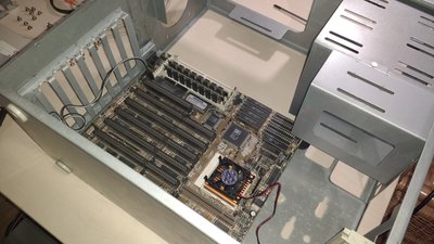

Next step.... Reassembling of the case and motherboard installation.
507.61 KiB
1773 views

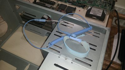

Remember wristband... It's vintage hardware after all. ;-)
509.89 KiB
1773 views

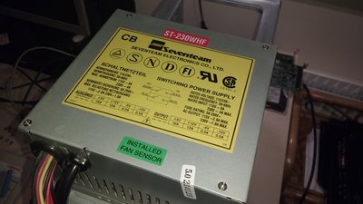

Time to install the original PSU.
415.9 KiB

Motherboard installed in the re-assembled case...
Reply 3 of 20, by brostenen

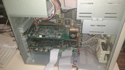

I have been installing the rest of the hardware, and moved the controller card down. As the data cables would begin to push the VGA card up, and it would loose contact in the VLB slot. Made a quick drive speed test, and it made no difference at all. It will be kept in the bottom slot for now.
564.99 KiB
1753 views
Controller installed... (I moved it down later on)
578.82 KiB
1753 views
S3 card installed...
472.29 KiB
1753 views
Soundcard installed...
504.19 KiB
1753 views
Drives installed.
538.81 KiB
1753 views
Drives and cables all connected now.

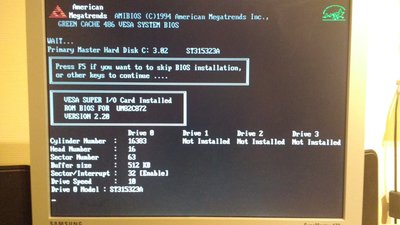

First boot.....

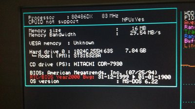

I started by entering the BIOS, and load "fast defaults/settings", enabling stuff, disabling stuff and setting the clock.
Rebooted and the system would start perfectly. No issues, other than the one were I had to move the controller down.
Took a picture of the Controller-BIOS screen and went on to test with Norton Sysinfo, to see if it made a difference.
Did not, so I am a happy champ. All what's missing, is the final touches such as bay covers and one rear slot bracket.
541.63 KiB
1753 views
Pine PT-627 BIOS screen....
Now it is time for bed.... This whole rebuild, took me some 4,5 hours. And it is late. I will do benchmarking tomorrow.

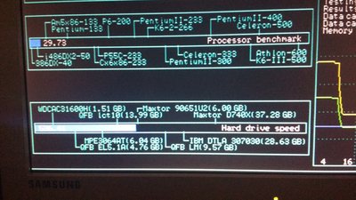

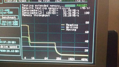

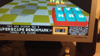

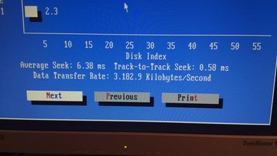

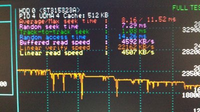

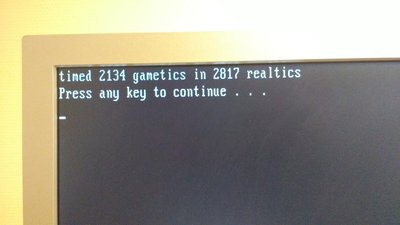

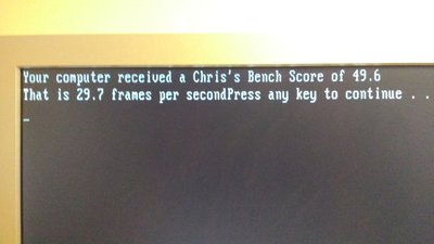

Time for some benchmarks.... First results....
496.04 KiB
1720 views
640.7 KiB
1720 views
668.11 KiB
1720 views
658.4 KiB
1720 views

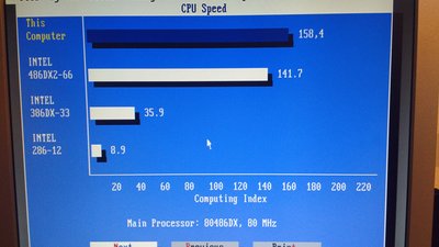

Reply 6 of 20, by brostenen
Norton Sysinfo results...

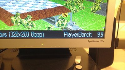

My thoughts on this build?
Hmmmm... For a gaming rig, that are aimed directly at 1989 to 1993 (untill Doom), then I like this build.
It has parts that works great with each other, it has no spaghetti lines (tested with Civilization and Lotus-III).
It runs Doom great, and Dynablaster run with both music and sound effects on.
I have had 3D-Bench running higher. Though I think it is the controller card that makes it run a tad slower.
Looking at the goal... Making a 1989/93 machine, and comparing it to a Dx2-66/CL-5428. Then it is great.
In other words... I am really pleased with this machine. Build-Log finished (for now).
Reply 8 of 20, by Gered
Very nice build! Love it. 😀
The benchmarks you took were interesting to me to compare against and see how much of a performance boost a DX2-80 might be in my build versus the DX2-66 I'm using now. Kind of an apples-to-oranges comparison though of course, given I'm using a different motherboard (FIC 486-PVT, VIA chipset) and I have 256KB L2 installed. Same basic video card though (S3 805 VLB).
For reference, I'm getting:
3DBench 1.0: 50.0fps
Chris's 3D Benchmark: 27.5fps
PC Player Benchmark: 9.3fps
Doom: 2842 realtics / 26.28fps
I guess I expected Doom would've been a tad bit more faster for you, but interesting to see it's on-par with my build.

Reply 11 of 20, by amadeus777999
Very nice build - 128KB cache limits you to 16MB in WriteBack mode - I might be wrong though.
