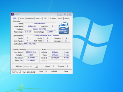

    --- 1. Modding and overclocking, pt.1: simple voltage mod performed, Windows boot at 2000 MHz (125 MHz FSB)
    --- 2. Modding and overclocking, pt.2: voltage divider mod performed, Windows boot at 2080 MHz (130 MHz FSB)

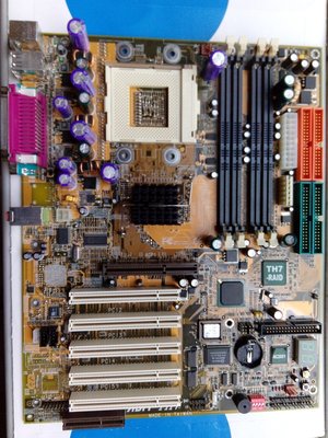

Hey there!
I'm fairly new around here, I've only shared one previous build on the forum, Outrigger, based around the OR840 motherboard. That system was intended to be a Celeron 300A until it derailed beyond recognition after 10 minutes into motherboard shopping. I am starting a system, and again I stray from the original intent, but this time I want to start a thread right away and document my progress. Here's my starting point: a socket 423 Pentium4 and an ABIT TH7-RAID motherboard…
3.61 MiB
1600 views
2.46 MiB
1598 views

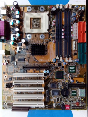

I've been meaning to build a retro machine for everyday use: my work involves a lot of reading pdfs, typing LaTeX, and web browsing. The latter basically means I need a Pentium4 because its the earliest possible CPU with SSE2, allowing me to use modern browsers.
My original idea was to get a socket 478 motherboard and use a Prescott and some DDR I have laying around, install Debian and be done. I took to marktplaats—dutch ebay, basically—and found this combo of mobo, CPU, RAM and heatsink for €5 + shipping, so €12 in total. I jumped on it because a) it was cheaper than all the 478 mobos listed at the moment, b) I have a lot of leftover RDRAM from my previous build, enough to max out the board with 2GB; and c) it looks like a fun and semi-exotic build that I would like to try.
With these components as a base, the plan is to get a few things to make the build as convenient as possible for today's daily usage;
  • Faster CPU: overclock this one for sure, but I will keep an eye out for faster CPUs available.

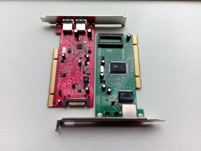

  • Fast storage (have): SSD is a must. I have a Promise SATA300 TX2 and an old Crucial MX100 ready to go, so I am set;
  • Fast data transfer (need): this will be tricky/expensive. I could in theory setup an eSATA port with the aforementioned controller, but eSATA is not something I use on other computers—I would have to invest in eSATA stuff. The other option is investing in a USB3 PCI card, which will be expensive unless I am lucky and find it used. I am leaning towards USB3, to be honest. Caveat: neither of these will hit full speed due to PCI limitations, which may be even more serious due to the PCI bug I've read about on the i850 chipset;
  • Fast internet connection (need): this means a 1Gb LAN adapter, since that already maxes out the PCI bus;
  • Powerful GPU (need): this gets tricky, too. I could max out the AGP port with a GeForce 7900 or a Radeon 3850, but I think none of the AGP options provide video decoding under Linux (I'm not sure on the ATI side, I'd love to be wrong about this). The next generation GeForce/Radeon have PCI versions, which have some sort of video acceleration present under Linux, so its something to look into. I could also just use Windows, but I haven't done that in a while for a work machine.
  • Modern case (need): USB3 in the front would be a must, as would be a headphone plug. It must be silent, too: a couple of well placed big fans cooling stuff down. I want to steer clear of watercooling since it adds complexity/money to the build. Finally, it must look good and showcase the hardware.
Before doing all these things, though, some basic maintenance to the board will be done. Even though no cap looks bloated, ABIT was notorious for making great boards with BAD caps, so the first thing to do is replacing all of them. After that is done I will start looking into the other things.
If you have any thoughts or ideas for such a system, I would love to hear them!

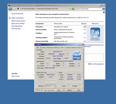

For everyone's amusement, the performance index according to Windows 7 Starter;
83.58 KiB
1815 views

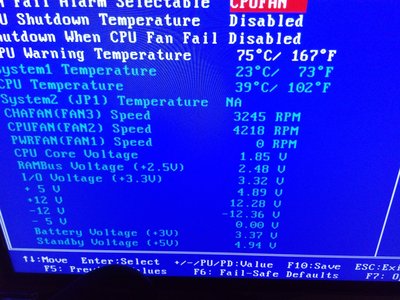

CPU is sweating bullets! Can't overclock further: the max voltage setting on the motherboard is 1.85 V, selecting this setting yields a voltage that oscillates between 1.77 V max and 1.73 V min. Recapping should help with these problems, and I hope with a bit more juice, 1.8 V or so (stock is 1.75 V), I'll be able to reach 2133 MHz stably.
The RAM performs admirably, I must say. It is also overclocked, running at 125 MHz, i.e., PC1000 RD-RAM. I had to put an 8cm fan on top of it because its COOKING! I am fairly confident that the clock generator and RAM will get to 133 MHz without trouble, but then again, I cannot really test without recapping. In the event they don't, well, I've always wanted to change a clock-gen and I have been reading about a similar mod that was performed on the TH7II-RAID, which uses the same clock-gen, sooooo… 😀
The SSD seems to be performing well, too. Best performer of the system, even! During installation I had to use the Vista drivers for the Promise SATA300 TX2 Plus, but after loading them the drives were recognized without any trouble.
I'll play with W7 Starter and see if its unbearably slow, or if its a good fit. Bigger update and plenty of pictures when I recap this weekend.

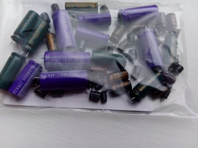

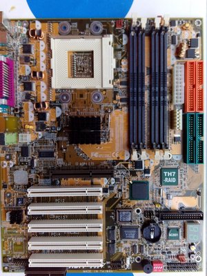

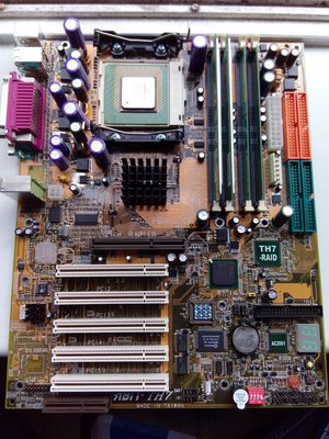

0. Motherboard maintenance
I have successfully changed each and every capacitor in the motherboard, even ones from circuits I know I won't use like the audio output. A few pictures…
The board before any surgery was performed
2.78 MiB
1601 views
54 capacitors later, here's the board completely stripped
3.17 MiB
1601 views
A bag of Teapo caps, ewwwww
1.84 MiB
1601 views
The board fitted with Nichicons (and a handful of Panasonics)
3.74 MiB
1601 views
My hope was that the recap would stabilize the voltage input into the CPU, unfortunately this was not the case and I am still getting max 1.77V or so. I will check every connection again tomorrow, if something's messed up I'll fix it.
I'll look into a voltage mod and see if I can make the board output some more juice.

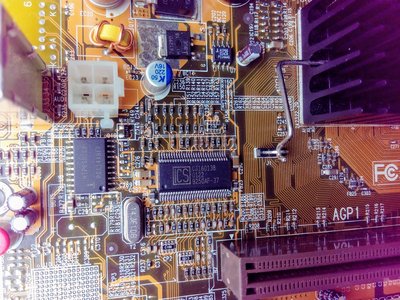

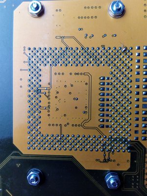

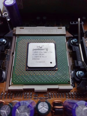

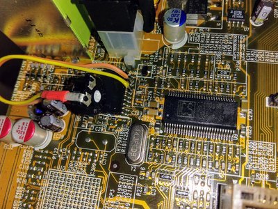

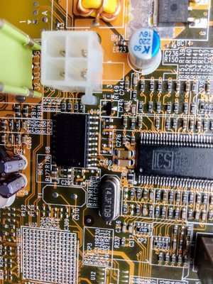

Since recapping didn't help increase/stabilize the voltage going into the CPU, and I need more voltage to overclock, something needed to be done.
The first attempt was naive: Willamettes have 5 pins to set voltage, and grounding all of them sets the voltage to 1.85 V. The 1.6 GHz model, and I think every 423 CPU, uses 1.75 V as a default, which means all but one of the pins are grounded.
4.05 MiB
1515 views
To start I bridged that pin to another one (top right corner), effectively grounding it, hoping the motherboard would enable higher voltage options if the CPU asks for 1.85 V. No dice: max voltage setting is 1.85V, and the max I am getting is still around 1.77 V. Time to read.
The voltage regulator feeding the CPU is the HIP6301, along with companion ICs HIP6601. Looking at the datasheet of the first one, I came upon something interesting: the regulator features adjustable Voltage Droop, set by using a single resistor.
3.55 MiB
1515 views
You can see the controller in this picture, set up vertically under the 4pin connector. The 7th pin on the right side, from the bottom up, is the feedback (FB) pin, basically reads off the voltage/current going into the CPU and adjusts accordingly. If you follow the trace coming out of that pin you come upon a a 2000 Ohm resistor (marked "202"), this is the resistor used for VDroop: it basically reduces the voltage going into the FB pin, and that voltage drop is substracted from the output that feeds the CPU. The datasheet says we can calculate the voltage drop with Ohm's law, assuming a 50uA load current;
VDroop = 50/1000000 * 2000 = 0.1 V, i.e., the reason I can only get 1.77 V when I ask the motherboard to give me 1.85 V. What I did was simply remove the resistor and bridge the contacts,
2.69 MiB
1515 views
2.39 MiB
1515 views
It works! Feeding 1.825 V to the CPU allows it to POST at 2133 MHz. Unfortunately it will not boot Windows, nor will 2080 MHz, even with 1.85 V. The fastest frequency that allowed Windows to boot was 2000 MHz, which I already had before. I want to push for more because 2000 MHz overclocks the PCI bus, which the SATA card does not like at all (I have already ran into problems because of it!)
I'll see if I can come up with something else.
