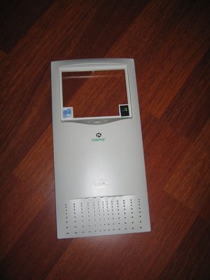

Front bezel:
125.48 KiB
776 views
Compared to my other Gateway system, a G6-266 (P2 266 MHz system), which uses a nifty system with metal clips to attach the front bezel, this one was attached with four screws. The case also lacks the soundproofing and the handy hard disk mounts and other clipped on bits present in the G6...

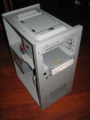

Case:
108.14 KiB
776 views
There's room for a floppy disk drive and two 5.25" optical disk drives. The hard disk mounts above the CD-ROM drives. It looks like it's better to first mount the hard disk and only then add the 5.25" drives. I need to bend some bits of metal back in shape because the person who removed the hard disk did so without first removing the CD-drives and bent the top of the (steel) case 😐 .

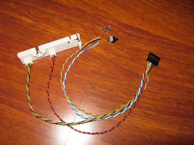

As mentioned, I also still need to rewire the front panel switches:
236.78 KiB
776 views
I've cleaned up the pins on the switches today, but I currently can't find my "third hand" soldering help and it's getting dark, so soldering will have to wait until later.

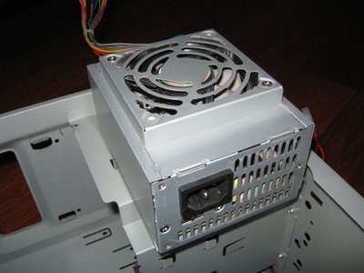

The measly 70-90 Watt power supply is located right next to the processor. It has a fan that sucks away hot air from the processor.

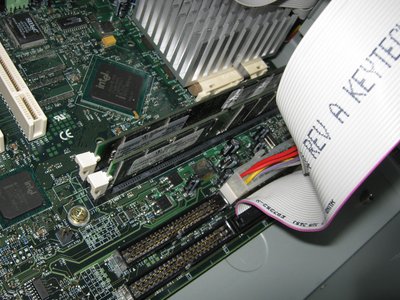

The motherboard was damaged by the person who removed the hard disk. One of the IDE connectors is cracked on the side:
220.51 KiB

...and the green connector and the black one besides it had their plastic part ripped off the contacts:
281.23 KiB
773 views
I slightly enlarged the holes for the pins and pushed the plastic parts back on. At this stage I have no idea whether the board was physically damaged beyond this, as I've still got to power it up.

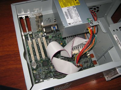

The placement of the power supply is not amenable to good cable management, it already looks like a mess with only the floppy drive cable:
193.85 KiB
773 views

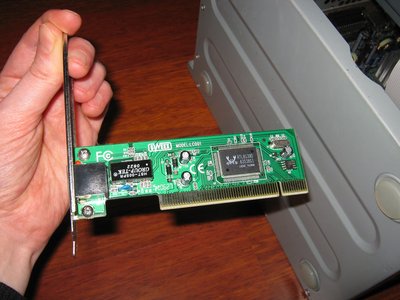

I will test the system in a minimum configuration, with a single stick of RAM and a floppy disk drive as the only things beyond the processor (a passively cooled Celeron that's probably in the 466-566 MHz range). The system came with two sticks of 133 MHz 64 Mb IBM SDRAM. Also included was a Sweex 10/100 Mb LAN card:
146.39 KiB
773 views

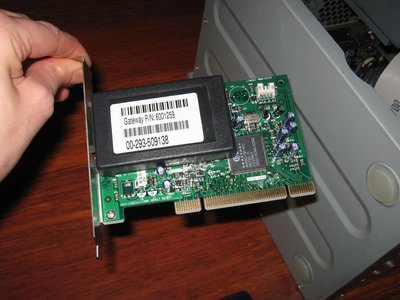

and a Rockwell 56k6 modem:
151.57 KiB
773 views
I've removed these two from the system, as I don't feel like accidentally frying them should it turn out that the damage to the board goes further than merely some damaged connectors.

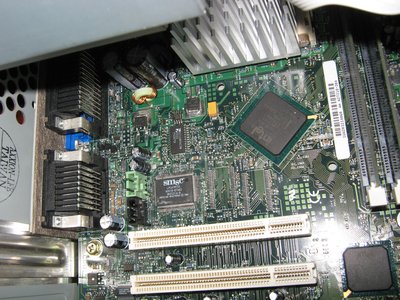

Edit: I pulled the board from the case, and careful examination shows A) the board is not straight anymore, and B) probable delamination damage around a chip near the connectors that were ripped off; the board surface undulates and appears damaged (as do some of the chip's legs). I guess the board is dead.

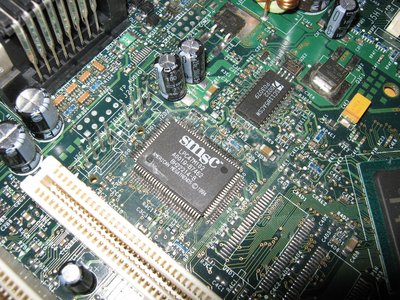

So this area doesn't look too healthy:

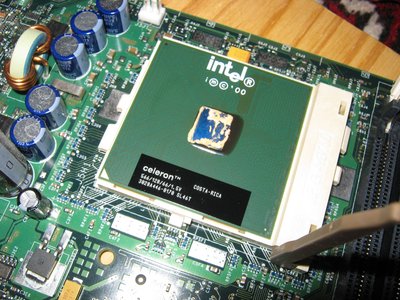

I managed to get the heatsink off the processor, and it's a Celeron 566 MHz:

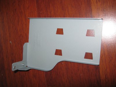

Power supply and the removable power supply bracket:
111.44 KiB
613 views

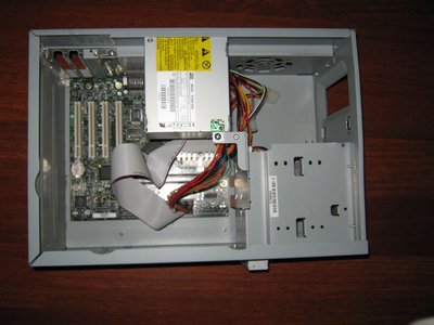

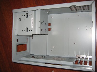

The case, now empty:
107.88 KiB
613 views
Guess I'll be looking for a nice MicroATX board...
