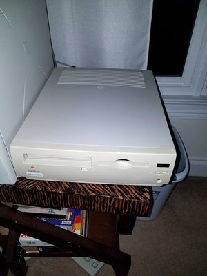

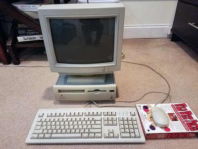

Came with monitor, 2 mice, 2 keyboards, complete system, and a bunch of software in boxes. Mostly old games and some autocad program. Actually, this is the first retro mac I’ve owned.
Slew of pictures https://imgur.com/a/lLStQ
Macintosh Performa 630CD with 8MB RAM, 250MB HD, 540MB LaCie external SCSI drive as well. Overall, pretty cool score. I want to replace the top cover, do a RAM upgrade and add networking.

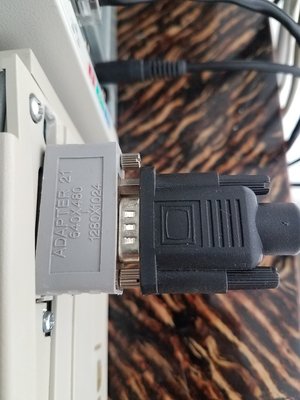

From what I can tell from googling, I'd want to make sure I get a keyboard and mouse with it, but that I can hook the machine itself up to a standard VGA monitor?
Reply 2 of 26, by oeuvre
I think you need an adapter to connect old Macs to VGA monitors but I'm not sure. Some older CRTs have support for both VGA and old Macs like my NEC Multisync XP17. Glad you liked the build; any updates will be posted here!
And yes, it works very well on a 15" LCD.

It looks like this

My Apple Multiple Scan 15 came with a DB15 to VGA cable much like the one squiggly showed.... because the monitor is actually a standard 1024x768 monitor, essentially.

I was about to post about the DB15 to VGA adapter trick, until I saw that you knew about it. 😀

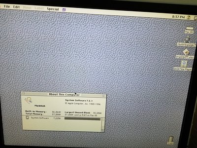

Reply 16 of 26, by oeuvre
RAM now up to 36MB (32MB + 4MB onboard)
