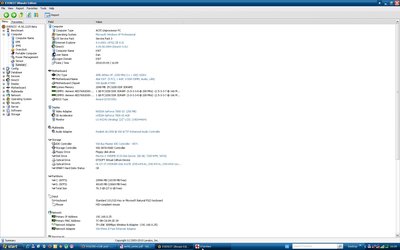

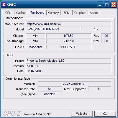

I have been busy at work but also at home bench-marking and testing games and after 2 weeks I can say that you are in for a big surprise!
I will start with VIA KT880 platform; the system is exceptionally stable and bug-free; the results are not influenced by the memory modules used - but during the course of the testing I used the Corsair; they are the same with Corsair, Kingston and AENEON modules so because the Corsair modules are used in the nforce2 system the KT880 is equipped with whatever I had at hand after the benchmarks have been completed!

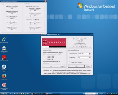

1. screenshots with the system:

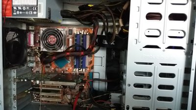

Reply 17 of 299, by nd22
2. Picture with the system up and running (I can not post more photos because they are over 2mb in size!!):
    1.66 MiB

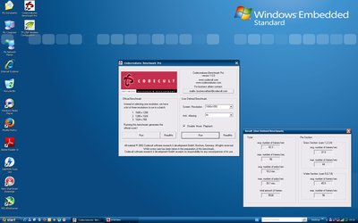

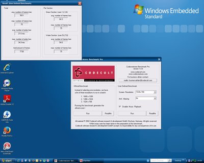

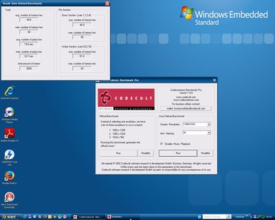

4. Benchmarks results for Code creatures pro; 3d mark 2000/2001/2003/2005; all tests have been done numerous times and every single time the benchmark have been set to repeat 3 times in order to get an accurate result; first screenshot is with the default settings except for the "repeat 3 times" option; the next are done at 1280*1024/1680*1050 resolutions with all the settings turned all the way up:
A. Code creatures Pro:

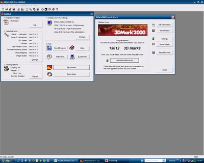

Reply 19 of 299, by nd22
B. 3d mark 2000 - you can see that the results are clearly CPU limited even at 1680*1050:
