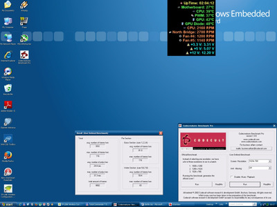

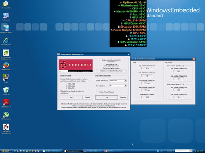

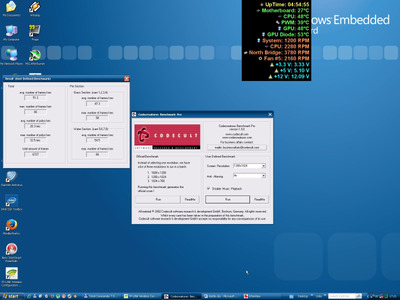

Reply 68 of 299, by nd22

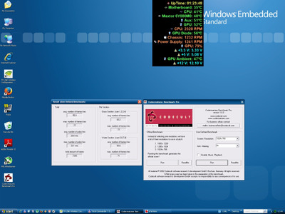

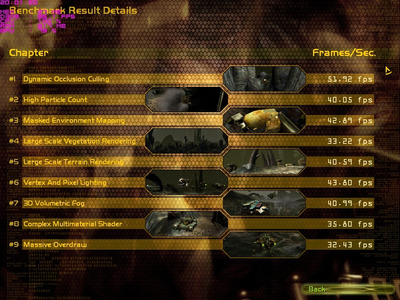

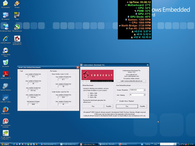

1. Code creatures 1024*768 default:
nforce2
229.34 KiB
762 views
KT880
155.88 KiB
762 views
First test and the first win for nforce2!

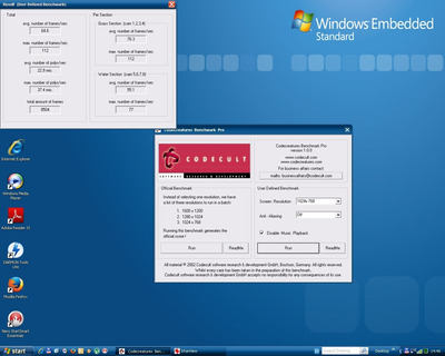

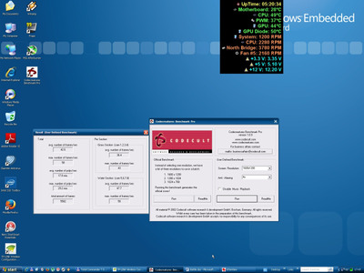

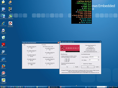

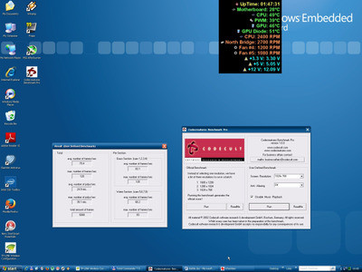

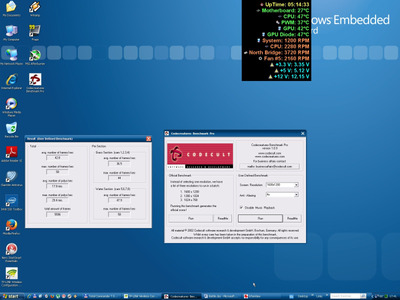

Reply 69 of 299, by nd22
2. Code creatures 1024*768 default + sound
nforce2:
223.48 KiB
755 views
KT880:
227.71 KiB
755 views
It seems that the Sound storm makes a BIG difference when taking into account!

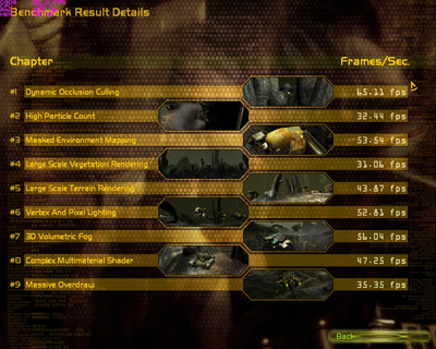

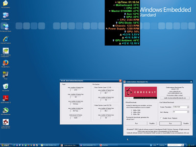

Reply 70 of 299, by nd22
3. Code creatures 1024*768 max
nforce2:
226.69 KiB
745 views
KT880:
157.93 KiB
745 views

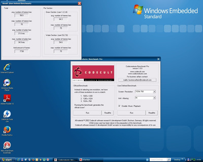

Reply 71 of 299, by nd22
4. Code creatures 1024*768 max + sound
nforce2:
227.34 KiB
744 views
kt880:
221.66 KiB
744 views

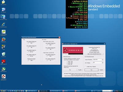

Reply 72 of 299, by nd22
5. Code creatures 1280*1024 max
nforce2:
214.34 KiB
743 views
kt880:
159.9 KiB
743 views

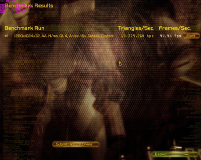

Reply 73 of 299, by nd22
6. Code creatures 1280*1024 max + sound
nforce2:
228.56 KiB
742 views
kt880:
220.35 KiB
742 views

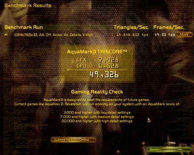

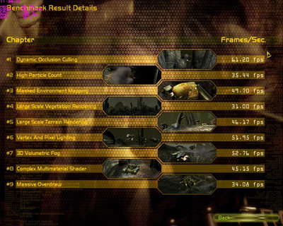

9. Aqua mark 3 1024*768 default
nforce2:
237.65 KiB
705 views
240.5 KiB
705 views
kt880:
311.33 KiB
705 views
318.94 KiB
705 views
NForce2 manages another win in Aqua mark 3!
