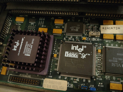

Reply 30 of 30, by PD2JK
lihinian wrote on 2018-02-21, 17:59:
Tulip TC38 machine
I like what you've done with it, my compliments. 😀
I would like to know if 33 MHz is possible, I have the same machine and maybe we can get it to run at 33/66/100 MHz with DX/DX2/DX4 respectively.
If you have time, can you make some photo's of the CPU? Maybe we need to relocate some resistors. Here is mine:
1.25 MiB
472 views
