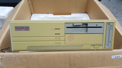

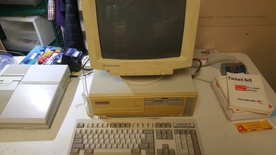

Zorix,
I have a Packard Bell 780 Supreme, I just restored, I got it still with the factory seal never broken, however it would not post. I had to break the seal, and found though
the inside was immaculate condition, the battery had done deadly puking on the board and destroyed some critical circuit runs. After attempting to repair with no
luck, i was able to find a PB Axcel 39CDT board, which was identical, i just had to swap the bios from mine to the new replacement board, and i did solder in a new battery on the new
board just to make sure. I did upgrade the processor from a 486sx 25 to a 486 overdrive 66
So basically I have the same thing you have, Luckily the hard drive is original and had all the factory software already on it
including the recovery imaging program with all the diskette images, I do have all the packard bell DISKETTE images for mine, which include dos , windows 3.1 , works, etc..
hit me up if you are interested in getting these. lots of 3.5 1.44mb floppies, but it will make yours factory again.

Reply 18 of 36, by Zorix
Hi There mperu99,
Nice machine you have there! I have the same monitor, but has the older Packard Bell logo on it. Just need the time to take it apart, clean it, replace anything that has gone bad, and restore the plastic.
I would definitely like a copy of the restore disks for that system, Thanks.
I hope you kept the original bad motherboard. If the board itself is beyond repair, the controller chips can still be useful for repair of other boards in the future. The north bridge, south bridge, ide controller, vga controller, etc.
Looks like your front plastic needs some retrobrite as well, it makes a huge difference. Also, I would advise you to have a look inside the power supply to make sure nothing has leaked, that could make things a lot worse over time.
I'm still working on the Legend 760 Supreme. I put in a lot of upgrades, a cd-rom, and even the floppy emulator. I'm designing a new project at the moment to replace the cd-rom, but it will be a while before that is ready.
I have a Legend 600X Supreme to work on next. The power supply was not repairable with my current skill. The switching transformer has a few shorted windings which won't allow the supply to start. Maybe one day I will rewind it. In the meantime, I have replaced the inside with a mean-well supply and converted it to AT. I need to 3d print some parts to make things sit right, so it's not fully assembled yet. I will make a new thread about the system, but the motherboard is also dead, but I should be able to fix it.
Thanks for sharing your Packard Bell, I always look forward to seeing those machines restored and taken care of.
Reply 19 of 36, by mperu99
Zorix,
The Power Supply is 100% , this system was not used long and then it was packed away, its like new basically. Yes, the plastic has yellowed, but the keyboard is still nice. I have yet to attempted to retrobrite, I have seen videos etc.. but not 100% sure if i will get it right. not sure about the amount of salon peroxide vs. water.. etc.
Though i also tend to like the yellowing affect, as it makes it more vintage/nostalgic. Yes, i kept the original board, i also have another PB410 board that i tried but it too will not post, even though it does not look like battery leaked very much, it still wont post. It did not have the blue overdrive socket, but it was clean, i think it has a short on the bus, just not sure, but i still have that board as well. I dont have a re-work station, so i couldnt do the component swaps if i wanted. but i tend to keep the boards or if i decide to sell my PB collection they will go with the collection. I have two PB fat base towers Legend 55 platinum and a Legend 1090 (I think its a 1090) the 55 is a pentium 133 and the 1090 is a pentium 166 MMX , i need 5 1/4 mounting rails , at least 3 pairs would be nice. that would put me at two pairs each system for CD drives or other 5 1/4 bay item. I dont have the means to make them , but i keep looking for them. Both of those post and i have even had windows 95 boot in safe mode on each. So at least they work and basically all there. I will eventually get the recovery CD's for them and make them whole again.
I also have a 486 desktop believe its a 20CD (which works) and also another desktop that is a 401CD i think. (I cannot get past the bios password, even though i have tried to clear it , the RTC chip is dead which may be part of the issue of trying to clear it. another board i am going to have to jack with. v
I also have a PB500 , very old 8088 , with a 8bit video card and a 8bit RLL controller and a Seagate ST138R , that i believe is bad (DUE TO DROP DAMAGE DURING SHIPPING) the seller made the mistake of turning on the computer to see if it powers up and did not know about parking the HDD before shipping. So as soon as i find another RLL drive I will attempt to make that one whole as well
As soon as i get a chance i will get the diskette images to a place you can download them and let you know .
