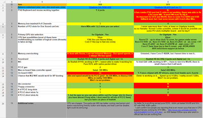

Because i made X79 working for pure Dos Sound i made X58 vs. X79 chipset comparision from multiboot view:
https://docs.zoho.com/sheet/published.do?rid= … 6e3c6dc17cafb36
Output in one picture:
101.02 KiB
2560 views
