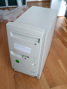

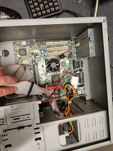

I just picked up an Aptiva 2158 with a K6-2 350Mhz, 64Mb RAM, and onboard ATI Rage Pro 8mb and ESS Solo-1. The eBay seller seems to be a bit of a retro specialist, and it was nicely cleaned up already, no sign of bad caps or physical damage, and even still charge in the coin battery. No hard disk though.
641.1 KiB
1174 views
Aptiva 2158
I've been looking out for an Aptiva for ages - this is a bit newer than the P120 sliding front tower Aptiva that was my very first PC as a kid, but my second PC was a self build with an ALi Aladdin Super7 motherboard and a K6-III, so it feels like it's ticking multiple boxes on the nostalgia front!
1.3 MiB
1174 views
Inside Aptiva 2158
For storage I added a generic Amazon 128Gb mSATA SSD in a generic AliExpress mSATA to 2.5" IDE adapter. This is split into 3 partitions, with Win98 installed on the first.
I've also already swapped in a 128Mb DIMM from another system, which has made it feel like it's running much more fluidly. Installing the final ATI graphics drivers from the AMD site also seemed to make a difference. Other drivers for the ALi chipset (IDE and AGP) and ESS audio are from the Vogons Drivers library. Also installed the Nubs36 USB drivers.
It doesn't seem super stable, or smooth running though. There are periodic pauses, which don't always resolve themselves - especially when installing software. It also occasionally locks up during boot (the scrolling blue white bar at the bottom has stuck permanently a few times). And I've noticed that if I leave it unattended for say 30 mins, it has tended to blue screen with a "Disk Write Error" (might that be some issue with power saving?).
This instability feels worse than other Win98 installations I've got running recently, and much worse than I remember my original ALi Aladdin V/ K6-III system having been in the late 90s.
Any ideas what might be causing the instability?

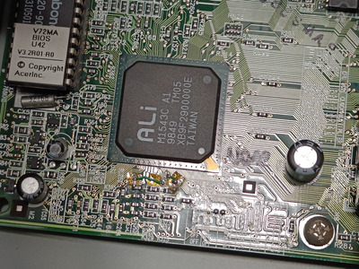

Thanks for the suggestions! I ran Memtest86 from a Clonezilla boot disc, and it passed fine. I had gone as far as completely disabling power management in the BIOS (back to "it is now safe to turn off your computer"!) but without luck.
I seem to have got to the bottom of it by removing the mSATA drive though. First I tried moving the actual mSATA drive to another adapter (the small PCB style rather than 2.5" drive format) but had exactly the same issues. After peeling off the "QA Passed" stickers though, it turned out both used the same controller chip.
Then I tried installing Windows to a 8Gb CF card instead, and had much better results. Everything was much smoother, fewer lockups, although I did have a blue screen about VMM.vxd when I installed the ALi IDE bus master driver (the one from the mirror of the IBM support site no less).
8Gb (the biggest CF card I had at home) seemed quite limiting though, so next I tried a 128Gb Samsung SD card (actually microSD) in one of the ubiquitous IDE adapters, again in several partitions with plenty of unallocated space. This has also been fine! (although perhaps not quite as snappy as the CF card?). I didn't bother with the ALi IDE driver at all this time, as I can still enable DMA without it.
So, the problem seems to be narrowed down to the mSATA drive itself, OR the ALi chipset not getting on with the controller chip on the adapters? I've used identical adapters in other retro systems with Intel or SiS chipsets without any of these issues. I guess I can test the drive in another system to see if it is the mSATA drive itself.
The only other thing I changed was using a rounded (80 wire) IDE cable - mainly because the spacing between plugs was wider. I don't suppose using a modern adapter on the old 40 wire IDE cable might have been a cause?

While changing the IDE cables over, I noticed this little patch of rework on the motherboard. Is it likely to be a factory modification, or has a previous retro enthusiast repaired something?
