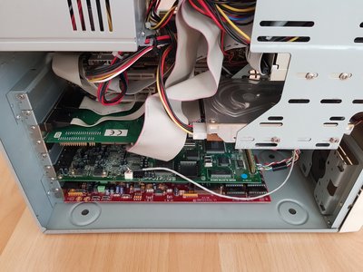

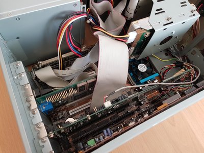

i collected so much pc parts from this age, i have built a pc from them.
Mainboard Jetway J-656C Intel 430FX
CPU Intel Pentium 133 SY022
RAM Samsung 72 pin EDO 60ns 16M x2
VGA Diamond Stealth 64 Video 2001 2M PCI S3 Trio64V+
Soundcard Gravis Ultrasound 3.74 1M ISA
Soundcard Creative Sound Blaster AWE32 CT3910 rev 01 ISA DSP4.13, CT1747 OPL3
HDD Quantum Fireball 1280M IDE
ODD Sony CDU-77E 4x CD-ROM IDE
FDD Mitsumi
Case Baby AT (Pentium style)
PSU FSP SPI-250G

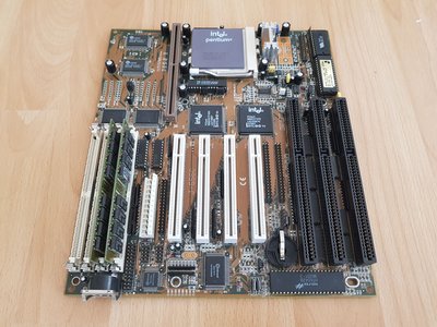

Jetway J-656C Intel 430FX (available from 1996, similar mainboards from 1996 q1).
i wanted a pc before the "classical" vx/hx age - with the first really good intel chipset, the 430fx triton. that was the only board what i found with real battery. it is not too fancy, but more practical. this revision of the board is a little bit newer, but with pb cache, the async cache was more typical at the fx boards (but it is still authentic in 1996 q1).

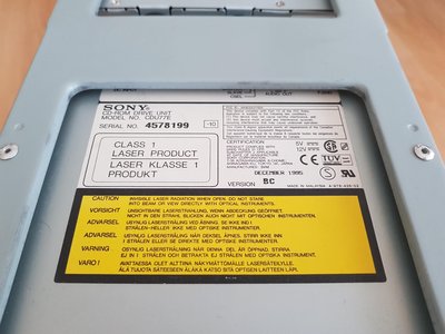

Reply 3 of 16, by arncht
Sony CDU-77E 4x CD-ROM IDE (available from 12.1995.)
552.4 KiB
2652 views

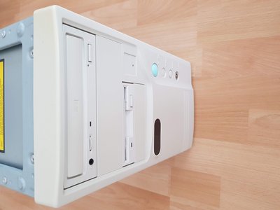

Baby AT (Pentium style - available from 1996)
a cheap case with turbo button, it fits to the age.

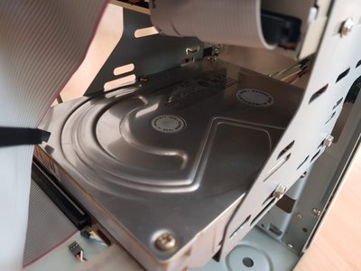

Reply 4 of 16, by arncht
Quantum Fireball 1280M IDE (available from 02.1996)
the mighty fireball w/o bad sectors - it was the fastest drive of this age.
357.51 KiB
2651 views

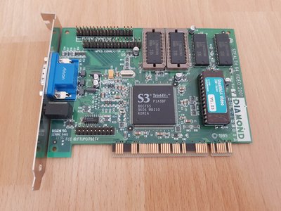

Diamond Stealth 64 Video 2001 2M PCI S3 Trio64V+ (available from 01.1996.)
the trio64v+ was new in the end of the 1995, later extremly popular on very cheap cards. just a mainstream card, but the most compatible and probably the fastest from 1996 q1. there is an extra connector.

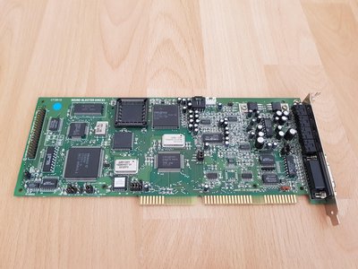

Reply 6 of 16, by arncht

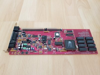

Gravis Ultrasound 3.74 1M ISA (available from 1994)
the latest gus classic, the best for demos. the earliest revisions from 12.1992, but this rev from 1994.
1.19 MiB
2649 views
Creative Sound Blaster AWE32 CT3910 rev 01 ISA DSP4.13, CT1747 OPL3 (available from 02.1995.)
value awe32 with opl3, but no memory slots (for dos is useless - i use msdos 6.22 for this computer)
