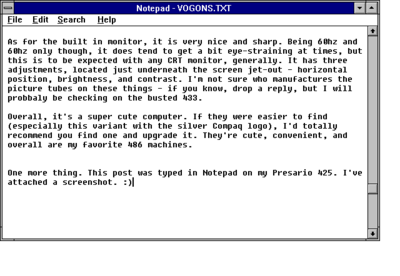

One more thing. This post was typed in Notepad on my Presario 425, copied over via floppy to my modern PC. I've attached a screenshot. 😀
(I pressed Alt + printscreen, and copied it into Paintbrush, so there is a white border around it, as it only captures the active window and not the entire screen. I also opened it in Paint on Windows 7 and saved it as a PNG so I could upload it)
Had to edit: I didn't know this machine had an Overdrive i486DX2 50 Mhz at the time I wrote this post, so I edited that in. Also, the original Compaq mouse is actually not very good. 🤣

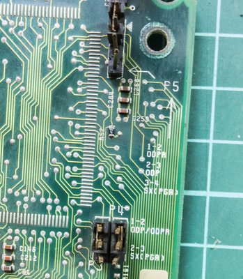

Hi. I also have a Presario 425. But I have a problem. I want to expand it with a dx4 to 100mhz, but the system becomes unstable. Can you tell me how you put the jumpers in your presario with a 100mhz dx4? Have you had to do anything else, apart from changing the processor and changing the jumpers? Thank you.
Hi, I have a Presario 433 upgraded twith a DX4-100 if you still need the info I can send a picture of the configuration Im using.

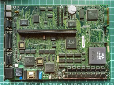

Hi sorry for this late update
Here is an image of my system mainboard

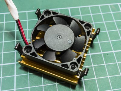

CPU cooler

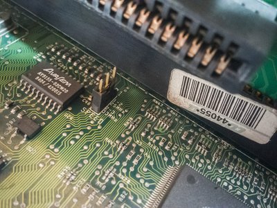

P1: 2-3 (33 Mhz)

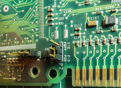

P2: 2-3 (PGA)

P3: 1-2 (ODR/ODPR)
P4: 1-2 (ODR/ODPR)
P5: 1-2 (ODPR)
908.08 KiB
3522 views
My system runs very stable
