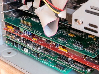

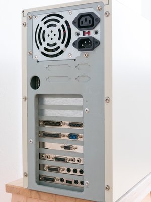

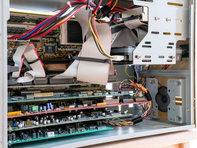

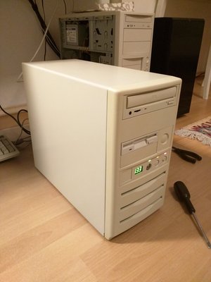

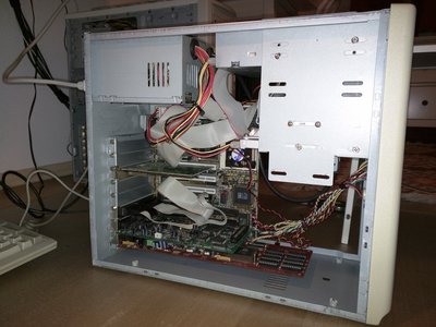

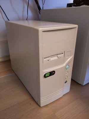

First post, by arncht
project started: jul 2016
targeted month: 1994.10
goals:
* dx4 with vlb
* cover the 1990-1995 period

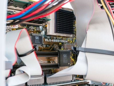

Asus VL/I-486SV2GX4 rev 2.1 SiS 85C471 ST
Intel DX4 100 WB SK096
passive heatsink
Sharp 72 pin FPM 60ns 8M x2
Hercules PowerDynamite 2M VLB Tseng ET4000/W32p

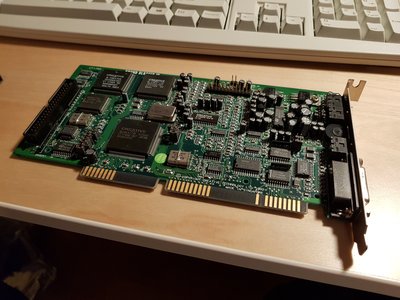

Creative Sound Blaster Pro 2.0 CT1600 rev 06 ISA DSP3.02, YMF262 OPL3
Gravis Ultrasound 3.74 1M ISA
Roland MPU-IPC
Roland MT-32 PCM v1.05 Control v2.00
Roland SC-55 Firmware 2.0

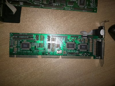

DTK PTI-265W VLB controller Winbond W83759AF
Western Digital Caviar 2700 730M
Sony CDU-55E 2x CD-ROM IDE
Mitsumi
Baby AT (Pentium style)

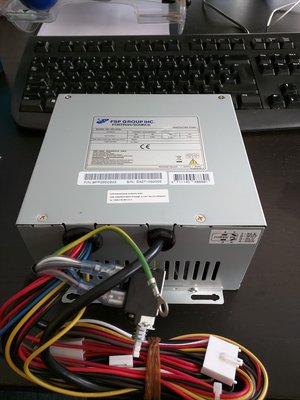

FSP SPI-300G
XT/AT 101 US
Logitech First/Pilot Mouse M35
Logitech Wingman Extreme
the photos are not about the actual status.

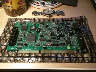

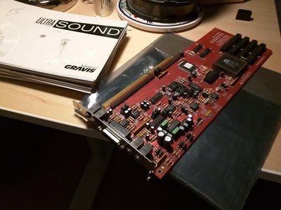

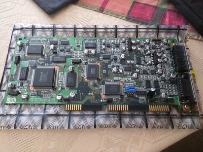

my two favorite sound cards from the past:
and a rare rap10, with gorgeous general midi.

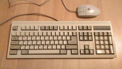

i have bought an 5x86, it was a typical eastern european computer from the early 1997. i really liked the case style, but it was too yellowish and had too much rusty spots.
i used it as a donor:
Mitsumi FDD
XT/AT 101 US keyboard
Logitech First/Pilot Mouse M35 mouse

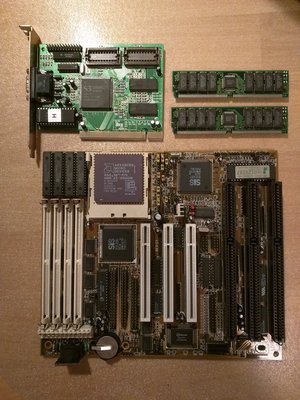

finally i found an asus sis471 board, i had very similar in the past. it was faster, than many pci board.
the mainboard came with a cpu with a glued heatsink. i did not really know the exact model, but i tried to jumper as dx4 write back cpu, and it worked.
the ide controller supported pio4, and nearly 1.5x as fast as the previous card.
Quantum Fireball 1280M IDE

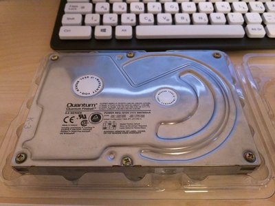

originally i planned an "1995" computer (i had it at the same time), and i remembered the first fireball, it was very fast.
this model with higher density platters from the early 1996.

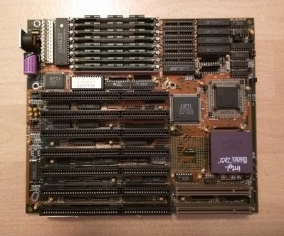

Dataexpert Opti-495SLC 3/486WB Cache rev 1.2 Opti 82C495XLC
AMD 386DX 40
Intel 486DX2 66 SX807
Motorola 30 pin FPM 70ns 1M x4
Goldstar 30 pin FPM 70ns 1M x4
i was also thinking about a 1993 dx2, but it was too slow - with the early vlb mainboard and an s3 805 card was just half fast than a late dx4 vlb.
maybe a sis461 could be better. benchmarks:
https://docs.google.com/spreadsheets/d/1eXksI … dit?usp=sharing
and yeah, you can put 3 cpus to this board at same time 😀

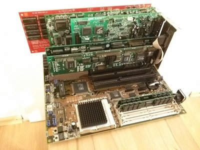

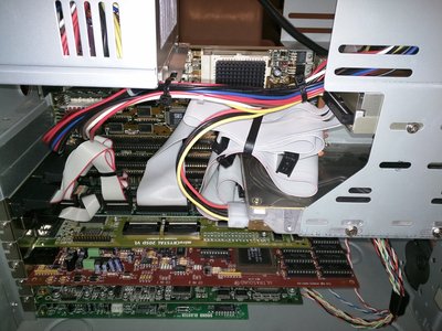

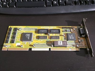

i was ready with the first version of my dx4 vlb. i could buy a miro s3 864 card, but the output was not perfect.
i have also bought another 486 from 1997 - the case was in a better shape.
the fsp psu is a very late at model with pfc and new (nos) with warranty.
miro Crystal 20SD VL 2M VLB S3 Vision864
Roland RAP-10 ISA
Mitsumi FDD

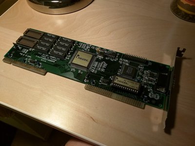

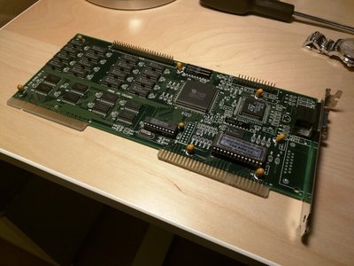

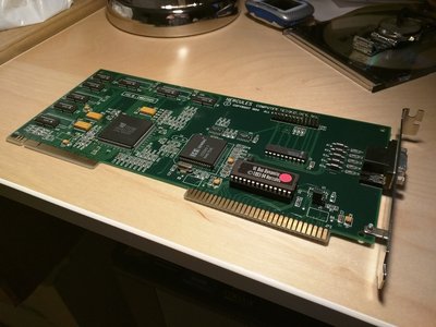

Tseng ET4000/W32p 2M VLB Tseng ET4000/W32p
a noname, and a hercules et4000w32p.
the hercules is a very late revision in a top notch condition with vibrant output.
the noname is also not bad, but it has a strange 1.0 vesa bios.

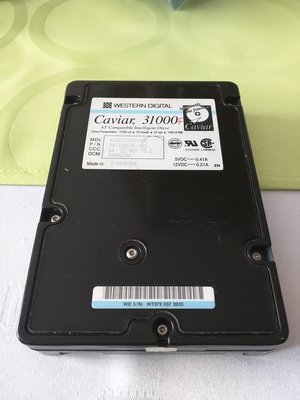

Reply 16 of 49, by arncht
aug 2018

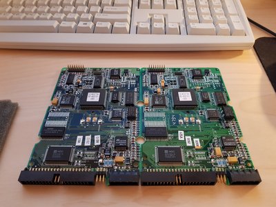

i was very happy with the 2.0 firmware, it is general midi compatible. i compared with the rap10, they sounds nearly identical.
i had to replace the sbpro2 with an sb16, but i found better the sbpro2+rap10 than the sb16+sc55.
Western Digital Caviar 31000 1000M
the biggest hdd from the end of 1994, without any bad sectors.
    466.9 KiB
    3206 views
    496.27 KiB
    3206 views

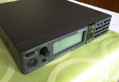

Reply 17 of 49, by arncht
jan 2018

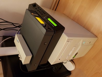

Roland MPU-IPC
i could buy an mt32 rev0, a little bit later an mpu-ipc midi controller. it is a really authentic pairing - roland sold them in one package in 1988:
https://books.google.at/books?id=fHghpJa3va4C … mpu-ipc&f=false
the ipc can control two midi devices directly, i could use the sc55 with the sbpro2.
    955.93 KiB
    3203 views

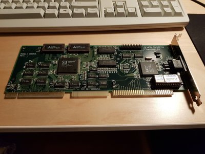

Reply 18 of 49, by arncht
feb 2018

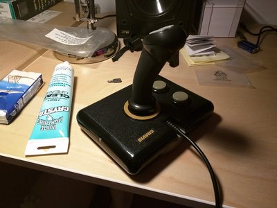

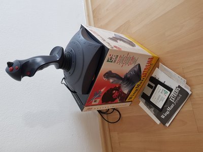

replacing of the gravis joystick, it is in perfect condition. from 1994.

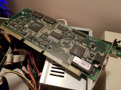

Genoa Phantom 64 2M VLB S3 Vision864
my hercules tseng started to freeze - it looks it has a contact problem, sometimes does not boot, etc. i got another vision864 from genoa. the card is not too nice, the output quality is washed out. go back to the ark logic.
Creative Sound Blaster 16 ASP CT1740 rev 04 ISA DSP4.05, YMF262 OPL3
a very nice first generation sb16 with a soldered asp chip and native yamaha opl3. it sounded surprisely good, but still prefer the sbpro2.
i tried to replace the board of the hdd, because it does not start. i know now, its heads stuck after a couple of weeks, if i do not use it. after knocking it starts again, but it is very unpractical at a build-in hdd.
i had to switch back to the good old fireball.
this is the twin brother of the another genoa - just in much better shape, and perfect output.
