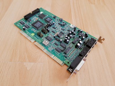

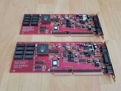

backup cards. the alternative ct1690 also can be good as a sony cd controller.
these gus pair had nicer pcb color, than my original gus - i replaced it.
Creative Sound Blaster Pro 2.0 CT1690 rev 02 ISA DSP3.02, YMF262 OPL3
Gravis Ultrasound 3.74 1M ISA

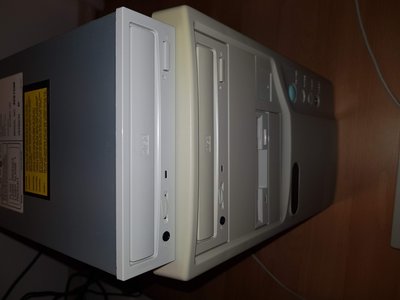

Sony CDU-55E 2x CD-ROM IDE
finally i found a good condition 1994 drive. it is less yellowish, than my 1995 sony drive!

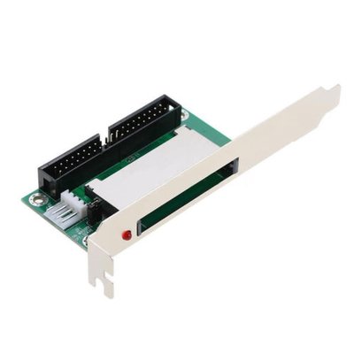

What operating systems are you running ?
With a CF card and adapter you could just swap out CF cards to load different operating systems, Not to mention that they are Silent, inexpensive and FAST.
Video
https://youtu.be/VWfTgga7rmA?t=248

Msdos622
I like the authentic noises 😀 it is the part of the computer.
Somewhere we build a vintage pc, because they are slow.

I use a conventional hard-drive too.
But I think I am going to switch to a CF cards because I want to enjoy the audio from the sound cards which is more important to me.
Also I think they are pretty cool and convenient. Better than a ZIP drive.

What I do is have a standard hard drive as C:\ for the authentic noises during boot.
and a CF card as my D:\ for all my games, where the sound isn't important anymore and speed is maybe a benefit.

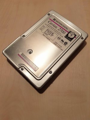

Western Digital Caviar 2700 730M
i hope without head stuck 😀 we will see after months.

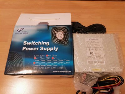

a NOS FSP SPI-300G PSU

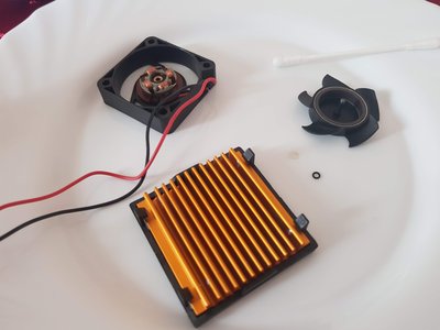

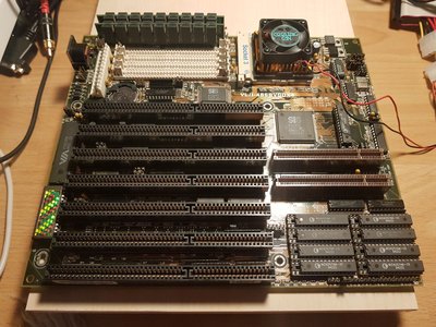

the Asus VL/I-486SV2GX4 rev 2.1 is my primary mainboard in my dx4 config. somewhere this is an "issue", because these boards from 1995/96 and i targeted an early dx4 config from 1994. i got a Asus VL/I-486SVGOX4 rev 1.2, maybe this the earliest asus mainboard for dx4 - it is prepared for the 3.3v cpus, but the bios (Award 1994.04.26) supports just the code names (p24c), and no lba support. i put the gx4 rev 2.0 bios (Award 1995.01.11) to this board, it looks fine. i would be happier, if i could use a late 94 bios with real dx4/lba support.
i have rebuilt the fan, the cpu is a intel wb cache dx4 (maybe i will replace with a more authentic wt version).

another backup from 1995 - opti895a, the bios id says "lucky star" (typical east european brand in the middle of 90s). i cannot identify exactly the model, but similar to 486 VL3 CACHE (MV035E). surprisingly the opti895a outperformed in more benchmark tests the sis471 - it looks the vlb timing is more aggressive. the default bios settings are very slow.
