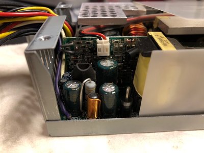

Power supply (Enhance brand) was dead on arrival, I will recap it but maybe I'll just order a replacement for now.
You can clearly see some bulging capacitors -- cheap crap.

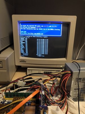

I then tested the motherboard a bit together with YMF744 sound card.
Windows XP and Dosbox in 640x400 looks pretty great on a CRT monitor.

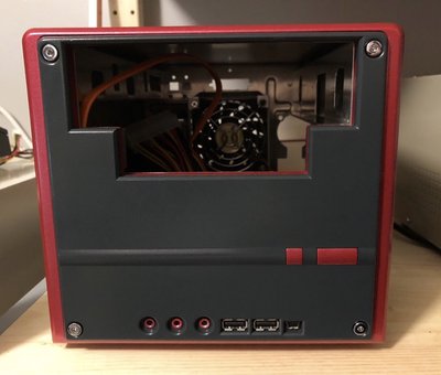

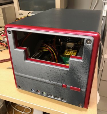

Did not like the color scheme so I decided to paint it, I went for two-tone anthracite grey / metallic pink.

Reply 1 of 6, by wiretap
Ahhh, you painted the hard to find plexi cover? You could have just put an inlay behind it like this.. I have a template for it you could have printed.
