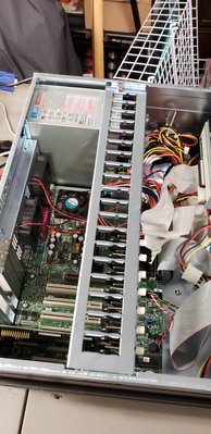

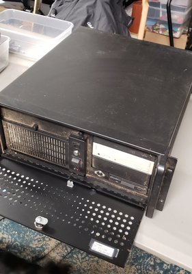

About 8-9 years ago, I bought a 32U 4 post rack, and it had three 4u servers in it. I'd gutted two of the servers and repurposed them as homes for Kentsfield Xeon machines, one as a storage server and the other as a VM host.
The old hardware wasn't useful to me and I didn't have much interest for that vintage at the time - Athlon 750, some PIII, etc. The guts were put on a shelf, which was then lost with a fire in my garage (and almost all of my other vintage stuff)

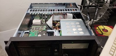

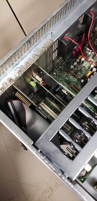

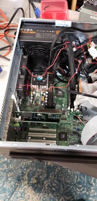

However, going through my shed, I found one of the old black 4U servers and opened it up. Socket 370, 512MB RAM, some garbage PCI video card, garbage NIC, and a sound card. No drives, they didn't come with those when I bought them.
Well, let's get to work. I can relive my teenage PC, but with much better hardware. 🤣

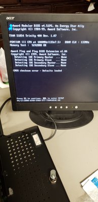

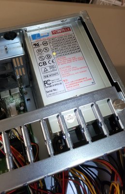

It wouldn't POST, and I got some tips on that, but honestly I didn't trust the PSU anyway. I ordered another one, and I ordered another video card from eBay.

    Old PSU

    Guts
    1.08 MiB
    2062 views
    The 4u

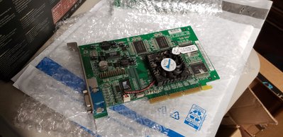

Got some good stuff in the mail today!
Old and busted
1.55 MiB
2061 views
Removed
1.54 MiB
2061 views
New hotness
1.84 MiB
2061 views
And what is this?!
1.59 MiB
2061 views
($12 GF2 GTS 32MB from eBay)

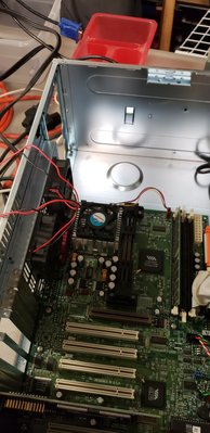

But what happens when I hit the power?!
1.26 MiB
2061 views
Hey, it's a 1GHz?! Sweet! I had no idea. One of the best PIIIs for ca. 2000!

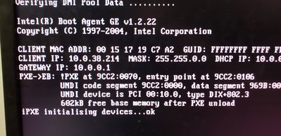

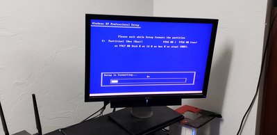

So the fun part. I really, really didn't want to burn a CD of XP. But making the Unattended boot system work didn't seem to pan out, and I wasn't very interested in setting up RIS. I found a spindle of CDs in my shed, and now I had some working media to go with my COA.
And basically the process for XP to iSCSI goes
  1. <XP> Install to HDD
  2. <XP> Install iSCSI initiator
  3. <XP> Install iSCSI Sanboot Thinger
  4. <Wherever> Copy image from HDD to storage server
  5. <SAN> Set up storage server stuff
  6. <XP> Boot from IPXE
Welp, let's get started I guess. I really wish I had taken the time to document the sources I used for this, but I'll probably go back through and do a writeup of this for my own documentation and benefit as well, so I'll hit that later. I had netboot.xyz set up on my network from a long time ago, so that was super handy here, as anything that tries to boot PXE on my network will take the netboot.xyz and run - which means they also get IPXE, and all I have to do is chain load the iSCSI definition for them to boot. Ta-da.
1.51 MiB
1734 views
IPXE Boot worked

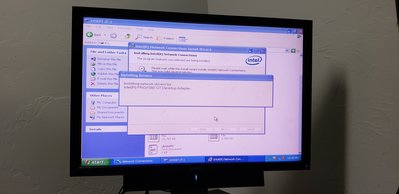

It's working! I had my 8yo son do all of the install while I did a right-seat.
1.8 MiB
1734 views
Network drivers going on via USB stick
1.38 MiB
1734 views
And the moment I was waiting for! This was much faster than the local disk...
I tried dusting it off with a feather duster but I'm afraid it's going to need a couple of wet rags or something, sorry xjas!
Now that it can live on iSCSI, I removed the HDD and buttoned it back up.

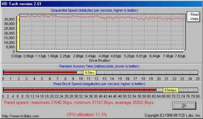

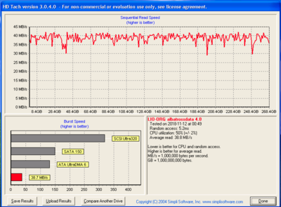

I'm running some disk benchmarks to gauge the performance of this iSCSI setup - the thing is sourced from a stripe of two Seagate 3TBs right now, so it can't be that fast. Plus not having DMA... I'm not expecting a whole lot. iSCSI is convenience, mainly, not really performance.
Benches seem to reflect it:
45.82 KiB
1506 views
44.73 KiB
1506 views
CPU usage is pretty high during that time, though...

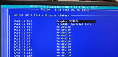

Reply 12 of 12, by JodieC

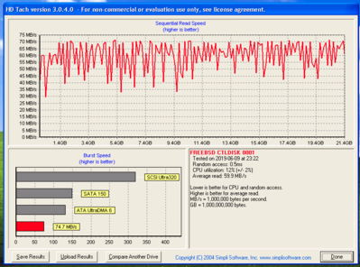

I reworked the FreeBSD PSCSI emulation using the CTL tools in FreeBSD.
The storage block device is emulated via PSCSI through the Adaptec 39160s on each end.
This seems much, much, much more robust and reliable than the scsi_target userland example. Doesn't hurt when it's decent for speed.
