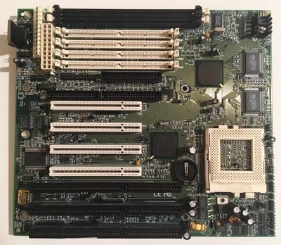

The "first draft" system specs will be:
CPU: Pentium MMX 200 (would upgrade to 233 if given the chance). Has a passive cooler (original cooler had a broken fan on it)
MB: Intel 430TX-based AT - 4 PCI, 3 ISA, support for SIMM and DIMM RAM, onboard IDE/floppy controller, onboard PS/2 mouse port

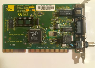

Network: 3Com Etherlink III (3C509) ISA

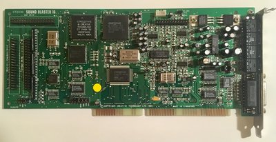

Sound: Sound Blaster 16 CT2230 (plug and play but can be initialized without TSRs)

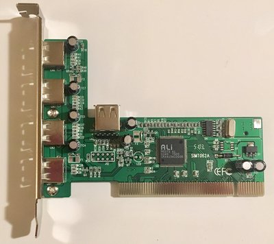

USB: brand new PCI USB 2.0 card, with EHCI and UCHI controllers, so I can use the plug-and-play USB drivers in DOS. A pity I won't get full USB 2.0 support in Windows 95, though. Almost makes me want to use Windows 98... almost. If I want to transfer files quickly, I'm pretty sure that DOS supports USB 2.0 with ASPIEHCI.SYS here: https://www.bootdisk.com/usb.htm - not sure if it is full speed though or even how well it works. I have two different USB cards I can try with different chips.

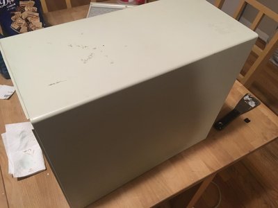

The case is just a generic short desktop tower AT case. It was very dirty and beat up when I got it. I've since cleaned it thoroughly and painted the outer side and back cover - it's drying right now and we will see if I like the color. The front of it, I can tell, is a little yellowed. I have yet to decide if it's bad enough that I want to try to fix it. Overall it's kind of a nice-looking case, proportionally and design-wise. It will go nicely on the lower shelf under my desk.

1. Should I use a PCI NIC? Do I need 100 mbps? I'm going to be utilizing the network for bare-bones Internet browsing Windows 95-style, but the bigger worry here is network shares. It would be nice to be able to transfer files over the network. Will I be kicking myself for not installing a 10/100 NIC? I guess I'm worried about compatibility. I know the 3C509 is easier to set up due to it being on the ISA bus, plus there are drivers for it for more DOS programs, etc. I have a 3C905, plus an Intel PRO/1000 card - woah. I don't think I need gigabit speed here. This is 1995, after all.

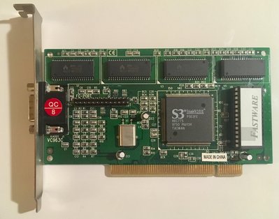

2. The video card. I'm a little worried about the S3 Trio64V2/DX being underpowered for the PMMX/200. My problem here is also compatibility. I have some ATI Rage XL cards, which I know will do fine in Windows, but I also have a very bad opinion of ATI cards due to their horrible compatibility in DOS. I would try for a Matrox Millennium, but again, DOS compatibility there sucks. Maybe what I really need is a Voodoo, but those are hard to come by and I don't think I'll be playing many games that would need it. Most of my gaming will be DOS-based and Windows will be used for productivity.

Firstly, pictures of the parts:
MB (Intel 430TX):
1.39 MiB

NIC (3C509):

USB (EHCI/UHCI controller):

Video (S3 Trio 64V2/DX):
734.27 KiB
1260 views
Sound Blaster (SB16 CT2230):
885.37 KiB
1260 views

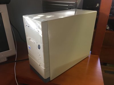

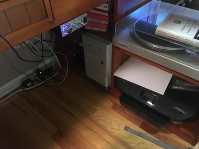

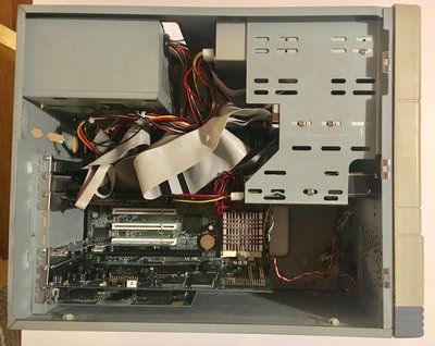

Reply 2 of 12, by keenmaster486
Other pics:
After thorough cleaning, tearing everything out and putting it all back in with the final configuration:
1.04 MiB
1258 views
Case before painting:
824.98 KiB
1258 views
After painting and put back together (not sure I like the color. It was Rustoleum Almond, intended for painting on metal surfaces, which is what this is, but I think I'd rather have a lighter color. I dunno.)
791.81 KiB
1258 views
Goes nicely under the desk:
987.9 KiB
1258 views
First boot (and here you can see the Trinitron, the picture on which looks very good, though you have to manually adjust it):
887.73 KiB
1258 views
Next up will be software installation.
World's foremost 486 enjoyer.

  • Replaced ISA 3C509 NIC with a PCI 3C905. Same compatibility across DOS/Win95 but 100 mbps hard-wired connection which is nice. The ISA NIC will go in a future DOS only build, hopefully.

  • This particular MB has built-in USB, a UHCI controller. The DOS PnP (yes, PnP!) drivers I have (for printers, etc) require UHCI, whereas my USB 2.0 card is OHCI+EHCI. I'll keep the USB 2.0 card for fast file transfer reasons but I need the UHCI controller so I can plug in a USB keyboard if I want (yes, the BIOS supports USB keyboards) and also my modern HP printer so I can print with those DOS PnP USB drivers.
