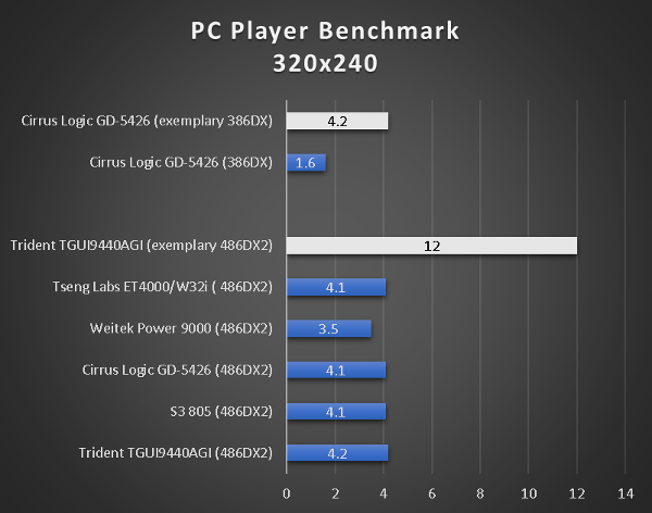

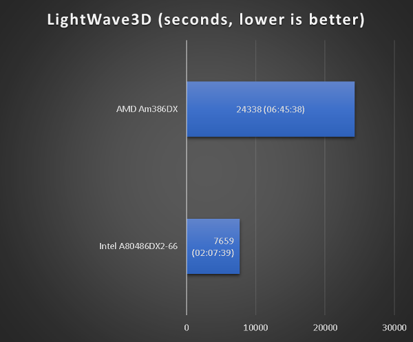

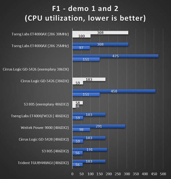

Postby pshipkov » 2019-7-02 @ 13:43
The original post was about building exemplary retro PCs, but since then i spent some time playing with hardware from the other side of the spectrum - the underperformers.
Accumulated enough data and decided to update this thread with it.

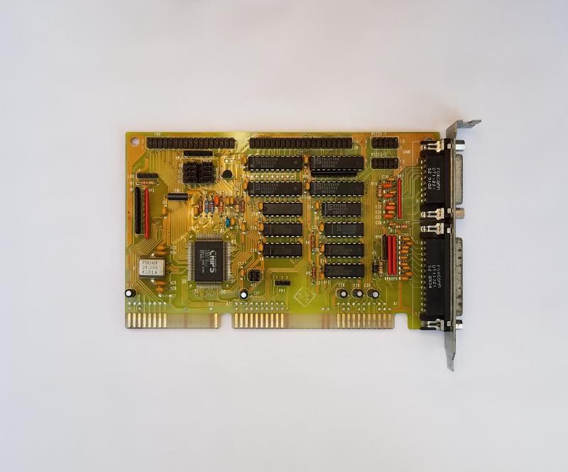

    i/o: AHA-1520A
      Unknown, FDC37C65B

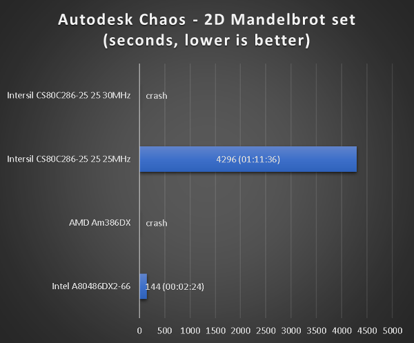

Coretest for SCSI freaks-out when the CPU runs at 25MHz.
The Harris CPU does not overclock at all - anything above the default 20MHz is a no go.

THE CULPRITS
http://petershipkov.com/temp/retro_pc_images/components/286_2_motherboard.jpg (featuring the Harris CPU)
http://petershipkov.com/temp/retro_pc_images/components/286_2_et4000ax.jpg
http://petershipkov.com/temp/retro_pc_images/components/286_2_ide.jpg
http://petershipkov.com/temp/retro_pc_images/components/286_2_adaptec.jpg
http://petershipkov.com/temp/retro_pc_images/components/286_2_io.jpg

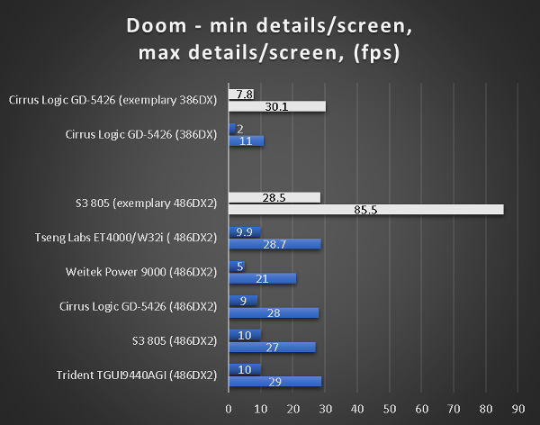

This motherboard is a top underperformer.
Initially i thought it may be unoptimized BIOS, but trying 30 other BIOS-es strongly indicated that the problem is the hardware itself. From past experience - if the hardware is ok, some BIOSes can improve its performance at least partially. Not this time around. There is a real log jam somewhere in that mobo.
SpeedSys memory metrics indicate no cache, which is strange. Tried different sets of chips to eliminate the chance of faulty ones - no bueno. This seems to be the main issue of the board.

Another impressive underperformer.
Kind of strange, because exactly the same chipset is used successfully by Asus and other manufacturers in very fast motherboards.
Visual inspection and comparison with such motherboards confirms that the hardware components match. So it must be the BIOS then.
Tried over 40 different BIOS-es. Started with ones from other SIS 461 based boards, but at the end the one that finally "clicked" was an UMC BIOS. Unexpected i admit, but the mobo woke up. VGA and IDE performance was where i expected them to be. The only trouble was an apparent disagreement between the BIOS and the memory controller about the amount of installed RAM. So, they settled on 1MB only.
The system does not boot at 40MHz FSB.
Cannot find manual for the CL combo board. Its default IDE performance is the same as the GoldStar Prime 2.
Also, there are memory expansion slots - any idea what chips should go there ?

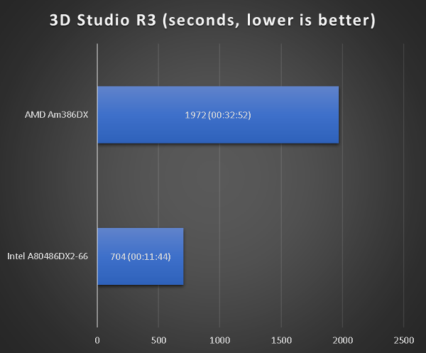

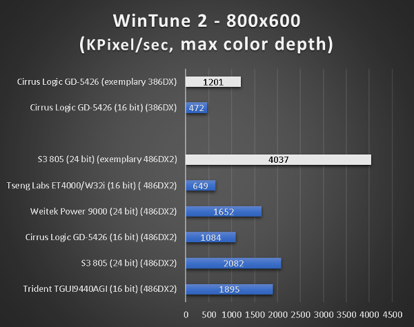

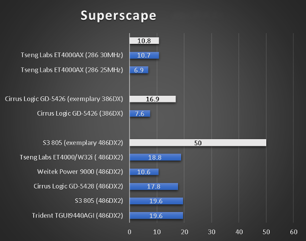

BENCHMARKS
Image Image Image Image Image Image
