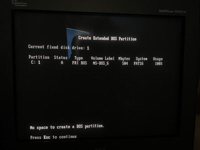

Reply 1300 of 2164, by Chadti99
pshipkov wrote on 2022-08-28, 19:19:
of course you can create more partitions.
they can be uup to 2gb. Just the first one is limited to 512mb for maximum compatibility.
I would agree but fdisk days otherwise.

Reply 1302 of 2164, by pshipkov
@chadti99
you should be able to create more partitions from fdisk option 2.

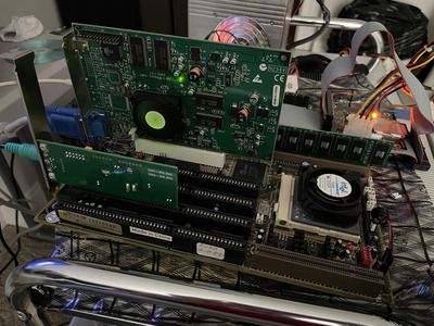

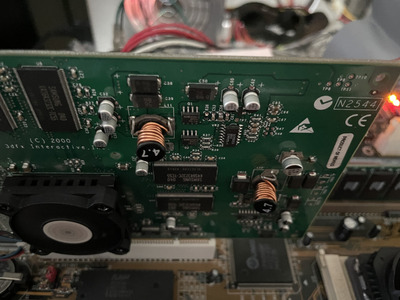

Reply 1316 of 2164, by Chadti99
Just tested the Voodoo3, it kicks the monitor on but never displays anything.
I’ll run more tests later this evening.
@feipoa, this is a voltage modded POD and it’s usually happy at 4v but now I’m remembering someone said the 4v setting on the m919 actually delivers less than 4v, so maybe that’s the issue.
Thanks for the note about POD and L1 WB, a shame really, could of been a performer.
The Award bios seems fine if you don’t want to use VLB graphics or a POD@100. So an AMD@180 with PCI graphics would be a good use case, no messing with jumpers to get full speed on PCI.
Reply 1317 of 2164, by Chadti99

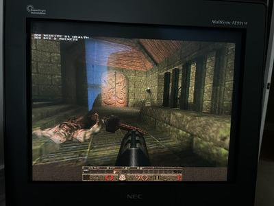

Trying the Voodoo4 once more in Windows on the M919.
Checking my posts in the “486 Overkill Graphics” thread I did manage to get this card working on an LSD but was also having similar power related issues. Maybe these socket 3 boards or my PS just can’t deliver enough amps. I mean look at the Tesla Coils hanging off this thang.
1.84 MiB
1610 views
Reply 1318 of 2164, by Chadti99
Yep, so I ran GLQuake for about a minute and black screen.
