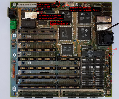

Hi, I've got a similar board (mine has SIPP) but I'd really like to know the jumper settings/definitions.
Do you happen to know what model motherboard this is?

Reply 186 of 2164, by pshipkov
This is what i know (and don't know) about the jumpers. Hope it helps.
Apparently these boards were available in Australia.
Remember at least 4-5 references related to your region.
    350.76 KiB
    2320 views
