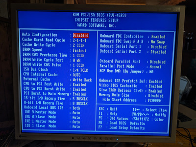

Added BIOS screens.
Your values are significantly inflated indeed. Do you remember what use cases required it ?

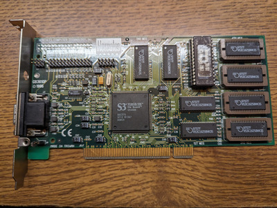

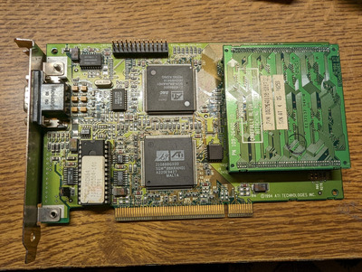

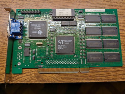

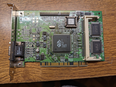

I got some more PCI graphics cards for the the good old Asus PVI.
So my setup is still the same. 40MHz, Am5x86 @ 160MHz. Everything on max.
For now I tested only under DOS, not much time today. I ran some benchmarks and checked picture quality (on my old 19" EIZO TFT)
Biggest differences can be seen with Wolf3D, I list only this for now:
Hercules Terminator 3D / DX   110.5
Miro 40SV 102.9
ATI Graphics Pro Turbo 4MB 107.1
ATI Rage Pro PCI 4MB 111.2
The Hercules is good under DOS, picture quality OK (no jailbars), but in DOS everything was grey instead of black. A bit annoying.
Miro 40SV has very good picture quality, but is slower than all the others in DOS.
ATI Graphics Pro Turbo 4MB VRAM: Some "running jailbars" during the boot, also in 320x200 dos games. One auto reboot in a Wolf3D run, so probably not stable
ATI Rage Pro: Nice surprise: I was afraid that card might be too new for the 486 board, it is definitely not. Very good picture quality, also a tiny bit faster than the others.
I will give the ATI Rage Pro a try under windows 98SE, I believe it has a built in 250MHz RAMDAC (not sure though), which would be better than the Miro S3 968 one.
But anyway too high resolutions do not make so much sense on a 486 machine, because it kills the desktop performance.
I am quite convinced that I don't have to set cache write cycle to 3, but let's see later.

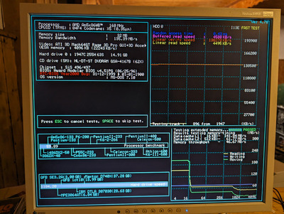

Reply 1946 of 2164, by CoffeeOne
I started Windows 98SE with the ATI Rage Pro.
Picture quality is good, but I kept 800x600 in order to be comparable with my previous tests.
Wintune 2 800x600 16bit: 11695 (let it run 5 times and took the average). So it is still a bit slower than the optimized S3 868 VLB.
BUT: 800x600 32bit is only a tiny bit slower: 11120
So the Rage Pro for sure beats the S3 in true colour.
Machine is 100% stable, I ran this Lightwave 3d run from pshipkov.
Please also note that I did not see an IRQ assigned to the graphics card under Windows 98SE.
My previous comment about ATI Rage Pro being too new for Windows 98SE was a bit stupid. The card is from 1997, this version from Win98SE is from mid 1999.
So actually the driver installation works fully automatically, it detects the card, installs drivers. Very nice.
I attach also the BIOS settings, and a screenshot from speedsys. Interesting about the speedsys results is the relatively low harddisk speed. I use the onboard IDE controller + XT IDE Bios + Compact Flash cards Transcend 16GB.

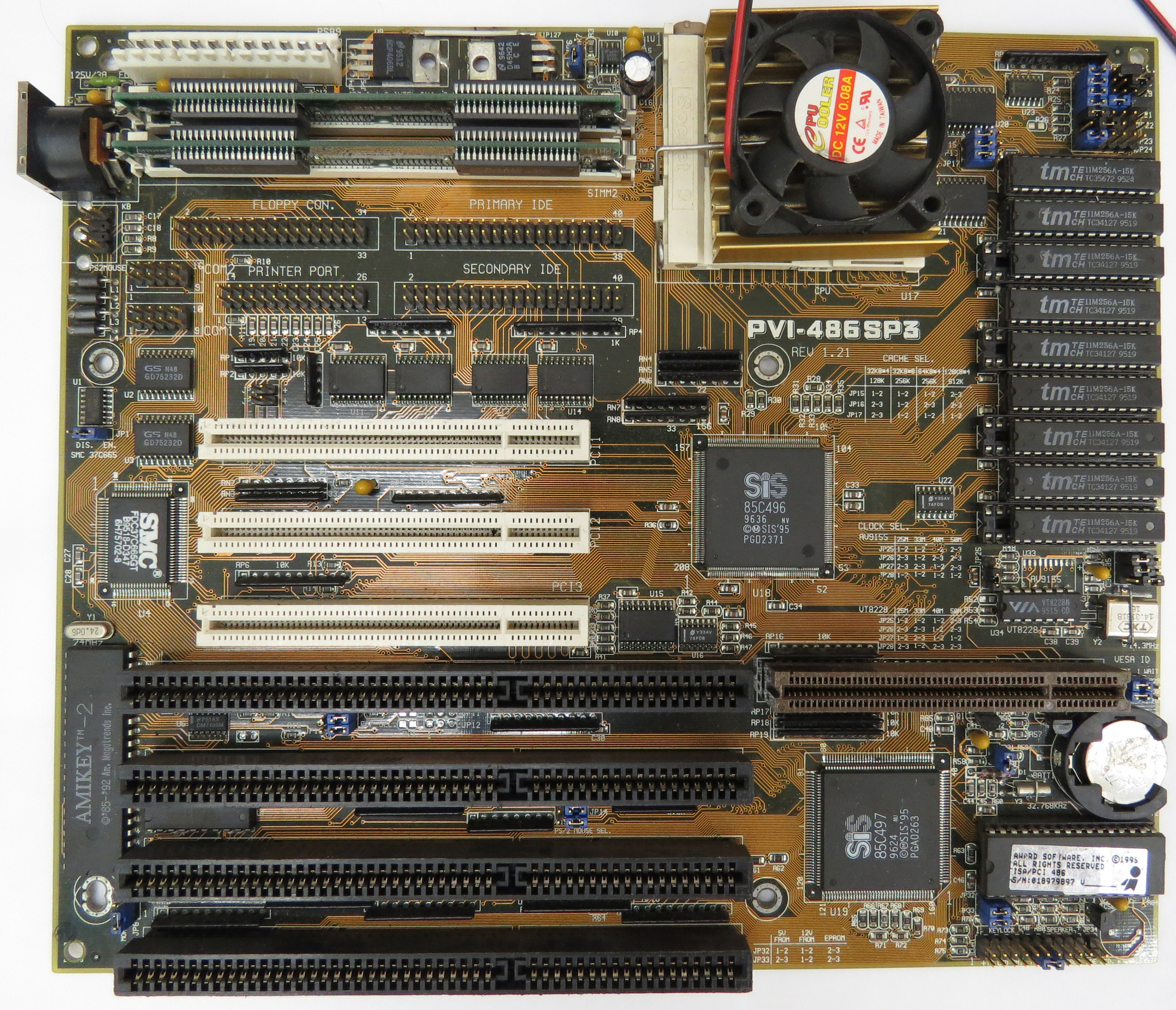

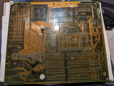

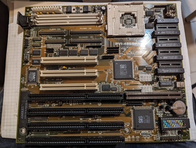

CoffeeOne: Are you willing to share an image of your full board? I see a snipet of your board here: download/file.php?id=171823&mode=view
It shows your board rev. is 1.2, and contains:
85C496 NU
Pshipkov's board, shown here https://www.petershipkov.com/temp/retro_pc_im … motherboard.jpg , is rev 1.22, yet contains:
85C496 OR 9541
85C497 OT 9541
My board is rev 1.8, yet contains:
85C496 NV 9617
85C497 NU 9616
pshipkov wrote on 2023-09-29, 15:34:
Version ID is not a fraction.
It is usually composed by major.minor numbers which are independent from each other.
Both boards are major version 1. The one here is minor version 22, yours is version 8.
It seems strange that version 1.8 contains the newer chipsets. I speculate that v1.8 was the PCB revision that they sold last because of the chipset dates. I think the major changes in this revision were to limit use of the 50 MHz FSB, which is why it is removed from the silkscreen. Thus, whatever the case may be with what the convention is for major.minor revisions, I don't think a larger minor revision number necessarily translates to the newer PCB. With also see this discrepancy with the Cyrix 5x86, that is S0R5 is newer than S1R3.
Based on an average of chipset datecoes found online for the PVI board, it looks to me as if the PCB's were released in this timeline, from oldest to newest: v1.22, v1.2, v1.8
The issue I had with needing to have the Cache Write Cycle set to 3, or otherwise half the hardware goes missing from the Device Manager, is still troubling me. I'm wondering if it has any thing to do with chipset versions, since aside from the FSB changes, I see no change to our PCB layout or components.
Pshipkov, are you still using the PVI board shown on page 1 of your thread? Or are you using a different board now?
I do have a pair of 85C496 OR, and 85C497 OT sitting in a bin from a desolder I did years ago and was wondering if I should place them onto my PVI rev 1.8 board in hopes of resolving this issue.

feipoa wrote on 2023-11-13, 23:09:
CoffeeOne: Are you willing to share an image of your full board? I see a snipet of your board here: download/file.php?id=171823 […]
85C496 NU
85C496 OR 9541
85C497 OT 9541
85C496 NV 9617
85C497 NU 9616
Here is a picture
1.88 MiB
1047 views

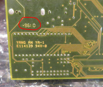

Reply 1952 of 2164, by feipoa
CoffeeOne, thanks.
pshipkov wrote on 2023-11-14, 00:59:
i remember looking at this before while trying to make sense of the assembly versions. if you run broader search online you will […]
if you run broader search online you will notice that chipset and motherboard versions are all over the place.
there is no apparent pattern.
it can be something arbitrary like the fab(s) picking whatever chips they had on the shelf at the time of fullfilling their orders.
If you've seen rev. 1.2 with a 1996 chipset datecode, could you share the image resource? From the photos I rummaged thru, 1.2/1.22 largely came before rev. 1.8. Since the only official 50 MHz FSB running CPU was an problematic Intel 486DX50, I can see why a later model of the PVI motherboard would try to cover-up the 50 MHz FSB setting as they have. In late 1995, it would not make since to first produce a motherboard without a 50 MHz FSB, then some months later, try to add a 50 Mhz setting. People using a DX50 were usually trying to use it on a late ISA-only board, or at the latest, ISA-VLB. Not a PCI board.
To help clear this up, could you (pshipkov & CoffeeOne) read me the datecode on the bottom of your PCB? It is on the bottom of the motherboard, very close to the BIOS chip vias.
My rev. 1.8 board shows 96 10.
However, the obfuscation of the 50 MHz FSB setting still does not explain the discrepency in our results for my case of the Cache Write Cycle needing to be set to 3, or half the hardware disappears from the Dev. Mgr. I noticed that both your boards have different chipset revisons than mine, so that is what I was thinking to swap. Alternately, rev 1.2/1.22 may have slightly different values for resistors or other components. On the UUD board, I did notice that different versions had different values for a resistor used for impedence matching, specifically at the position for the CLK signal after the line driver.
I dont think the BIOS microcodes implement EDO RAM support, do they ?
Can somebody with PVI SP3 and N# chips confirm ?
I think 85C496 PR is needed for EDO. I don't have any spare PR Northbridges. I'd be surprised if the BIOS had timings available for EDO memory, but its possible the firmware engineer added it as an overengineering step, like to prevent having to add it later on.
Reply 1953 of 2164, by pshipkov
Ah, right PR, not N#.
revision 1.21 with chipset date 96 36 (this is the latest i have seen to date)
https://forum.maxiol.com/index.php?s=40b28c41 … pe=post&id=7646
I don't see any numbers on the back nearby the BIOS location on the two boards here.
Btw, what you mean with obfuscation of 50MHz ?
The jumper configuration is printed on the silkscreen.
I think i mentioned it before that i remember hitting the Cache Write Cycle = 3 issue at some point, but cannot remember under what circumstances anymore.
retro bits and bytes
Reply 1954 of 2164, by feipoa
pshipkov wrote on 2023-11-15, 06:58:
Ah, right PR, not N#. […]
I've never seen a v1.21 before, but does the northbridge on that board look like it was repalced, perhaps because it came with a really old variant of the SiS chipset? In this thread, user shock__ said he was intending to replace his chipsets on this very PVI board because they were older revisions. Asus PVI-486SP3 // PCB vs. Chipset Revisions
Here's another rev 1.22 with an even older Northbridge datecode of 9524: https://www.amibay.com/attachments/3-jpg.1592213/
From my experience with M919 and UUD boards, the PCB revisions loosely follow a trend of increasing IC datecodes. Looking at all the other IC's on my rev 1.8 and they all have 1996 datecodes (VRMs, Super I/O, PLL, 7400 series IC's, BIOS EEPROM), while your board's IC's are 1995.
However, it's really hard to say what is going on with these PVI revisions. It is possible that the v1.22 are the later versions, but only because Asus insisted that htey contain the OR/OT chipsets, which at the time, could be in short supply on later datecodes. To assist in this investigation, it would be helpful to see the PCB datecodes. Mine is as follows:
197.86 KiB
988 views
Depending on which orientation you view the datecode, it could read either 9610, or 0196. I'd assume the orientation of the datecode would correspond to that of the YANG AN YA-1 markings, so I say it is 9610.
The obfuscation of the 50 MHz FSB setting may only refer to rev 1.8 because this is the revision which has the silkscreen removed for the 50 MHz FSB setting. To ensure that the user still could not set 50 MHz using the jumper settings from the manual, they have flipped the jumper settings for 50 MHz on rev 1.8. More on that was posted here: Re: Asus PVI-486SP3 v.1.22 and 66MHz FSB
So Asus really did not want people using 50 MHz on rev. 1.8, which makes the most sense to me if rev 1.8 was sold revision of this motherboard. I suspect the revisions printed for this board may be a decimal fraction.
Do you recall which BIOS version came on your PVI board? This could shed some light as well. I think mine originally had v305 or v306.
Reply 1955 of 2164, by pshipkov
The soldered pins look too regular for the home hack jobs we do, but who knows. It is possible.
oh, wow. I actually participated in the thread you linked first.
Notice the chipset revision list i provided.
Now it is coming back to me.
OR/OT is the latest stepping.
All 1.22 revisions are with that stepping.
Previous revisions are mixed grill.
This was the main clue i followed while trying to make sense of the PVI revisions.
There is no such marking in that area on the boards here.

Makes me wonder why SiS 496 NV/NU (rev. B4) datecodes generally went much later than the OR/OT (rev. B5) datecodes. Was there some issue with OR/OT? Were they more difficult/expensive to produce?
If I pickup this board again, and my solder paste is still new enough, I may do the chipset swap to see if my issue is resolved. However, my spare OR/OT came from a dead board, so it is risky.
But then CoffeeOne has an even older NU/NS date code from rev. B2, but then he was testing with w98se. Maybe this issue doesn't exist with w98se. More testing needed.
Reply 1957 of 2164, by CoffeeOne
feipoa wrote on 2023-11-15, 03:48:
CoffeeOne, thanks. […]
CoffeeOne, thanks.
I don't know exactly where the datecode is ....
1.84 MiB
914 views
Reply 1958 of 2164, by feipoa
CoffeeOne, your datecode is on the top right corner. 9508, so more than a year older than my PCB. Maybe pshipkov's datecode is also in this location?
