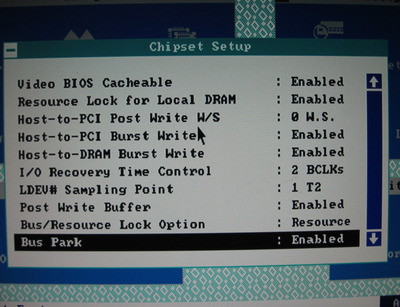

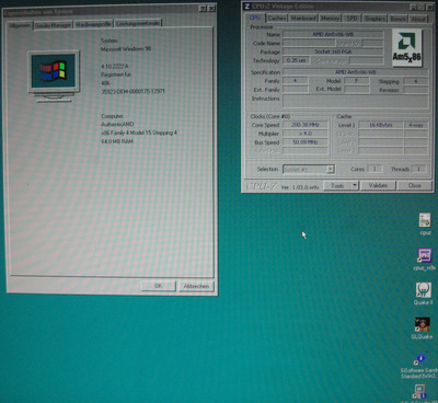

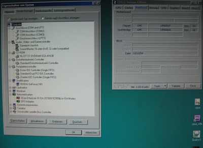

Finally after a long, long time of testing, it was possible for me to made a really stable and extreme fast 486-system with an UMC-chipset.
ALL mainboards Shuttle HOT-433 and ECS UM8810-PAIO in the past time I tested are NOT stable at FSB 60 and 50 MHz – regardless of their revision, regardless of using EDO- or FPM-RAM and under any BIOS-conditions! I tested them with an AMD 486-DX5-133 ONLY, so I can not be sure for their (in)stability with other CPU-Models at this time. The problems I had are shown in this thread (Modern graphics on a 486), there is no need for description once again.

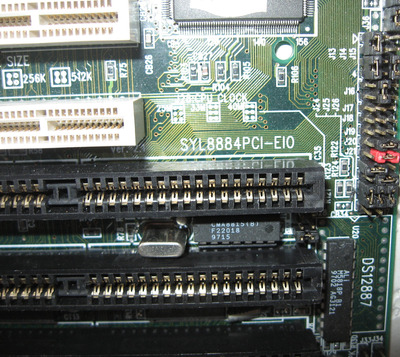

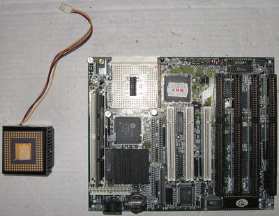

The instability-problems END for me with another mainboard (I never had before) shown and explained very well in this thread: 486 mobo + 586 chip
It is a „very young“ 486-board SYL8884PCI-EIO, with an UMC-chipset made in 1997! Maybe this is the reason for stability, I really don't know.
ONCE AGAIN: THIS BOARD IS ROCK STABLE AT FSB 50 MHz AND 60 MHz (at least with the AMD-486-CPU) – THEY ARE ABSOLUTELY NO PERFORMANCE-DROPS FOR THE CPU IN WINDOWS!
From this board they exist some different models from different manufacturers, so they vary regarding the jumper-settings a little bit.
The good: it works with EDO-RAM, has a CR2032-cell and a PCI-Generation of 2.1.

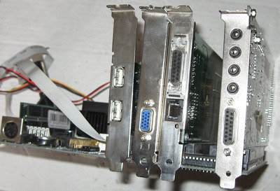

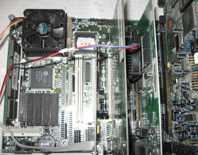

The bad: ugly onboard-IDE-controller, no PS/2-support, bad layout for the place of the both COM-ports (very difficult for using of PCI-cards because of collision, if one or both COM-cable(s) is/are used)

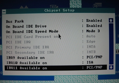

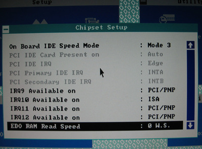

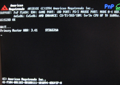

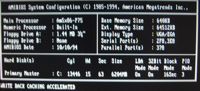

The onboard-IDE-controller does work fine for my board with 2 (two) IDE-devices only, and at PIO-mode 3 (not 4) for a FSB of 50 or 60 MHz (PIO-mode 4 causes crashes/freezes during booting of DOS/Windows at 60 MHz FSB; at 50 MHz they occur errors inside of Windows).
Apart from 3,3 V and 5 V, my mainboard does not offer CPU-voltages of 3,45 V and 4,0 V, so I had to find and use an AMD-486-DX5-133 which can work at 5 V. And I was lucky – I found one working at this voltage at 200 MHz at FSB 50 MHz!

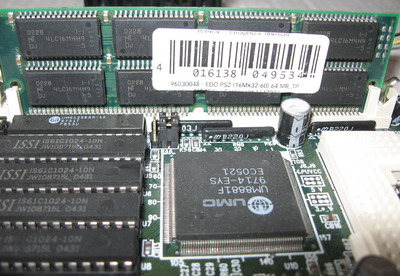

The L2-cache is 512 KB, the modules are 10 ns (only the TAG-module is 12 ns – at this time I do not have one with 10 ns).
About the RAM: shown in the pictures is the very one EDO-RAM-module of 64 MB at 50 ns, which works fine with this board. I had no luck using one or two double-sided modules with 32 MB each (two different brands).

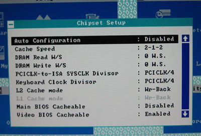

So in conclusion it is possible to run the system with all BIOS-settings set at their fastest/maximal values without errors and problems! 😉

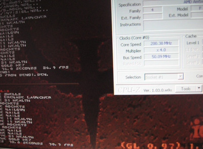

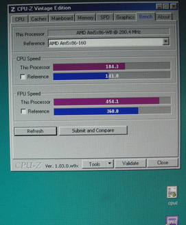

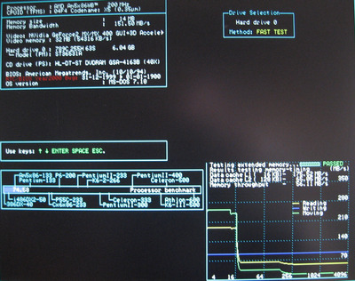

The result is an extremely fast CPU- and RAM-performance, which is (apart of the pentium- instructions and the FPU-performance) competitive to a mid-ranged Pentium-I-system without MMX from 1996/1997!

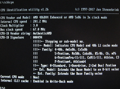

1. Sadly, the board was not able to boot at FSB 66 MHz with the same 486-133-CPU (at 200 MHz = 3*66) and with another AMD-486-120WB (at 133 MHz = 2* 66). HAS SOMEBODY MORE EXPERIENCE if the AMD 486 is able or not able to boot at FSB 66 in generally?

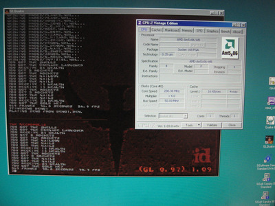

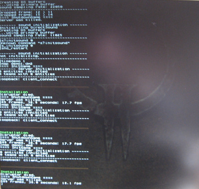

2. After using 3D with OpenGL (Quake I and II), there is not possible to shutdown Windows to the end (Windows hangs at the message-screen „Windows is shutting down” )

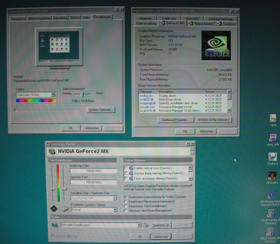

Windows-Results 3D:
Quake I (800x600 dpi ,windowed mode): 30,3 FPS
Quake II (800y600 dpi, Fullscreen): 18,1 FPS (best: 18,2)

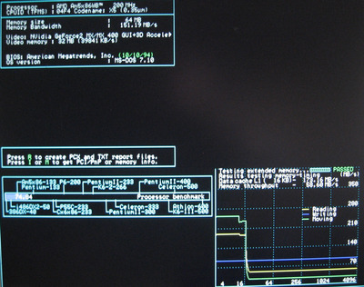

Other DOS-results with at 200 MHz (no pictures):

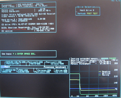

DOOM (timedemo 3): 76, 21 FPS (978 realtics)
Quake I: 21,7 FPS
PcP-Bench (VGAMODE): 30,6
3dbench 1.0c: 115,9

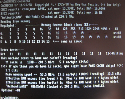

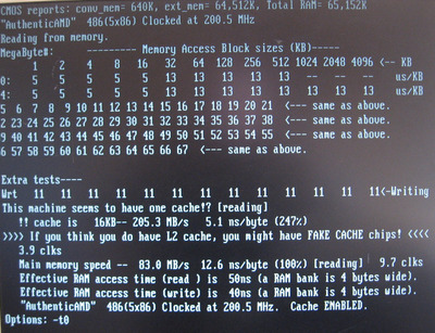

the only strange thing is, CACHECHECK means, there is Fake-L2-cache (not sure why – the system works perfectly)

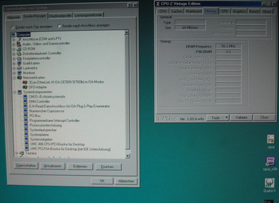

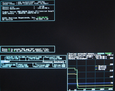

By the way: the CPU works fine at 180 MHz (3x 60), too. But in this case, the cache-timings in BIOS must be decreased from 2-1-2 (for 50 MHZ FSB) to 3-1-3, and this results in a drop of the RAM-performance from 70 MB/s (at 50 MHz FSB at 2-1-1) to 60 MB/s, as well in a drop for Quake I and II of about – 2,0 FPS (because of the lower CPU-Frequency I think). So the higher FSB itself was not helpful in this case 😉

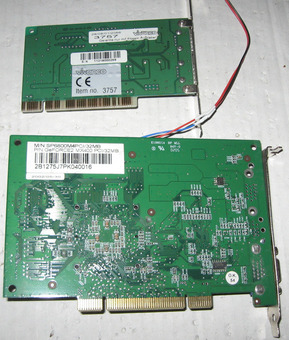

VGA: GeForce 2 MX-400, 32 MB (driver 6.31)

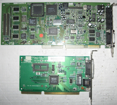

Sound: Creatice Sound Blaster 16 (CT2290)
LAN: 3Com EtherLink III (disabling it temporary in Windows for the Quake-tests results in + 1,0 to + 2,0 FPS)
USB: Opti FireLink 82C861 (I let it enabled during the Quake-tests; disabling it would add 1 or 2 more FPS to Quake)
