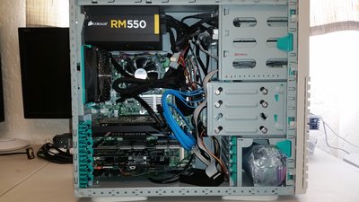

The next build is complete, I actually just started taking pictures of it for the build thread. 😊
I decided to keep my Pentium 4 build 'as it is' and use it is a secondary retro build (yay IPX LAN parties!), but I took it's monitor and speakers for the new build and instead I coupled the Pentium 4 with a 5:4 LCD and some period-correct Yamaha speakers (pictures of this new combo will be updated on this thread too).
Here are the current specs of the next build - a.k.a. the 40-year 'Ultimate Xeon' build:
Core Components:

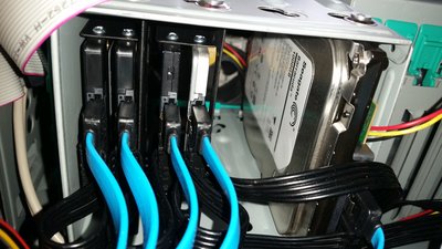

• Video Cards: EVGA (Nvidia) Geforce GTX 1060 PCI-E, XFX (Nvidia) Geforce FX 5200 PCI (DVI version), Intel GMA X4500 IGP, Diamond (3dfx) Voodoo 2 PCI
• Sound Cards: Sound Blaster Audigy 2 ZX PCI (SB0350), Yamaha OPL3-SAx ISA (YMF719E-S w/6.8nf Low-Pass Filter mod and Reversed-Wavetable fix)
• Hard Drives: PNY 120GB SSD (SATA), PNY 120GB SSD (SATA), PNY 240GB SSD (SATA), Intel 500GB SSD (SATA), Seagate 1TB HDD (SATA)
• CD/DVD Drives: Sony DVD-RW (PATA)
• CD/DVD Controller: Startech ICUSB2IDE USB 2.0 to IDE
• Floppy Disk(s): Epson SD800/SD700 Combo (3.5”/5.25”)
• Floppy Controller: KryoFlux Personal Edition USB 2.0 to Floppy
• RAM: Edge DDR2-800 (2x4GB)
• Motherboard: Portwell RUBY-9719VG2AR Industrial (G41-based chipset, 775 socket, ISA+PCI+PCI-E, ISA IRQ & DMA redirection possible via Tiido's RUBYISA utility)
• CPU: Intel Xeon X5470 3.33Ghz (Quad-core 771 Server CPU w/775 mod)
• Power Supply: Corsair RM550 (550W) ATX
• Keyboard: Mitsumi PS2
• Mouse: Microsoft Mouse (USB/PS2-based)
• Monitor: ASUS VX238W 23” 1080p HDMI/VGA LCD
• Speakers: Sony SA-SPC5 2.1 Reference (Studio-grade)
• Game Controllers: Gravis 10-button Gamepad, Sony PSOne Dual Shock w/USB adapter
Operating Systems:
• Windows 10 (64-bit)
• Windows 7 (32-bit)
• Windows 98 SE
• MS-DOS 7.10
• Macintosh OS X 10.13.3 (Hackintosh)
I have attached a few high-resolution (but still crappy phone pics) pictures of the new build (looks exactly like the P4 build but with new guts) and I will have a fully detailed build thread up by tonight. 😉

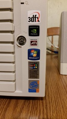

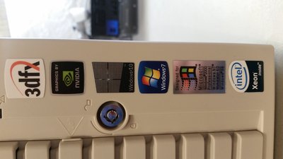

    1 MiB
    1956 views
    1.72 MiB
    1968 views
    1.61 MiB
    1968 views

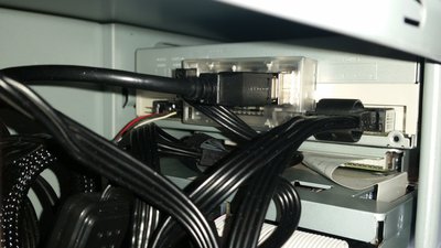

    1.3 MiB
    1968 views

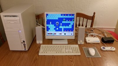

Reply 32 of 32, by FrostyTheSnowman
I have attached current pictures of the Pentium 4 build to this post. 😀
Changes:
- 24" 1080p LCD replaced with 17" 1280x1024 LCD (24" 1080p LCD was moved to my new Xeon build)
- Sony 2.1 speakers replaced with Yamaha speakers (Sony 2.1 speakers moved to my new Xeon build)
- 3.5"/5.25" combo floppy drive replaced with 3.5" floppy drive (3.5"/5.25" combo floppy drive moved to my new Xeon build)
- CR-563-B CD-ROM drive removed (CR-563-B was sold)
- SB16 replaced with Yamaha OPL3-SAx ISA (YMF719E-S w/6.8nf Low-Pass Filter mod and Reversed-Wavetable fix) (SB16 was sold)
- 500GB SSD (SATA) replaced with 320GB HDD (SATA) (500GB SSD moved to my new Xeon build)
- 750GB HDD (SATA) replaced with 320GB HDD (SATA)
- FX 5200 VGA GPU was replaced with a DVI-enabled FX 5200 GPU
- Added U.S. Robotics 56K Faxmodem (external)
- Case stickers have been re-applied (and replaced in the case of the 3dfx sticker)
