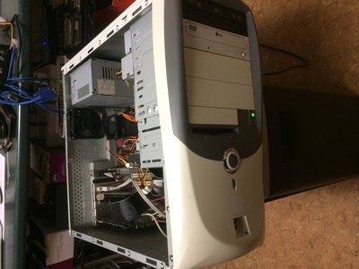

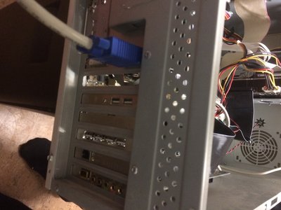

Specs:
Asus CUBX
Intel Tualatin Celeron 1.3 running at 1495 mhz (used to run this at 1612 mhz but it was never quite stable enough)
Geforce 6200 256MB PCI Video Card
1024MB PC-133 SD-RAM (4x256)
Seagate 250GB HD
Promise Ultra 133 (CMD ata66 controller on the MB is a turd)
Sound Blaster Audigy 2 ZS
3.5" Mitsumi Floppy
Realtek 10/100 NIC
Lite-ON DVD-RW and LG DVD-ROM
USB 2.0 PCI Card (connected to front ports)
XP / 98SE dual boot
This might be my favorite PC, I've been playing around with this board since shortly after it was released, I upgraded from a Pentium 233MMX to this board with a Celeron 466 and a whopping 128MB of ram. Ahhh those were the days. 🤣
I might swap out that black LG drive for a white Lite-On that I just took out of my AMD system.

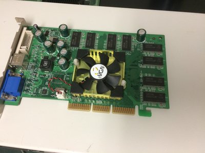

The eagle eyed viewer may notice that's an AGP card in there at the moment, I'm currently staying up too late not doing my taxes when I should and running various benchmarks comparing an FX5200 AGP to the 6200 PCI card I have. So far the FX is a bit quicker in Quake 3 at the same settings. I might also toss in my old Hercules 3D Prophet 4500 64MB (PowerVR Kyro II) to see how that baby does.

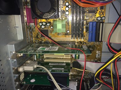

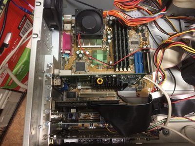

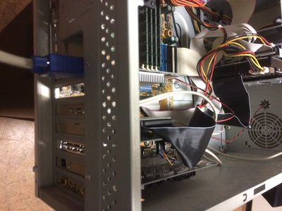

Benchmark results with the CPU running at 1495 mhz:
3dmark2001SE (1024x768 - default settings)
2242 - Kyro II 64MB
4091 - Geforce FX5200 128MB
5225 - Geforce 6200 256MB
3dmark2000 (1024x768 - default settings)
4450 - Kyro II 64MB
6011 - Geforce FX5200 128MB
6621 - Geforce 6200 256MB
Quake 3 (1024x768x16 - highest quality, trilinear filtering)
96.0 fps - Geforce FX5200 128MB
88.6 fps - Geforce 6200 256MB
The Kyro II refused to run Quake 3, I have no idea why I'm sure I used to play that game all the time on that card. It's fan is making a horrible screech these days so I quickly pulled it out after running the 3dmark programs.
I also tossed in a 32MB Matrox G450 and it refused to run anything. 😕
In the end I'm back to using the Geforce 6200 PCI card. The FX5200 is probably a bit quicker in actual games but the 6200 seems to have better 2d image quality on my old Lenovo LCD. There's some weird ghosting on the edges of some stuff with the FX5200. Also the heatsink on the FX5200 gets ridiculously hot.
