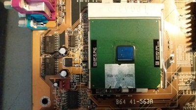

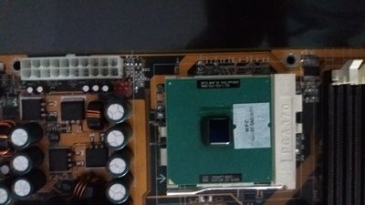

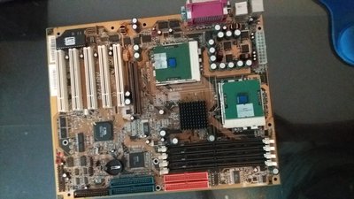

Today it entered in my possession an Abit VP6 motherboard with original caps in perfect condition. The idea is to build a dual CPU socket 370 rig.
One option is to use adapters such as Lin Lin ones for an ultimate Tualatin system however the price of such adapters is simply ridiculous and I only found them on E bay.
Option 2 is to use Pentium 3 Coppermine revision which is supported by the board natively and are much cheaper. I already found in my own country 2 P3 with the same spec number SL52R - one manufactured in Malay and one in Philippines - would this be OK to use or should I search for models manufactured in the same country? I also found 2 P3 with spec number SL5QJ Coppermine T revision which I do not know if they are supported by this board or they require a Tualatin compatible board. The performance is identical to the classic Coppermine or is something in between Tualatin and the classic Coppermine?
I already have 4 identical sticks of 512mb RAM and several PATA hard drives under 128gb capcacity.
Should I worry about something else? This would be my first dual CPU retro-build 😊 .
Reply 1 of 14, by slivercr
Congrats on the board, its a very nice one indeed!
-Watch out for the caps, even if they look pristine Abit used some cheap ones back then. If you run into trouble like instabilities and the such, these should be your first suspects.
-On eBay there are pre-modded Tualatin CPUs, if you choose to go that route. They are still on the expensive side though.
-When matching CPUs for SMP usage, the important thing is to match the stepping codes. Where they were manufactured is of no consequence.
-The CuMine-T you found will perform identical to a normal CuMine. They are compatible with motherboards that support normal CuMine signaling and motherboards supporting Tualating signaling.
Personally, having built a dual CPU system and ran Tualatins in it, I would just run CuMines. Cheaper, and less headache to get them running. Of course, you have to consider what you want to do with the system and how much money/time you want to spend on it. If the intention is to max it out then Tualatins all the way; for playing the occasional game and experimenting with SMP, either Tualatin or CuMine will do.
Good luck, and post some pics as you build!

Reply 3 of 14, by nd22
The motherboard look fine, no bloated caps. I do not have identical coolers so for testing I used some socket A ones. Memtest is now running to determine the stability and the right memory modules to use with the board. The BIOS is version YT and not the latest DR - but that one is only for the highpoint controller; should I upgrade or just leave it as it is?
Build progress:

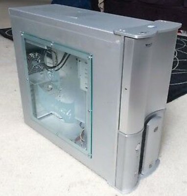

Reply 5 of 14, by Intel486dx33
I want to build this gaming computer.
With a Cooler Master Wave case and Jet-7 CPU coolers.
Maybe paint the motherboard flat grey.

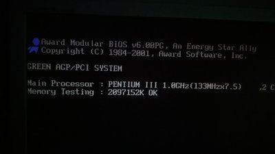

Reply 7 of 14, by nd22
I encountered a problem with the system!
With 2gb of SDRAM PC133, even form 2 different manufacturers, the system will pass memtest86 multiple times - 3 times in one night I think is enough!
I tried multiple HDD and they are all recognized - I choose a Western digital 250gb from 2004 I think.
As a test video card I used some geforce 5500 and 93.71 drivers. For network duties I used a TP-LINK 851nd compatible with every Windows starting with 98.
Both windows 2000 and XP installed just fine and the system is up and running however the problem is with the sound card! I used 2 different Creative Live - 0060 and 0220 - but they are not recognized by the system - they do not appear not even with an yellow mark in device manager! I changed the PCI slots - first time the 5th slot now the 4th slot but with no luck! I tested both sound cards in different systems and both are running just fine - one in an Abit BX6 2.0 with Windows Millennium and one in an Abit IC7-MAX3 with Windows XP - so both of them are OK! I have several others Creative Live - different revisions - I will try them but any suggestions would be great!

Reply 11 of 14, by nd22
I tried over 10 Creative cards and they are not recognised by the board!! Not a single one! Live 4830, 0060, 0100, 0220, Audigy 2 ZS, original Audigy and the list goes on and on! As last resort I installed a cheap C-Media CMI8738 sound card that was recognised on the spot and all drivers installed by Windows - it even works with 5.1 surround sound! I do not know if the problem lies with this specific board, with the VIA chip-set or with Creative but I am disappointed because Live was period correct and one the best sound cards of the era!

Reply 13 of 14, by nd22
I do not have that version! But after 12 Creative cards tested I gave up - way too much incompatibility problems - I am now testing them on an Abit BX6 2.0 and some of them are working just fine while some others are not - same problem as on VP6, not detected by the board! I am starting to think that the problem are Creative cards and not Abit boards or the chip-sets!
C+media does not have hardware acceleration so it consumes CPU resources but otherwise I do not hear any crackling and in Diablo 2 I have surround sound! I will continue with C-media simply because it is working!
Now I installed Windows XP and the performance is surprisingly good - it feels very snappy and responsive! Microsoft update works just fine and all updates up to April 2014 were picked up and installed correctly. The question now is: should I use POS2009 patch and get those updates or leave it as it is? I am fully aware of the problems with some of the updates and SSE1 only processors!
As an observation using a fast hard drive makes all the difference; period correct drives from 2000 - 2001 are atrociously slow! This one is from 2004 and fits perfectly!
