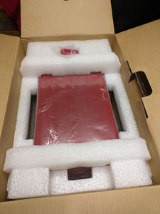

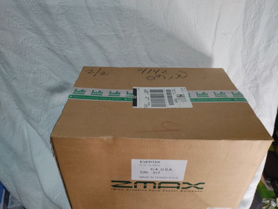

Reply 8 of 12, by wiretap
Won another on Ebay today for under $100. Made an offer since nobody else bid on it. This time, new and sealed in the box. Supposedly a red one, just like the one I already have. We'll see when it gets here.
219.97 KiB
826 views
My Github
Circuit Board Repair Manuals
Reply 10 of 12, by wiretap
Yea it is confusing. The box/website say 10/100 LAN, but the rear panel shows gigabit.
Anyhow, the NIB one arrived yesterday. Serial# 867. Identical to the red one I posted above. I'll upload some pix of the unboxing later.

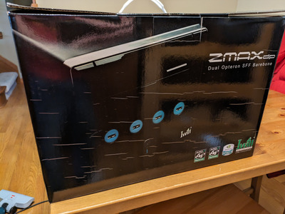

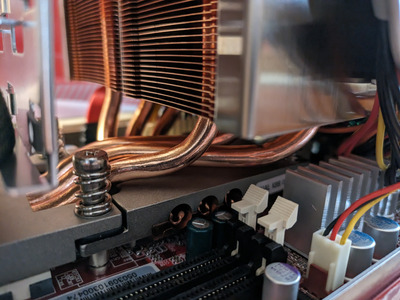

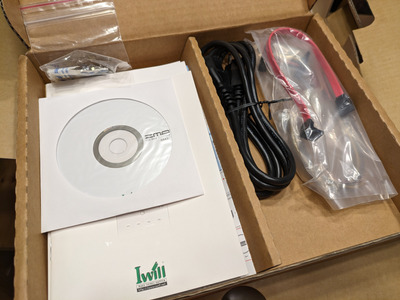

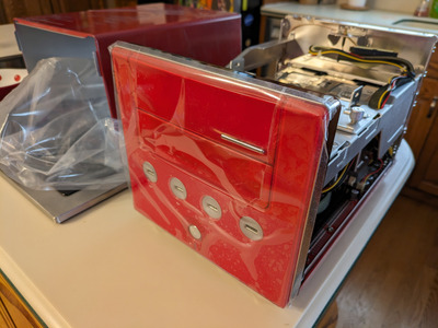

Reply 12 of 12, by wiretap
Pics from unboxing:
1.15 MiB
624 views
1.02 MiB
624 views
909.37 KiB
624 views
1.18 MiB
624 views
1.39 MiB
624 views
