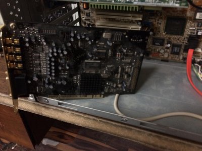

I actually found my old X-Fi soundcard today and so I've replaced the Audigy 2 with that.
EDIT - back to the Audigy 2, the drivers seemed to install with the X-fi but XP just sits loading forever with it in a PCI slot.

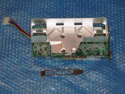

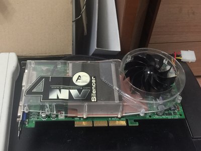

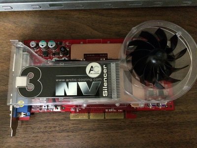

Also the FX5900XT finally arrived and the artic cooler is installed and working nicely.
I'll take some pics and post them tomorrow, I'm quite happy with this build now though.

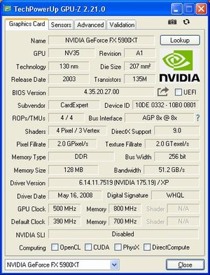

Benchmarks:
Aquamark 3 - 38055
3dmark 2000 - 12723
3dmark 2001 - 14268
3dmark 2003 - 5156
3dmark 2005 - 1021
3dmark 2006 - 302
Quake 3 (1920x1080) - 224.3fps
Overclocked to 500mhz core and 800mhz memory:
Aquamark 3 - 45858
3dmark 2000 - 12853
3dmark 2001 - 15748
3dmark 2003 - 6161
3dmark 2005 - 1267
3dmark 2006 - 368
Quake 3 (1920x1080) - 247.7fps
Everything is rock stable at those speeds, might try for a little more tonight after dinner.
EDIT - it won't go much higher on core or memory without artifacts/crashing, so I'll leave it at these speeds.

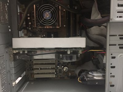

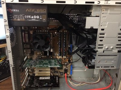

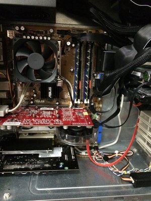

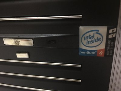

Some pics of the machine now that it's complete.

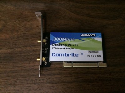

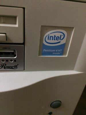

I added a few things to it recently including a P4 HT sticker, a zalman fan controller (to dial the speed down a bit on the case fan), an el-cheapo wireless card from eBay and a rosewill card reader.
    698.52 KiB
    1905 views
    531.96 KiB
    1905 views
    549.85 KiB
    1905 views
    692.47 KiB
    1905 views

Reply 13 of 27, by Ponjiayulady
Tribute to your P4 system
Reply 15 of 27, by luckybob

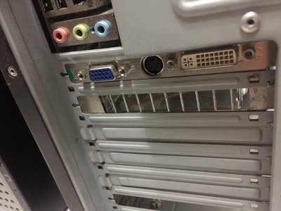

pete8475 wrote:
NICE!
What's the white thing on the back of the video card?
aluminum heatsink for the rear memory.

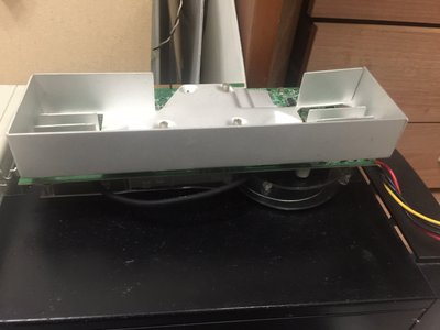

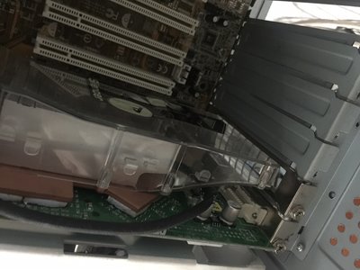

Reply 16 of 27, by Ponjiayulady
More photos of NV silencer
Reply 18 of 27, by canthearu
