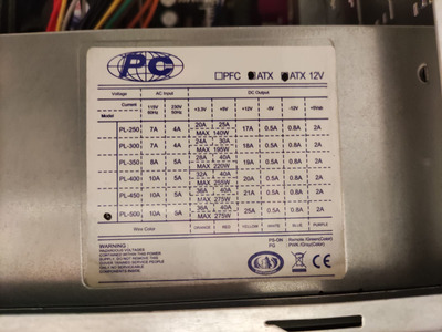

tried a radeon 9000 agp...installed win xp and VOILA' i can get it working!
So what do i think? I think that either is a simple problem of incompatibility of my geforce4 ti 4600 towards the epox/abit i have ( probably the card is really faulty someway ) or it's more a matter of power draw ( suppose the radeon 9000 is more "gentle" ). Even if my psu shows this as it follows:
160.13 KiB
1306 views
So my idea is to get and try either a geforce4 ti 4200 ( or a g3 ti 200 ) or any card with an own power connector and then let's look what i get...

I seriously doubt that.
Can we see some photos of the innards of your PSU please?

Reply 109 of 346, by BitWrangler
mockingbird wrote on 2022-02-11, 14:40:
Based on not seeing TUV, UL, CSA or anything similar on the label, I'm gonna guess stamped sheet aluminum heatsink, and a lot of empty space.
Reply 110 of 346, by Tetrium
Kaisersoze wrote on 2022-02-11, 11:07:
Some updates guys, tried a radeon 9000 agp...installed win xp and VOILA' i can get it working! […]
Some updates guys,
I definitely agree with this PSU seeming very questionable regarding its build quality.

Reply 119 of 346, by Kaisersoze
Good news guys,
i've changed the psu and now the geforce ti 4600 is back in action ✌️.
Obviously i checked it even after i installed the v2 sli and the awe 64 gold, but so far everything seems ok...Finally i'd say.
