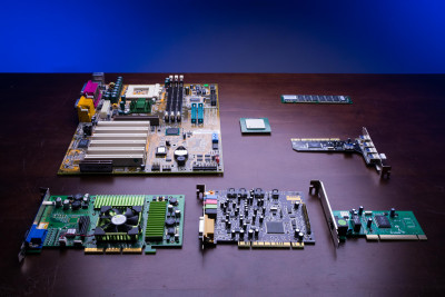

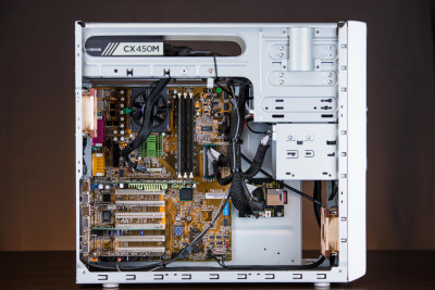

I upgraded my retro-PC:
- Pentium 3 800EB > Pentium 3 1.4 GHz-S Tualatin
- nVidia GeForce 2 GTS > nVidia GeForce 2 Ultra
- SB Live! CT4830 > SB Live! SB0100
- Improved cable management
- Better paintjob

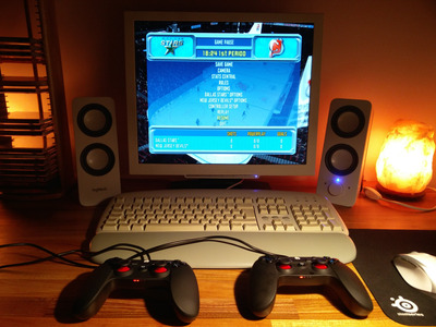

One of my desires, regarding retro gaming, is getting modern controllers to work on Windows 98 system, specifically wireless controllers. And there´s been a development: https://youtu.be/lNddWqHl5WM
Yes, I finally got first hand confirmation that wireless Dualshock 4s WORKS on Windows 98! However, there are some problems that I need a little help with but before I dive into it, I´d also like to show this:
1.41 MiB
795 views
Those are USB-wired Spartan Gear Oplon controllers, they are very cheap and you can choose whether you wan´t to use DirectInput or XInput, DirectInput obviously being the preferred choice. And yes, you can use two of those bad boys at once if you wan´t to play with a friend! You need a USB 2.0 PCI adapter, nusb36.exe driver file and you Windows 98 installation CD. When you´ve installed your adapter and USB drivers, just plug your first gamedpad on your PC and install drivers from your Win98 CD. After this, plug your second gamepad in and repeat.
I can confirm that this particular controller doesn´t require any other drivers, but this isn´t the case with all gamepads. Some controllers need their own drivers and those typically won´t work with Windows 98. So don´t buy the first DI controller you find, make sure it doesn´t need its own drivers!

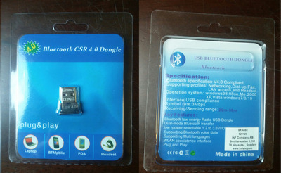

Now, I bought this
1.33 MiB
795 views

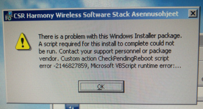

from a certain Nordic online shop because according to the description in both the website and the product, it´s suppose work on Windows 98. It doesn´t. The installer in the driver disc won´t finish and give´s this notification:
743.02 KiB
795 views
I also can´t find suitable drivers from the internet. So if you´re thinking about buying this dongle for your Win98 rig, DON´T!

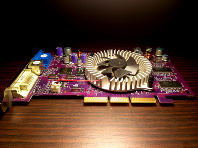

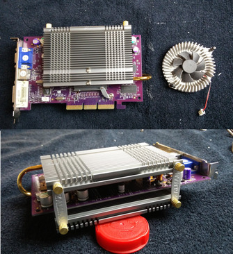

GeForce2 Ultra was part of my last upgrade last December, but I thought I might as well take it up a notch and found this GeForce4 Ti4200:
1.44 MiB
546 views
I have no idea what brand this is, don´t ask 😁 Someone in Facebook thinks it´s Palit Daytona... doesn´t matter to me, it works great. Since I was tired of my previous GPU fans screaming like nobodys business, I started to look for passive coolers and ended up with Zalman ZM80C-HP.
1.67 MiB
546 views

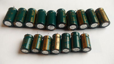

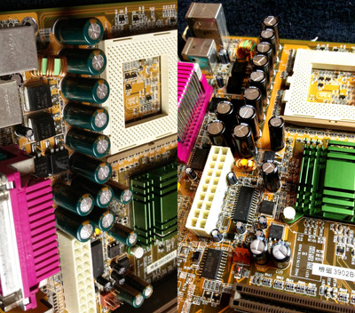

The original Teapo caps on my motherboard started to bulge and some of them were leaking. I replaced them with a nice set of Panasonic FR caps.
1.68 MiB
546 views
721.13 KiB
546 views
I wiped the leaking caps before taking the photos but the bulging is visible, although I know we´ve all seen worse. Still, why replace just one when you just have replace another later? Old Teapo caps retached:
737.62 KiB
546 views
Old Teapo caps
Reply 34 of 53, by khyypio
chrismeyer6 wrote on 2020-07-08, 20:40:
How are your temps with the passive heatsink? It's a great system your building.
Well, it heats which is good, means the heat transfer works like it should 😁 I didn´t measure any data to benchmark, but 3DMark 2001 demo has been running on loop for about an hour and the temperature has been steady for a while now. The cooler is hot but not too hot to touch, I can keep my fingers for a few seconds on it where the chip is located.

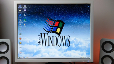

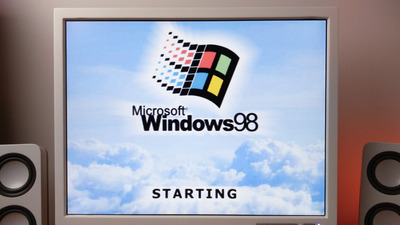

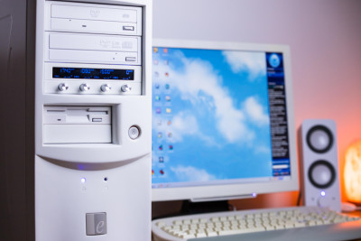

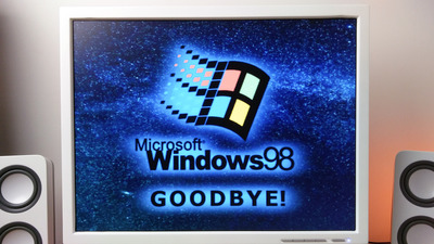

Sketching custom wallpapers and splash screens...
1.21 MiB
284 views
1.77 MiB
284 views
1.38 MiB
284 views
