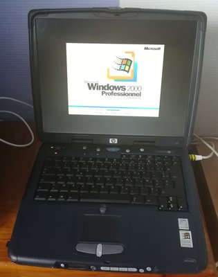

Ahem, so, what I have right now is probably my first working retro laptop (well not the first laptop that I have, I also have a Compaq Armada 1700 Pentium II but unfortunately it's beyond repair, simply put: If I try to fix it, something else will break on it 😠 so I gave up on it, it needs more than a good cleaning tho), an HP Omnibook Xe3-GC, probably one of the weirdest laptops I have ever owned.
Little backstory about it: I got it for free from a friend who was about to throw it out, I didn't know if it work, but one thing I knew: the CMOS battery was dead, the machine would boot up to a message among the lines of "CMOS BATTERY FAILED. DEFAULT SETTINGS LOADED bla bla bla..." you get the idea), well, either this thing doesn't have one (I've seen some computers retain their date with a supercapacitor, or maybe it uses the main battery [which is dead, as expected] to keep the CMOS settings in memory), or it is well hidden. Either way I don't really care.
So, this brings us to the point where I first tried to get it running, I kept it plugged in (good thing it came with the AC adapter or else I would have been in a very bad situation 😢), it fired up just fine, same "CMOS battery failed" message but then it proceeded to boot to Windows XP?! Well not just a regular WinXP, but a pirated one at best (yarr!) and chock full of viruses 😵 (Windows XP: Digitalhazard edition 😖), so nope, I'm DBAN'ing the living shit of this hard drive.
Now this brought another question: What OS should I put on it? Well, at first I tried Windows 98 (and had to transfer the drivers [didn't took me long to find the Windows 98SE ones] by a Null Modem cable 🙄), but since I had to do some testing on it, I would up dual-booting Windows 2000 😏, and this is where all hell broke loose (omitting the boot media debacle I faced... Yippie!):
First I managed to screw up my first Win2k install (ouch), well, I'll just wipe the Win2K partition (note to myself: get a bigger hard drive, a 10GB partition for each OS isn't going to cut it), or so I thought: Because it also fucked up the bootloader. Crap. (had to resort to the good ol' FDISK /MBR to at least get my Win98 install back)
Naturally, I've just gone the high road and reinstalled Win2k on the second (now blank) partition, well it went smoothly, (installed the updates of course), then came the problems of the drivers, I had the Win98 ones but not the Windows 2000 ones.... Cue in me Google-fu'ing for daaayyyyys before I could find suitable ones (on a very shady ad-filled site that is) and we're set.
Without further ado, here's the specs:
  • CPU: Pentium III Mobile Coppermine (Geyserville) @ 800MHz
  • GPU: S3 Savage/IX w/ TV-out (tested on my crappy Daewoo F14C1NS TV, yep it works but it's practically eye hurting juice 😳)
  • RAM: 256MB (I suspect that there is two 128MB sticks, although the BIOS seems to report... 512MB... WTF)
  • Hard drive: IBM Travelstar 20GB (it predates the infamous DeathStar 75GXP)
  • Sound: ESS Allegro (don't think this thing will work in DOS... I'd like to be wrong on that but...) w/ Modem (just gotta get a Shiva LanRover and see how this rolls...)
  • Misc: DVD drive, 10/100 NIC, 1.44M floppy drive...
  • Operating Systems: Windows 98SE (w/ MS Plus! 98 installed) and Windows 2000 SP4 dual-boot (after all the laptop has a "Designed for Windows 2000 / Windows 98" sticker on it, so I thought i'd go balls to the wall with this one)
It's not much, but at least it's something that just works for me, first my P133/233MMX rig that decides to really get on my nerves (namely, the motherboard started showing some erratic behavior... and I don't feel like dealing with this right now).

Reply 1 of 18, by chinny22
P3 should be fine to play your dos games from within windows, wouldn't call it a deal breaker
Ok so you cant mess around with hardware but plug a keyboard/mouse/screen into it and then you have a retro machine that takes up no space and just as good 90% of the time.
Tip from someone who's duel booted since the lat 90's. Win98 partition should be fine with 2GB and ever needed more then 4GB even with loads of app's installed.
Install games, data, etc to a data partition that way if/when you do need to reinstall the OS you don't have to reinstall EVERYTHING, not all but most games wont notice it's a fresh install.

Reply 4 of 18, by ragefury32
Yeah, your machine is kinda weird, but not in a bad way. The Omnibooks are like HP's version of ThinkPads - better grade of quality versus their Pavilions, and features some nice designs...the old school Omnibook 800CTs are good competitors against Toshiba Librettos. They eventually gave way to the EliteBook series, which are very good machines - those are probably better Thinkpads than the recent ThinkPads.
Several things specific about that Omnibook:
a) Back then the HP Omnibook XE3s almost always have a Pavilion 5000 series cousin. It's similar to what Dell was doing when selling their Latitude C6xx/8xxs and their Inspiron 4x00/8x00 series. They are both not entirely interchangeable, but close enough to swap internal parts. Your GC/XE3C should be about the same in terms of internals as the Pavilion N53xx series - useful info if you need a cheap parts donor.
b) The XE3Cs are Intel 440ZX/Coppermine P3 based machines. The 440ZX are a lower power/mobile version of the very popular 440BX chipset, and supports up to 256MB per RAM slot, provided that they are PC100 compatible AND uses 16MB chips, typically 8 on each side of the DIMM unit. Most laptops from this vintage come with 1 or 2 slots (256 or 512MB max), and some has RAM already soldered onto the chassis (so you'll see weird numbers like 320 or 384MB max on those oldies). This dictates the max RAM count on those machines. The 16 chip/256MB DIMM is what the 440 guys on retro forums refer to as "16 chip, or low density memory" - if you bought the wrong type of memory for the machine (it uses 32MB or 8 chip RAM designs), you can't use it - either the RAM count will not report correctly (512MB installed but only 256MB visible) or the machine won't boot altogether. Not every 2 slot, 440 based laptop will let you go to 512MB of RAM. The 440MX chipset for subnotebooks were notorious for their 256MB max RAM ceiling, which were found in Thinkpad 240X/Zs, Sony Vaio SRs and Toshiba Proteges 3440/3480CTs.
c) HP seemed to have purged the old service manuals from their web server, but copies are cached on manualslib via https://www.manualslib.com/manual/788711/Hp-O … Xe3.html#manual - that can be very useful if you ever need to strip/clean the machine.
d) HP offered a very narrow upgrade path for the video chipset - if your machine comes with a 4MB SavageIX, you can upgrade it to an 8MB variant by swapping out the daughtercard containing the GPU (there's 2 variants, one for XGA (F2300-60906) and one for SXGA+ ()) - in general you are required to flip some dip switches on the motherboard afterwards to communicate changes to the video subsystem..
e) As for getting Win98 to work? Well, there's a little bit of a cheat:
- If you have another Win98 machine, get into that machine, and use it to format the drive (attached as a secondary device) as fat32, make it bootable (fdisk option) and do a system disk (format d: /s). The drive should now be able to boot into DOS/Win98 command line. Then copy the Win98 directory of your typical Windows 98 ISO to the bootable drive . Move the drive back into the XE3C and boot off it. Once you boot it off, go to c:\win98 and run setup.exe.
If you use an SD-to-IDE or an mSATA-to-IDE adapter, this should be relatively easy task.
- If you don't, ask someone to hook you up with a clonezilla image off a working machine.
f) I don't see any references to an RTC battery, but if the photo of the XE3C motherboard here tells me anything, there looks to be some kind of RTC battery covered under the yellow cellophane near the RAM slots. It might also be a soldered CR2025/2032 clone on the board itself. if you can, solder that garbage off and put a real battery holder in.

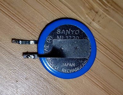

Well, the settings usually gets written to an EEPROM, it's the current time that is retained via a CR2025/2032 (or its soldered down lithium rechargeable equivalent). Remember the photo I posted up top? Look at that yellow cellophane covered area near the RAM slots...does that look like a battery to you?
When it comes to the RAM, remember that you need something that is 16 chip and PC100, something like this would do just fine -> https://www.ebay.com/itm/392085393835
I would not buy PC133 RAM unless you have a piece of PC100 that you can mix-and-match - the PC100 RAM would force the other memory slot to run at PC100 speeds.
Reply 14 of 18, by Thermalwrong
From the size of that cell, I think it's an ML1220, which is a rechargeable lithium cell and will slowly trickle charge while the battery is powered. If it's working now after charging up the laptop, it will likely run for many more years yet. The rechargeable lithium cells I've found in laptops are still going strong after 20 years so there's usually no need to replace them 😀

Reply 15 of 18, by Vynix
@Rage
I haven't seen this "yellow cellophane covered" thing on mine (by looking in the RAM trapdoor), but if it's where the battery is, this might be problematic the day I'll have to replace it. Unless the cellophane was missing on my unit...
By the way, yes it's definitely a ZX chipset, so that's settled then.
@Thermalwrong
Yes it started retaining settings after I let the laptop plugged in for roughly 48 hours, ever since I haven't had the "CMOS BATTERY FAILED" message.
I might as well get a replacement battery for it, what's the point of a laptop if you can't run it without sector power?

Eh, you don't see that particular item on the board itself? The yellow cellophane can be missing or replaced by something else (like regular tape).
Let's see. Did anyone do a teardown of a GC? Oh yes, yes there is. Here's one -> https://www.youtube.com/watch?v=tUjk3exwAK8
If you go to ~2:00 on the video you'll see the clock battery displayed, and yes, that looks like an ML1220 variant. Like I've said before, replace it with a holder and a regular rechargeable battery if you have the time, there are tons of videos on how to desolder a battery off a board and replacing them...a ~20 year old lithium ion battery is probably long gone and won't do you much good, especially if you don't plan to buy a full main battery to replace the one that you have.

No I meant that I have not seen that yellow tape thing, but I indeed saw the CMOS battery (and I tested it on my board, it's still holding up a good charge, I let the laptop sit unplugged last week and when testing it yesterday, the CMOS battery was still charged). But it's due for a replacement anyways, I'll probably solder some wires and put a holder (ML1220s are the same shape as a CR2032, right?) where it can be easily accessed, so if I have to swap it, I won't have to tear apart this thing (and belive me or not, it's hard to tear it down without further cracking the plastics, it was really unnerving).
