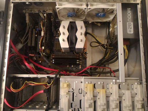

A few years ago I started getting the classical dying mobo symptoms: intermittently doesn't POST, doesn't exist standby, random lockups, sometimes does not detect SATA ports on boot, etc. I got a replacement board of the same kind, but also gave the original an ultrasonic bath and decided to keep it until the symptoms become frequent enough to make the machine unreliable. Well, it recently got to this point, so I finally got around to swapping that board out. Also got to clean most of the components a bit before putting them back in the case.
The case with the board removed (just looking forward to working through that cable mess upon reconnecting):

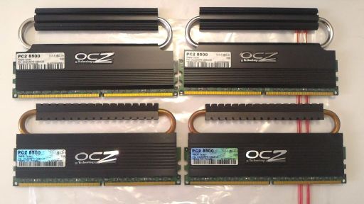

The OCZ Reaper RAM. I got them as matching pairs, but a few years apart, and OCZ change the heatsink design in between (but the chip specs are the same):

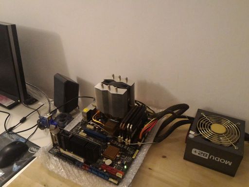

The new motherboard with CPU, RAM and MOSFET cooler installed:
With the monstrous HSF installed:
Despite the size, the SCMN-1100 is very light and so has no backplate, and so it only uses the atrocious Intel-designed pushpin mechanism for installation. It's easier on one hand, but sometimes struggling with those pins is a nightmare. Once I tried doing it with the board in the case - never again. This time 3 of the 4 pins went in easily, but the fourth one gave me hell.

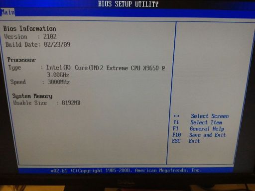

I decided to first test the board outside the case (would be annoying to put everything together to find out it's DOA). For this I used a spare Enermax 525W PSU, a spare 8400GS PCI GPU, and connected it to the keyboard and monitor normally used by the Thinkpad T60 laptop:
It's alive! (and BIOS is at latest version)

Installed back in the case with everything connected: #CableManagementIsOverrated

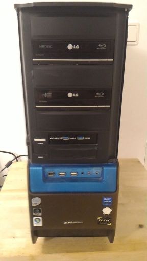

Front view of the case:
