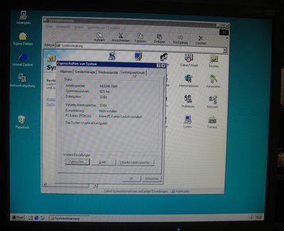

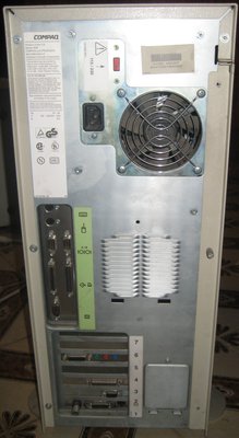

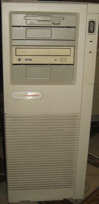

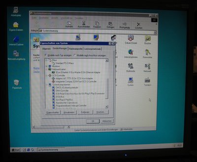

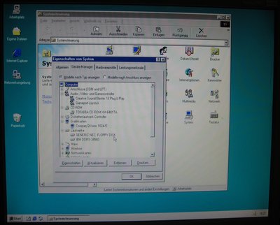

Reply 9 of 57, by CoffeeOne
The computer still works like a charm 😀, but honestly spoken I never did something with it, I only installed Windows 98 SE back in time. 😁
Some Photos:
671.41 KiB
3368 views
743.64 KiB
3368 views
870.15 KiB
3368 views
935 KiB
3368 views
875.81 KiB
3368 views
So there is an IBM harddisk inside, Toshiba CD ROM and a SoundBlaster 16 card.
Now I have to search for my ECU Floppy Disk, I hope I still have it.
What kind of RAM for the 32MB sticks do I need. As far as I know it should be Fast Page Mode (no EDO) with parity, double sided with 9 chips on both sides. 70ns is sufficient.
Is it correct?

Since I had no useful data on this machine, I cleared the harddisk, and installed the system partition.
Now the good news: I found a 3Com 3C597 card, now the machine has 100MBit ethernet, too, only 2 EISA slots left now.
Also today the ordered RAM arrived, so the machine has 112MB now, counting up nicely to 114688K.
It's my first 486 computer, that has more than 64MB RAM, yay.
I already re-installed Windows 98SE, but need to install some tools, like a web browser that supports https or a FTP client (directly transferring file from Windows 10 to Windows 98SE did not work for me anymore, worked back in time with Windows 7). Will do it in the next days.
If I am able find an EISA wide SCSI controller with Windows 98 drivers, I will again change the hardware, because I have 5 spare harddisks, all 9GB with 68 pin connector, but for now the 4GB 50pin harddisk is fine.
There are some weirds things, but not too worrying: Whenever I add the configuration utility (no changes made the hardware), it tells me it has to update the internal SCSI controller. The internally SCSI controller is in fact disabled, because there is nothing connected to it, so I don't understand this behaviour.
