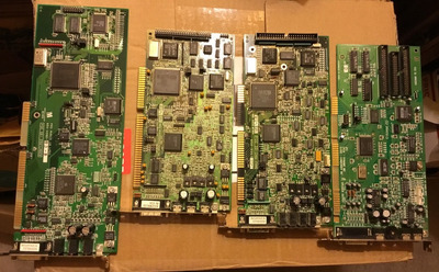

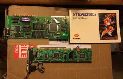

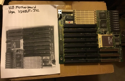

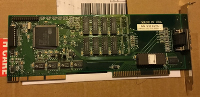

I have some NEW stuff for the 486.
Media Vision sound cards ( 1992 /93)
S3 VLB video card , Diamond Stealth 24 ( 1993 )
Cirrus logic 5428 VLB video card ( 1993 )
Another Vega VLB MB.
etc....

    621 views
    Diamond Stealth 24
    256.87 KiB
    622 views
    Media Vision Sound cards
    203.75 KiB
    624 views
    Vega Motherboard

    624 views
    Acculogic VLB controller
    176.46 KiB
    624 views
    Cirrus Logic 5428 Video card
