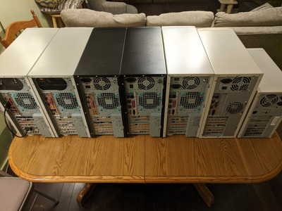

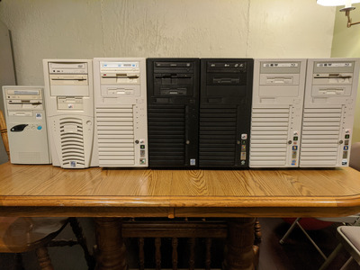

I created a few other threads during earlier build stages of these computers over the last year, but I decided I will be using this one instead as my main multi-build thread for all of my DOS/Win98 hardware compatible retro rigs going forward.
Thus far I have built DOS/Win98 compatible rigs on the below platforms:
486 (Socket 3)
Pentium OverDrive (Socket 3)
AMD K6-2+ (Super Socket 7)
Pentium Pro (Socket 8 )
Pentium 2 OverDrive (Socket 8 )
Pentium 3 (Slot 1)
Pentium 3-S (Socket 370)
Pentium 4 (Socket 478)
Xeon (Socket 775->771)
My minimum requirements for each of my DOS/Win98 compatible rigs is as follows:
1. PC speaker support under DOS
2. SB/FM/MIDI sound support under DOS
3. CGA/EGA/VGA/VBE 1.0-3.0 video support under DOS
4. Keyboard/Mouse support under DOS
5. Joystick support under DOS
6. DirectX 7 video support under Windows 98
7. DirectX 7 sound support under Windows 98
8. PATA or SATA controller support under Windows 98
9. Networking support under all OSes (with exception of DOS, as I prefer to use Windows' IPX instead for DOS networking)
10. Floppy drive(s)
Secondary objectives:
1. 3dfx video support under DOS/Windows 98
2. DVI/HDMI support
3. SSDs instead of HDDs
4. USB 2.0 support
5. Gigabit support
6. DVD/Blu-ray playback support
7. Macintosh support (Hackintosh)
All of the below rigs are considered complete and function properly without issue, and they all have more-or-less equivalent levels of DOS/Windows 98 compatibility.

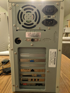

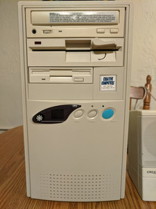

Reply 2 of 31, by FrostyTheSnowman
Socket 3 Build
OSes: DOS, Windows 98 SE
Unknown Case w/Working Front 3-Digit CPU Speed LED Display
Soyo SY-027 Rev B2 (ISA/PCI)
Intel Pentium Overdrive 83Mhz (PODP5V) (Main CPU)
Intel 486 DX2 66Mhz (Spare CPU)
64MB 70NS FP RAM
Seagate 40GB PATA HDD
Sony PATA CD-ROM
5.25" Floppy
3.5" Floppy
Cirrus Logic GD5446 2MB PCI
UMC UM82C86xF I/O ISA
Yamaha YMF719-S ISA w/DreamBlaster S2
3Com 3C905B-TX PCI
U.S. Robotics WS-5614JS3 ISA
250W AT PSU
Old build thread: Retro P24T/5x86/486 ISA/VLB Rig
    741.13 KiB
    2705 views
    866.62 KiB
    2705 views
    1.82 MiB
    2705 views

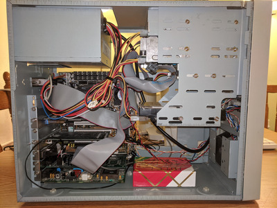

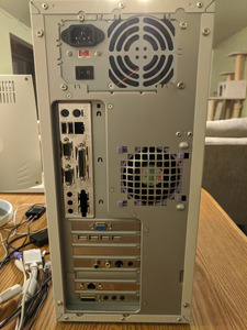

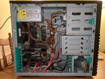

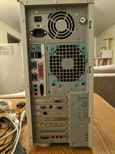

Reply 4 of 31, by FrostyTheSnowman
Socket 8 Build
OSes: DOS, Windows 98 SE, Windows 2000
Antec P4-Era Case w/Working Front USBs (HUB+NEC)
Intel VS440FX (ISA/PCI)
Pentium 2 Overdrive 333Mhz (Main CPU)
Pentium Pro 200Mhz (Spare CPU)
256MB 60NS EDO RAM
PNY 120GB SATA SSD (2x)
Creative PATA DVD-ROM
5.25" Floppy
3.5" Floppy
Creative 6760 (3dfx Banshee 16MB) PCI (VGA)
Creative 7160 PC-DVD PCI
Silicon Image Si3112 PCI (SATA)
NEC 5-port USB 2.0 PCI
Belkin F5D5055 (ASIX AX88178 w/VSC8211XVW) USB (Internalized) - Win98 compatible USB gigabit!
USB 2.0 Hub (Internal)
300W ATX PSU

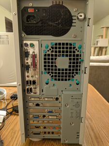

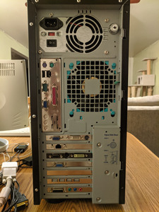

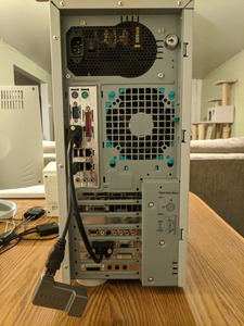

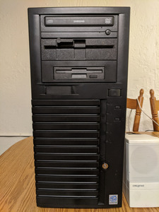

    847.79 KiB
    2704 views
    934.88 KiB
    2704 views
    1.82 MiB
    2704 views

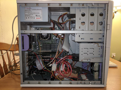

Reply 5 of 31, by FrostyTheSnowman
Slot 1 Build
OSes: DOS, Windows 98 SE, Windows 2000, Windows XP
Chenbro Case w/Working Front USBs (HUB+NEC)
ASUS P3B-F (ISA/PCI/AGP)
Intel Pentium III 750Mhz
1GB PC-133 SD-RAM
Samsung PATA DVD+RW
5.25" Floppy
3.5" Floppy
Nvidia Geforce FX 5200 256MB AGP (DVI/VGA)
3dfx Voodoo 3 2000 16MB PCI (VGA)
Promise SATA 150 TX2 PCI (SATA)
300W ATX PSU

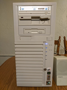

    1.05 MiB
    2704 views
    1.04 MiB
    2704 views
    1.94 MiB
    2704 views

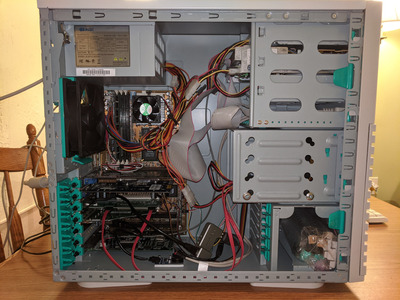

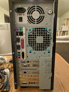

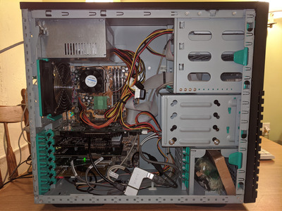

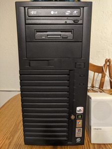

Reply 6 of 31, by FrostyTheSnowman
Socket 370 Build
ASUS CUSL2 Rev 1.02 (ISA/PCI/AGP)
Intel Pentium III-S (Tualatin) 1.4Ghz (Main CPU)
Intel Pentium III 933Mhz (Spare CPU)
512MB PC-133 SD-RAM
LG PATA DVD+RW
3.5" Floppy
Nvidia Geforce 6800 GT 256MB AGP (DVI/VGA)
Nvidia Geforce FX 5200 256MB PCI (DVI/VGA)
Yamaha YMF724 PCI
350W ATX PSU

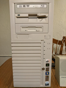

    1022.12 KiB
    2704 views
    994.69 KiB
    2704 views
    1.9 MiB
    2704 views

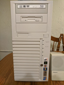

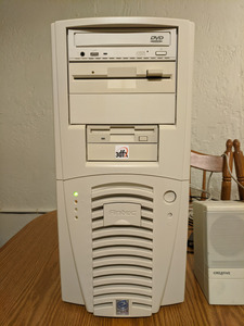

Reply 7 of 31, by FrostyTheSnowman
Socket 478 Build
OSes: DOS, Windows 98 SE, Windows 7, OS X Snow Leopard
Advantech AIMB-742 Rev A3 (ISA/PCI/AGP) (Industrial)
Intel Pentium IV 3.4Ghz
4GB DDR-400 RAM
Matshita BD-R SATA (Laptop SATA converted to USB 2.0 then internalized)
3.5" Floppy
ATI Radeon HD 3850 512MB AGP (DVI/VGA)
Intel ICH5 (SATA)
Sound Blaster Live OEM (SB0350) PCI
600W ATX PSU

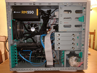

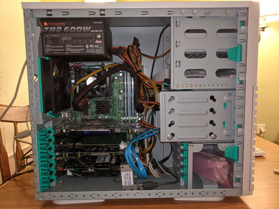

Reply 8 of 31, by FrostyTheSnowman
Socket 775 Build
OSes: DOS, Windows 98 SE, Windows 7, Windows 10, OS X High Sierra
Portwell RUBY-9719VG2AR (ISA/PCI/PCI-E) (Industrial) - Working DMA via RUBYISA thanks to Tiido!
Intel Xeon X5470 3.33Ghz (771->775 Modded)
8GB DDR2-800 RAM
PNY 120GB SATA SSD (3x)
PNY 240GB SATA SSD
Intel 480GB SATA SSD
Seagate 1.5TB SATA HDD
5.25" Floppy (via KryoFlux)
3.5" Floppy (via KryoFlux)
Nvidia Geforce 1060 GTX 3GB PCI-E (DVI/DP/HDMI)
Intel GMA X4500HD Integrated (VGA)
3dfx Voodoo 2 1000 12MB PCI (VGA)
Intel ICH7 (SATA) - Win98 compatible thanks to R. Loew!
VIA VT6421A PCI (SATA) w/Memphis OPROM
KryoFlux Floppy Adapter USB
Belkin F5D5055 (ASIX AX88178 w/VSC8211XVW) USB (External) - Win98 compatible USB gigabit!
550W ATX PSU

Reply 15 of 31, by FrostyTheSnowman
foil_fresh wrote on 2020-01-24, 02:40:
what's up with the 5200 alongside a voodoo 3 and 6800? i would guess that the 6800 does everything 5200 does but better. i get the voodoo 3 will do glide well whereas the 6800 can do all the rest, but 5200?
The Nvidia FX series was the last of the Nvidia GPUs to support table fog & 8-bit paletted textures (6800 does not support these features), plus it supports the 44.x drivers - for these reasons (and in my experience) the FX series is the most compatible GPU for Windows 9x games. The FX 5200 PCI may be a bit slow, but it works in any motherboard (old or new) and has a 256MB version with DVI. 😀
As far as *why* I have both - I use the 6800 GT for newer games under Windows 2K/XP as the FX 5200 was a poor performer under DirectX 9 (the FX 5200 works great for DirectX 5/6/7/8 under Windows 9x though).
I may decide to replace the 6800 GT with a 7800 GT at some point in the future, but it wouldn't be a huge change anyway as the CPU is the bottleneck at that point. 😀
As far as the Voodoo 3 goes - I use that for full VESA support under DOS (both the FX 5200 and the 6800 GT have incomplete VESA support, especially with VESA 1.0), and Glide support under DOS/Win9x.
nice setups tho, i like the mix of tech and getting it working.
Thanks! Half the fun is the journey - I love making old stuff work with new stuff and vice-versa. 😀
whats cooling your prescott and what kind of temps do you get? cheers!
I'm using an Intel copper-core OEM 478 heatsink with Arctic Silver thermal grease, along with a rear 120mm case fan and a front 90mm case fan for strong airflow - the case I am using (Chenbro) is server-grade and has really good airflow.
I think I am getting 40c at idle - it's been a while since I last checked though. 😀

Reply 19 of 31, by FrostyTheSnowman
appiah4 wrote on 2020-01-24, 18:19:
You sure do love that Chenbro case 😁
One might call me a Chen-BRO. 😁
In all seriousness though it *is* a dope case - 90% tool-less, server-grade with lots of airflow, comes in both black *and* white and is totally rigid even when empty. 😉
