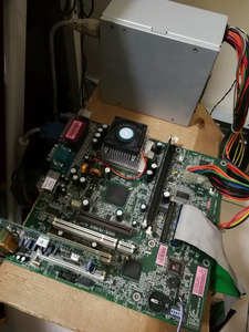

Reply 20 of 102, by enaiel
@kalohimal

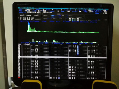

Right now I'm getting noise/distortion with every MOD player I have tried: glx.exe, opencp.exe, cmod.exe, ft2.exe, it.exe..., so any MOD player will do.
@dr_st
I'm only using Win98SE DOS for the FAT32 filesystem. If I use FAT16, then Win98SE is of no use to me and I might easily as well use DOS 6.22. This is a DOS only machine.
@appiah4
I only want to do DOS gaming. I have no interest in Windows. So I would be interested in the best PCI sound card for DOS.
DOS PC: Socket 370 / VIA C3 1.0 GHz / Voodoo2 + Trident Blade3D / SBPro + YMF744 + AWE64 + SC-7
Best DOS Games: CGW 150, PC Gamer 50, Worthwhile 100

You are absolutely right - the P3 is not the best for DOS gaming, but it's what I already own. And so far CPU speed wise, I seem to be doing fine using a combination of throttle.exe and smb.exe.
BTW, I finally found the cause of my application crashes - EMM386! I had forgotten about these memory management issues since its been over 20 years since I last used DOS . So I created 3 menu items - one for HIMEM+EMM386, one for HIMEM+EMM386(NOEMS) and one for plain HIMEM.
Unfortunately, Audigy (and YMF744 apparently) need EMM386 to load their drivers. That means for two one of my menu options I have no sound 🙁.
Now if only I can fix the noise/distortion while playing MODs, then I will be done with this PC.

Can someone please test if the YMF744 or FM801 are able to play MOD files properly using any MOD player? I think the reason why Audigy has problems with MODs is because the MOD players were created by people in the demoscene, and so probably use some very low level and undocumented APIs that the SB16 emulation has trouble with.

I get the noise/distortion while playing MODs even without throttling or disabling the cache. The distortion is as if the amplification is too high and the audio is getting clipped. But no settings in Audigy or in the MOD players seems to have any effect. Everything else plays fine.
@appiah4
Thanks, that would be really helpful! Any MOD player or MOD will do - but if you want a specific example try Open Cubic Player with CHILDREN.MOD.

I've tested using ocp player and children.mod, on an i815 motherboard with P3-1GHz Coppermine CPU and Yamaha YMF744, with CPUSPD T1. No such distortion that you mentioned, only occasion minor noise on the right channel, but that's most probably due to old capacitors on my old sound card (need to find one day to recap it).
Update: I tried another YMF744 spare card of mine, and the right channel noise is still there. So I downloaded another file "beyond music.mod" and tried, and the noise is gone. Perhaps the noise is from the MOD?
Slow down your CPU with CPUSPD for DOS retro gaming.
Reply 32 of 102, by enaiel
Thank you so much for doing the test. That noise is part of the song - it's the sound of people talking. I'm glad it works because I just panic bought the last YMF744 from the seller on eBay after I saw 9 of his 10 units get sold while I was watching!

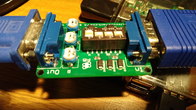

On a completely unrelated note, I just received my scanline generator from Focus Attack for my RetroPie, and just for kicks I tried it on this PC and was quite pleased with the results. Reading text with it on is not that great, but it looks pretty good in games. The picture doesn't do it justice - it just makes all the pixel art look really smooth and pop out, even though I'm using a 1080p LCD.

That's interesting. I did the reverse, by using a scan converter to convert video outputs from Atari, Amiga and Apple computers to VGA.
