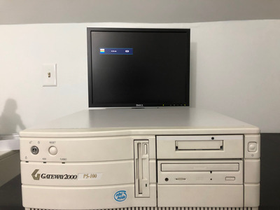

I have a very special place in my heart for this style of Gateway. I had a similar system a very long time ago and always wanted to get another one. With my newfound time indoors thanks to the great quarantine of 2020, I found this one at a reasonable price online.
It arrived to me with the following configuration:
~Original Specs~
Gateway 2000 P100
Pentium 100mhz @ 66mhz FSB
32 MB of RAM
430FX “Zappa” Motherboard
5x CDROM
3.5 Floppy
Tape Drive
1gb WD Caviar IDE Drive with Windows 95b installed
ATI Mach64 PCI Graphics
3COM 3C905CX-TX-M
Sound Blaster Vibra16 with genuine OPL

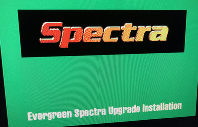

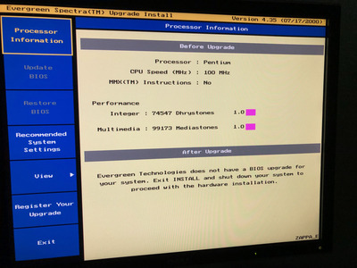

The installation process is interesting with the Spectra kit. It comes with a floppy and a cd. You must first boot the floppy where it analyzes your system and it will notify you if a BIOS upgrade is available. It will also advise you if any configuration changes are needed. This was where I ran into my first snag. The floppy disk was beginning to go. It would begin to boot but end up prompting for the location of COMMAND.COM. Thankfully a backup image is available on Vogons Drivers . With a fresh floppy, I was all set.
1.94 MiB
1412 views

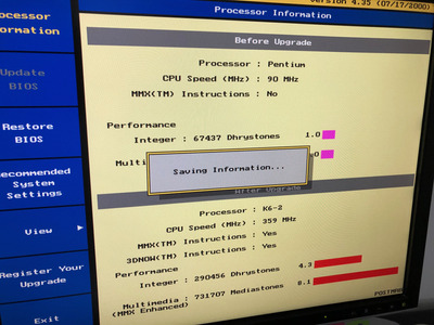

To help sell you on the upgrade, it also spits out some numbers.
1.35 MiB
1412 views

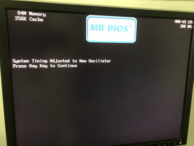

I checked out the recommended settings and I was prompted that I had to change the FSB speed from 66mhz to 60mhz. To do this, I adjusted jumpers 6 and 7 to off. After making the change, I booted off the floppy again and was notified that a BIOS update was available. To proceed with updating the BIOS, a reboot into Windows is required and then you run the executable provided on the cd. The cd will prompt for the floppy and then copy the appropriate update image to disk. Once that finished, I booted off the floppy and went through the prompts to update the BIOS.
With everything all updated (now powered by MR BIOS), I powered the system off and installed the K6-2 upgrade. The jumpers on the upgrade kit were already configured for the proper voltage and 6x multiplier. All that I had to do was plug it in. I started the computer and got instant gratification with K6-2 358mhz displaying on the screen.

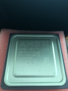

K6-3+ CPU

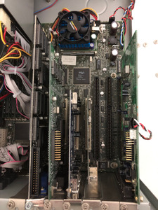

The Spectra upgrade socket also has a jumper to configure CPU voltage. I very carefully removed the K6-2 processor from the socket and installed the K6-3+. Then I configured the voltage jumper so that 2.0V instead of 2.2V (the default) would be supplied.
788.21 KiB
1409 views
Naturally the BIOS has no idea what this is and just tells me I have a K5. I decided to go for broke here. I powered off the system and configured the motherboard for 66mhz FSB. Powered it back on and I am in business.

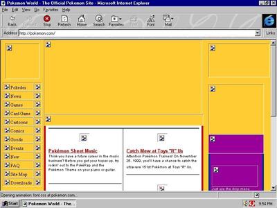

One other thing I wanted to play around with was networking. One reason was I wanted an easy way to transfer files to and from the Super Socket 5. A raspberry pi running samba solves this problem without much fuss. Another reason I wanted to play around with networking was web browsing. Obviously modern sites aren’t going to work, but what if we connected my time machine of a computer to the wayback machine?
I stumbled upon this project that allows you to run a proxy server to the wayback machine. It is very simple to setup and allows you to request a point in time so for example you could configure it to try to pull web pages archived on 9/9/1999. If no snapshot is available, it’ll try the next available point in time.
It isn't perfect but still fun:
116.34 KiB
1408 views
94.18 KiB
1408 views
