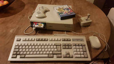

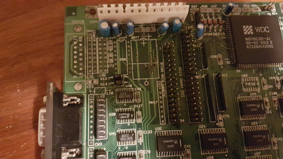

I finally have my Mega PC! I've stripped it down and checked everything. The battery has caused mild damage which has taken out the funtionality of the floppy drive, but the HDD works perfectly and is still loaded with the stock software!
I will take off the floppy and HDD headers and check all traces, then replace with new ones
It came with 3 manuals from the 486slc, they didn't get thrown away at least.
1.18 MiB
1709 views
Here it is all set up with Sonic looking well snazzy! 😁

The battery leak damage

you can use the EXT.BATERRY header and put one sealed in some baggie or something away from mobo
that 486SLC33 tech. reference is it a service manual?
Reply 116 of 228, by phipscube
I'm looking at putting one of those CR2032 adapters from Amiga kit in with the diode to stop the charge circuit..

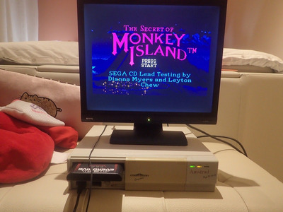

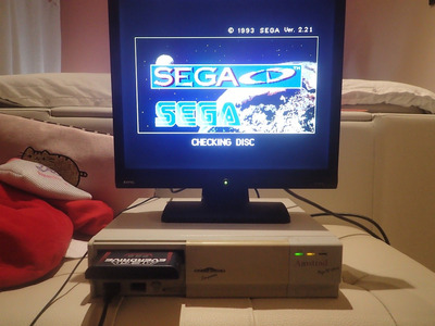

Some recent developments on my side to inspire you - Christmas came a little early for me (ok birthday 😉 ) and my partner got me a Mega Everdrive Pro ! - it works beautifully on the MegaPC, so I can now have SegaCD games on the MegaPC without a MegaCD and the required uber rare Amstrad link cable.
