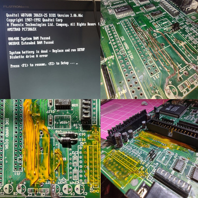

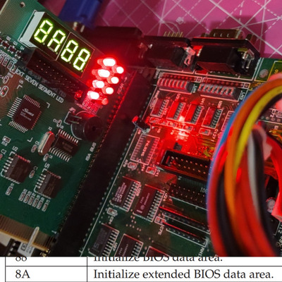

Hi everyone, first time poster here but have been keeping up to date with this thread for a while. I'm currently trying to repair my Mega PC which had suffered damage from the leaking battery. I've repaired all of the traces and checked continuity etc and all seems ok but I'm now getting this error on boot up when I use a post card:
'8A Initialise extended BIOS data area'
The system is not yet outputting a video signal - I've tried with the original monitor and an LG panel that I know is dual sync (not that it matters for just testing the pc though obviously)
I've previously had a bit of help from Keropi by email (thanks very much!) but rather than just bothering him I thought I'd put my latest problem on here to see if anyone has any advice.
Currently there is no battery connected, so the CMOS should have been cleared. I'm planning to use an external battery pack on the external battery headers when it's up and running.
Does the Mega PC need to be fully assembled to output video? At the moment I've just been testing the 386 motherboard connected to the PSU and monitor.
Also to note there is an IC that lifted off the motherboard near to where the battery leaked which I haven't been able to replace as the pads came off too with the corrosion. However this is a chip that looks after one of the serial ports so I don't think would give me this current error.
Thank you!
From what I know from mine, you need to connect the mega drive card to the motherboard connector
or jumper it to pass the video & audio signals.
as for post error, maybe stops because it detects no CMOS battery
try pressing F1 and see what happens (I think this is the "continue" button)
or del (Bios) - I dont remember exact keys for megapc though tbh
yep, install some jumpers like this:
so the motherboard is "locked" to vga-only - then you can test with a psu and a normal VGA monitor
Thanks very much AndrewK2685 and keropi - you were both right. I've set the jumpers to force VGA output and can now see that the pc has successfully booted and has paused because there is no CMOS battery. So happy to have got this working again, will put it all back together and clean everything up (case etc) to check all working correctly and after that I'll install the mega card! Awesome - thanks again
Nice. It looks a very good job judgereinhold!
Well done saving that motherboard 😀
awesome!!!! another system lives!

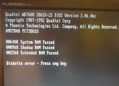

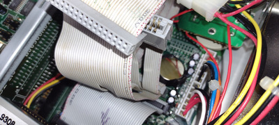

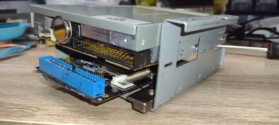

Hi all, I'm back again with a new problem. As per my earlier posts my Mega PC seems to turn on ok, but at that stage I hadn't tried the HDD or floppy drives. I have now tried to boot from both the floppy drive and HDD and I get the same "diskette error" whatever I do (see photo).
I am testing the original floppy and HDD and another floppy drive I have with unfortunately no success in booting from any of them if they are installed in the Mega PC.
However I know that the floppy drives and HDD (and ide cables) work fine as I can boot from all of them if I put them into a different pc.
I have the bios set by restoring defaults and then enabling the fixed disk as type 17 as per the instructions label so I think everything here should be working fine. The floppy drive and fixed disk controller are both shown as active in the bios.
Does anyone have any ideas as to what could be wrong? Is this some sort of drive controller issue?
Thanks
Hm this reminds me some errors I have in some later systems when I enable the "system BIOS cacheable" option.
Try turning off all cache & shadowing associated settings - I don't remember if there are any in MegaPC though
Hi! Are the IDE/floppy interfaces the original ones?
I'm asking, because I vaguely remember some issues with the RDY signal line on older PCs.
Some mult-i/o cards with both IDE/floppy had fixes installed to solve the problem.
However, if two separate cards are used or one card and one on-board connector, the issue may show up.
"The main problem in a PC seems to be how to keep the harddisk interface and the floppy interface from colliding on some register addresses.
If the IDE interface is implemented based on some controller system this is of course no problem."
Source: https://www.pjrc.com/tech/8051/ide/wesley.html
Here's a bit more info about RDY, also, or more precisely, DC/RDY (Disk Change/Ready).
The signal seems to be combined on PCs.
https://www.hermannseib.com/english/synths/ppg/wtfloppy.htm
Best regards,
Jo22
Edit: These are just some thoughts. Perhaps the problem is an entirely different one.
that looks to me some trace issue if the floppy is defined correctly in BIOS
also make SURE that the stock cable is connected correctly, in both orientation and which end goes where
there is a key in one end of the cable (I mean a filled hole) that goes to the motherboard pins
but you can make the mistake of using this end on the floppy drive and damage one of it's pins that is actually the disk detect signal IIRC so it can lead into this exact problem
