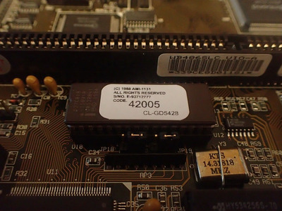

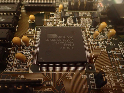

So a progress update - the chip is in...

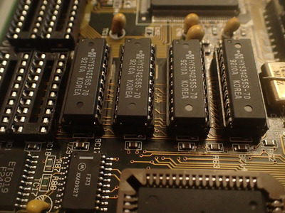

All the Video RAM is socketed !
302.17 KiB
1861 views

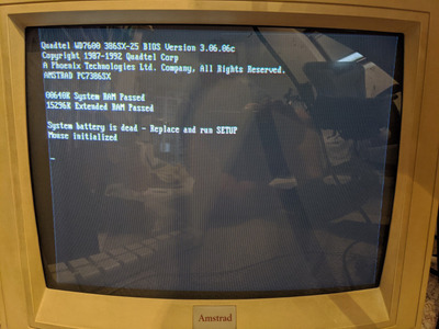

And new BIOS is installed - a BIG thanks to Keropi for making this !
265.69 KiB
1861 views

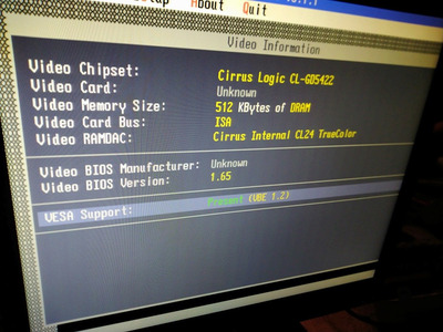

All boots fine, but when I run the test - its this result ?!?
206.62 KiB
1861 views
So what's going on here....??? We'll after some careful analysis it appears that I have picked up a geninue "fraud" chip from the 90's (!) - someone relabelled a batch of 5422 core and passed it off as a 5428's. Fortunately the seller is a reputable one, who once notified of this has withdrawn the chips and has refunded my cash (not that it was expensive) - but folks trying this in the future should perhaps use a chip from a known good graphics card in th future like Keropi did, to avoid this happening. Still, I'm not annoyed the chip change has fixed the memory issue (as in the picture now accessing all 512KB of the ram in there) so I can expand the RAM, plus the 5422 is faster, has 32bit memory access and more powerful than the 5420 so I really haven't lost out, and its only cost me the cost of the chip install which wasn't too bad. All in all fairly happy and will follow the mantra if it 'aint broke, don't fix it - so will live with this for now 😀
